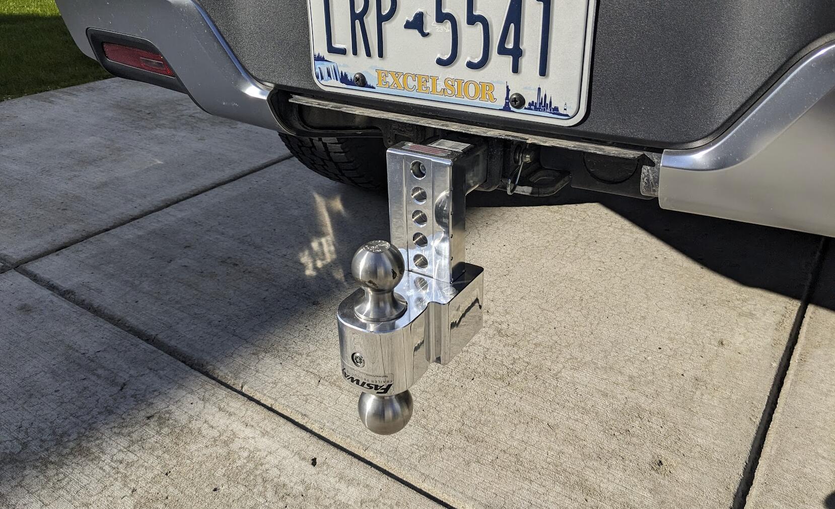

I bought a purposeful "anti-rattle" hitch setup. It appears to be of good quality and is similar to most other "drop hitches" on the market. Here's the hitch I'm running: https://www.fastwaytrailer.com/products/flash-silent-ball-mount/
Here's what it looks like in the truck:
Rivian R1T R1S First real tow with Rivian - Generally underwhelming experience 1751377218246-dz
It is significantly more drop than I've run on any other vehicle in the past. However, given the geometry of the truck and the trailer I'm not sure what kind of options I might have there. Trailer needs to be level, and the truck is tall.
Truck and trailer look to both be about as "level" as I think I can get them.
Rivian R1T R1S First real tow with Rivian - Generally underwhelming experience 1751377421118-02
Here's the weights from when I scaled the Audi with this setup. I'm around 11% tongue weight, which is a shade light by RV standards, but about right for boats in my experience.
I'm open to other options, as I'm not completely enamored with this hitch setup.

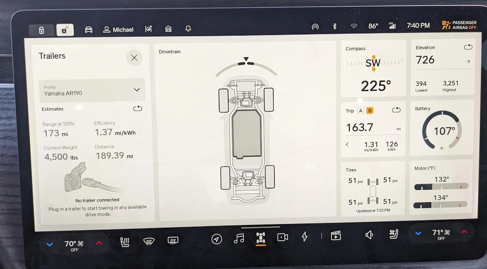

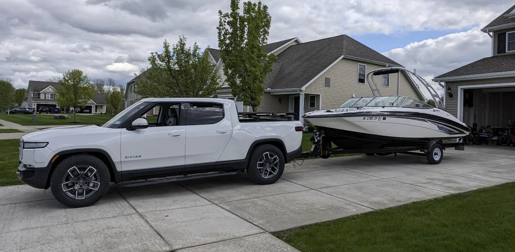

We've had our Rivian since late Sept last year. Only had a few chances to tow our boat until last weekend aside from some quick trips to take it to and retrieve it from storage. Finally had a chance to actually use the boat, so we towed it to our favored local lake and back. Results weren't nearly as grand as I had hoped.

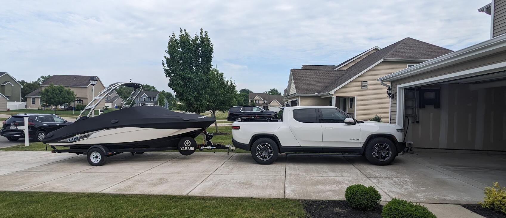

I'll start with a little backstory. We've had this '17 Yamaha AR190 since April of '17, and have towed it all over the eastern part of the US. When we bought it I had a Trailblazer SS. 400hp/400ft-lb 6.0L Midsized SUV. Traded that for a '15 GMC Sierra 1500 SLT. Traded that for a '17 Audi Q7 Prestige. All of those served as "official tow vehicles" for the Yamaha. Also used my wifes car a few times when she had a '10 Chevy Traverse. Before this, we had a '98 Rinker 182 that I towed with everything from a 4dr S10, to a GMC Yukon, to that same Traverse. The Q7 was traded for the Rivian, and the Audi was the best tow vehicle yet. By a large margin. It has plenty of power, a great chassis and phenomenal brakes. This boat weighs right at 3,200lbs loaded and ready for the lake, as verified on CAT scales a few summers ago. Boat does NOT have brakes on the trailer, as it's under the 3,500 limit most states have. So it's not like it's a super heavy or even difficult item to pull. Our Rivian is a '24 dual motor (non-performance), with the large (131kWh) battery. Has the factory 20in AT wheel/tire package.
Here's a picture of the setup. It does look really sharp with the white/black matching across the boat/truck.
We also recently moved to Buffalo from southern Indiana. MOST of our tows are relatively short distances (under 200mi), however once a year we typically take the boat somewhere "far away". Last year we towed from Buffalo to St. Augustine. Year before it was Destin, FL. Few years before that it was Douglas Lake , TN. I would wager we've got well over 20k miles of towing between the two boats. That's all laid out just to give some context to where I'm coming from, and what I'm comparing to as I move through this "review" style post.

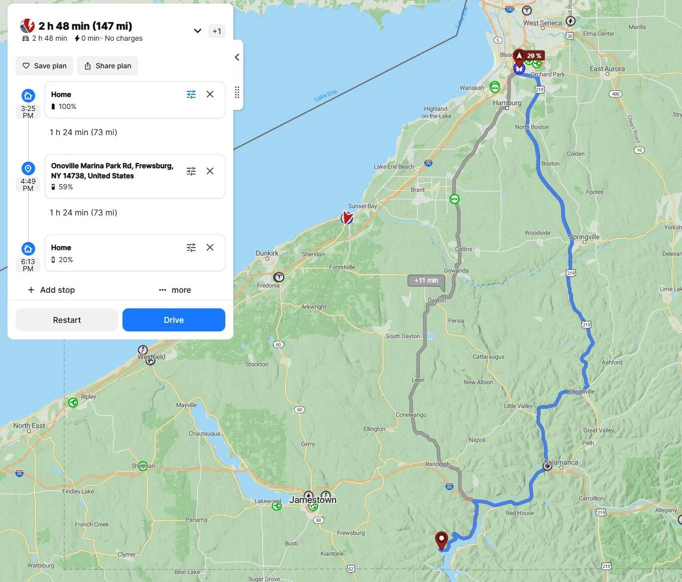

This trip we went from the southtowns of Buffalo (Orchard Park area) to Alleghany Reservoir on the PA/NY state line. Notably launching from the Onoville park ramp in NY. This is about 147mi according to ABRP, although I think Rivian Nav took us a slightly different path. I pre planned the trip assuming a departure of 100%, and a usage of 1.3mi/kWh (based on some towing research and other Yamaha owners reports). This route takes us "up" from the Erie lake shore of about 650ft asl and "over" the ridge just to the east that peaks at ~1,800ft asl. Then back down slightly to the lake. I knew we were going to burn up some range on that first part coming out of Buffalo from the elevation, but we also had a terrible wind out of the southwest, so that didn't help either.

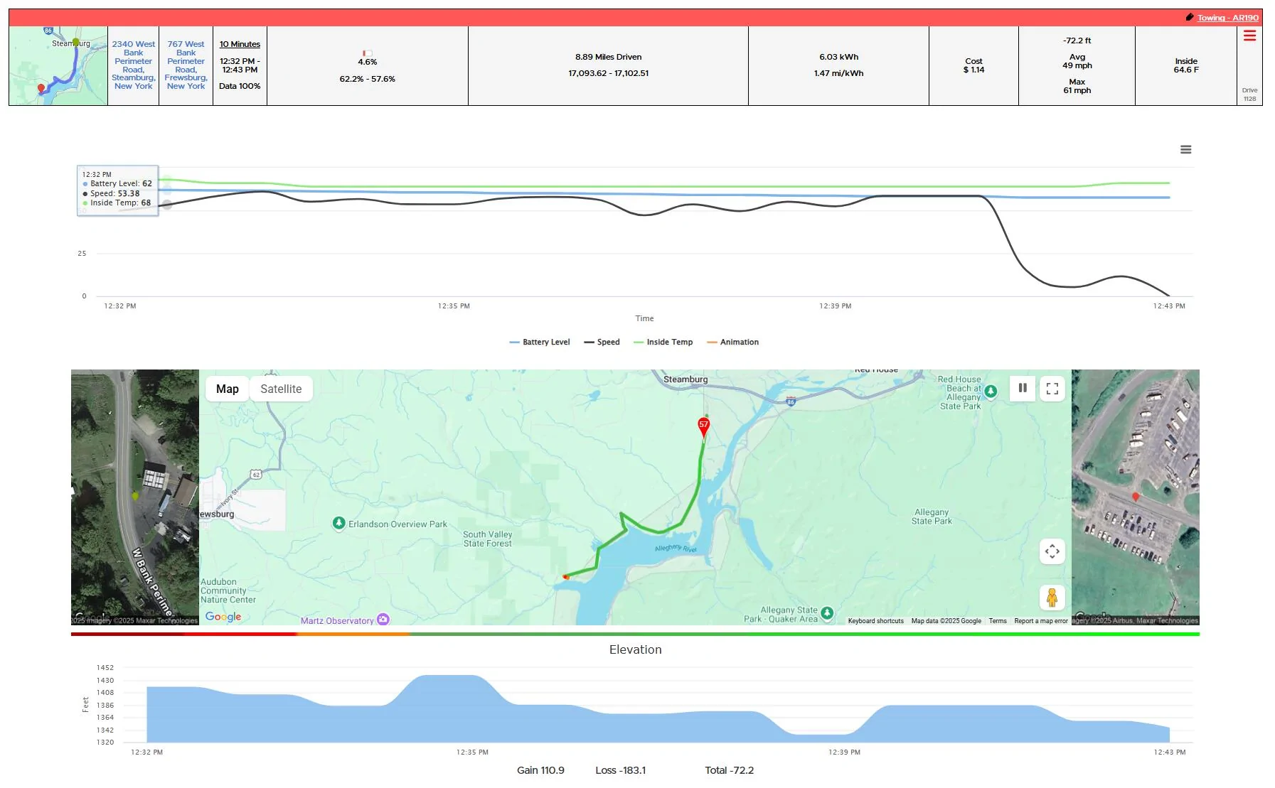

That route looks like this:
Overall, the trip was pretty uneventful. Arrived at the marina with 56% SoC, so I figured we could make it back without charging. I had some planned detours should we need to get energy, but they would have added an easy 50mi to the trip as compared to what Rivian mapped us. There are fast chargers in Salamanca had we needed them. After a day of boating, we decided to just push straight home, and made it there with 20% SoC just as ABRP predicted. The elevation helped on the way back in, and so did the tail wind. Used 44% on the way there and 36% to get home.

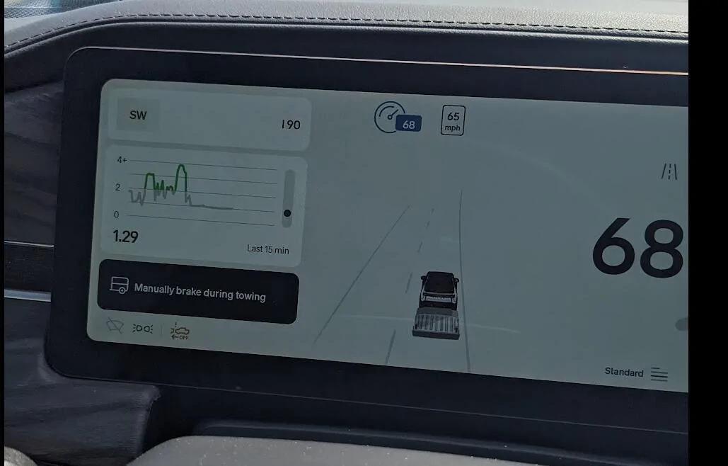

Here's what the trucks trip meter read when we got home. My 1.3 guestimate appears to be spot on for this "mixed use" trip. I'm certain it will go down if I stayed on the interstate completely. Lots of backroads along this route that helped keep the speed down. I'm sure the tower on the boat doesn't do the aero any favors. I'll probably pull the bimini top off the tower for the next trip. Sound bar is permanently mounted though, so nothing I can do there.
The experience of towing overall though.......was a little underwhelming. I've read many threads here about how the electric drivetrain is a game changer, and I would completely forget about some of my small complaints once I pulled the first hill......well, none of that really materialized, and was largely overshadowed by missing features and constant nagging of warning and range anxiety.
The bad stuff first I suppose; Most notably, no adaptive cruise and the constant warning from the dash "Manual Braking While Towing" were constant reminders of missing features. No adaptive cruise is a big disappointment here, especially on our longer towing trips. We had this on the Q7, and it worked great. I'm sure I don't have to explain the benefits here, and I'm really sad the Rivian doesn't have that tech built in. I mean, they figured out how to "weigh" the trailer (albeit it's 1k lbs over what it really weighs), but they can't figure out how to do ACC while towing. This is a big miss. The constant "manual braking" warning is absurd as well. I get that they want you to know that normal ACC isn't activated, but I think the GIANT icon at the top pretty well represents that something is different from normal. I just don't get the lack of this feature.

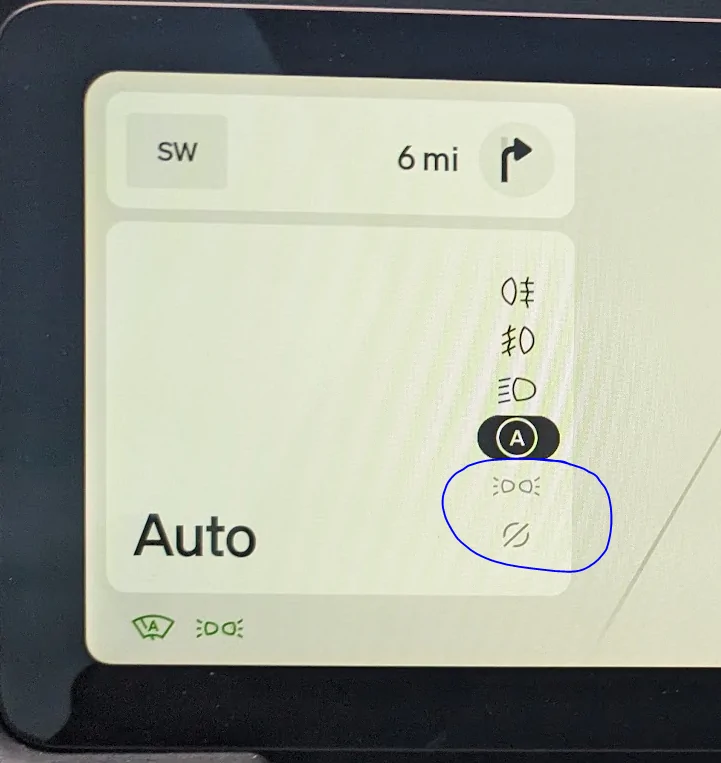

Another slight nit pick here.....I couldn't turn the parking lights off. Those options on the light selection area are "greyed out". If the trailer is connected, the trailer lights are on. Period. I have no control over that. Doesn't really hurt anything I suppose, but just seems silly that I can't turn those off. No idea why that is.
I somewhat think it's a bug, because I noticed the other day I couldn't turn them off when driving without the trailer. I spend one day a week in Canada, and I think the daytime running lights requirement over there might be "stuck" in the enabled position. Truck automagically swaps to kph, and metric distances in the Nav when I cross the border, wondering if this change happens as well, but it never went back.

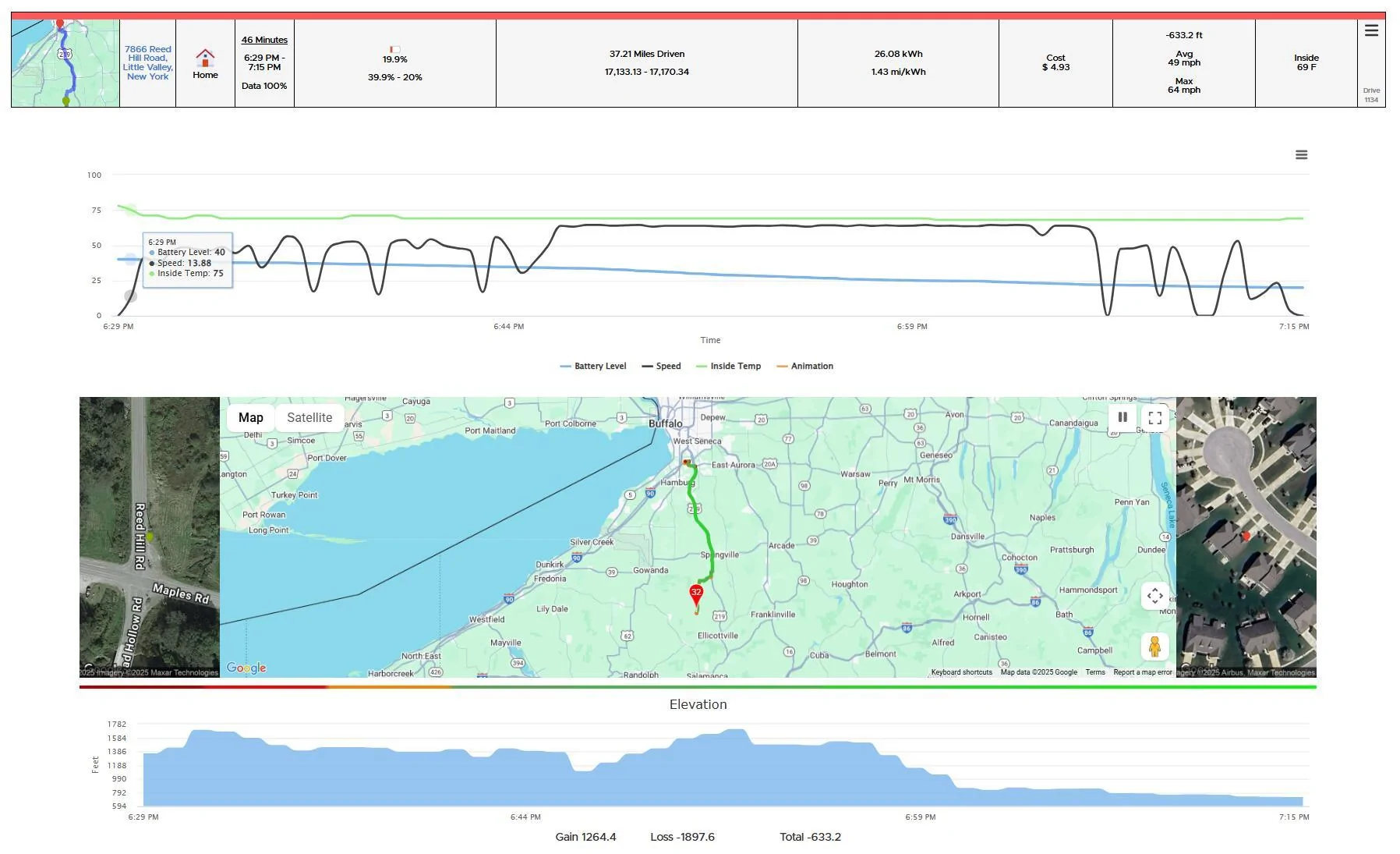

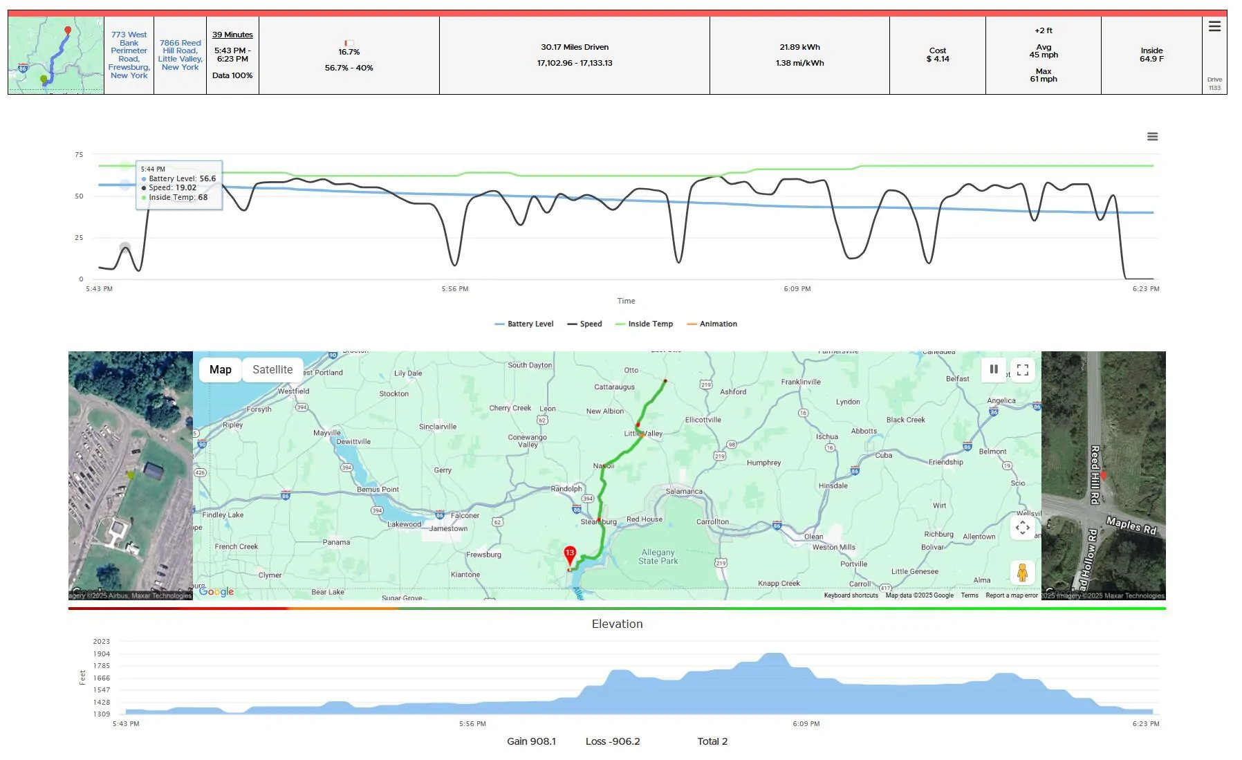

Very detailed. I have to agree with you about the adaptive cruise control when towing. That doesn't make sense not to have it, even when I used my Tesla Model Y for towing I was able to use adaptive cruise control and autopilot. In my opinion it made the trip much easier and much safer.

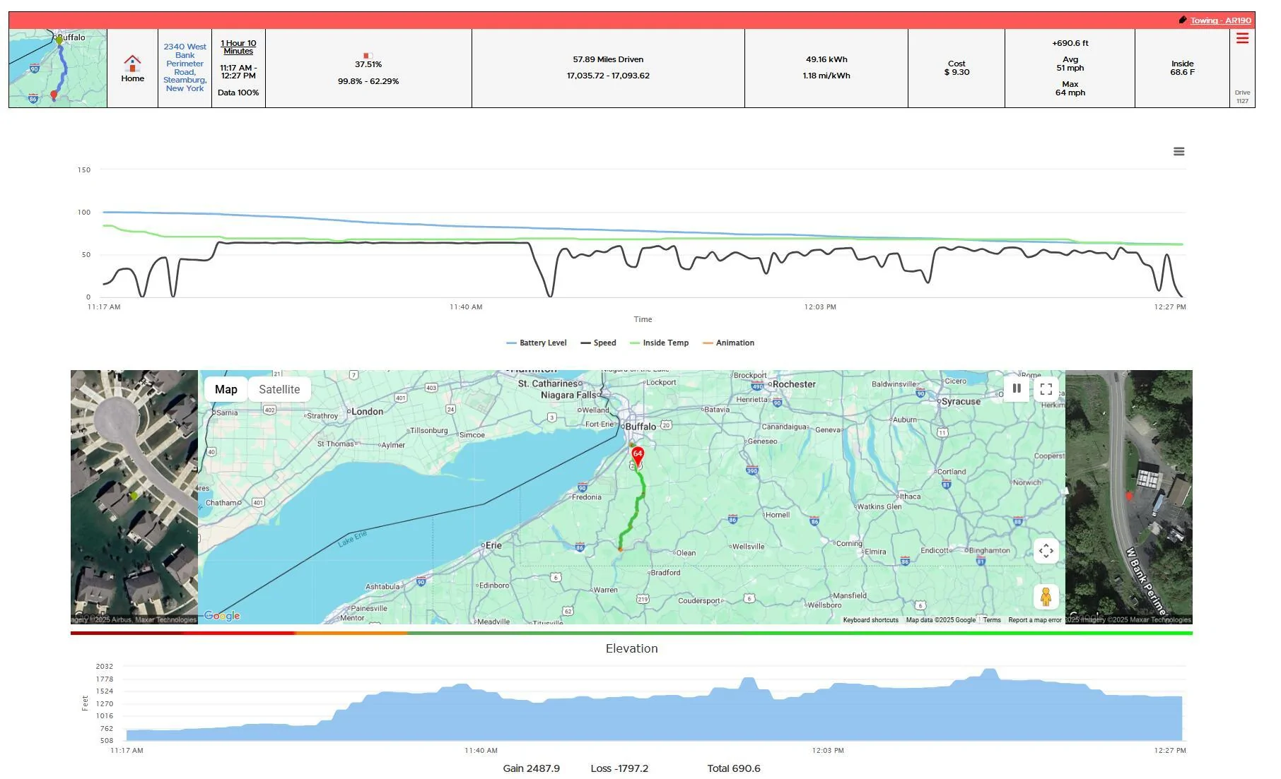

Here's the ElectraFi data for anyone interested.
First leg down (stopped for ice):
Second leg (short into the marina):
First leg home (we stopped for Ice Cream by the side of the road)
Final leg home.

I thought that might be the case as well. This trailer hasn't exhibited this behavior on any of the other vehicles I've used in the past. The truck and the hitch are both new to the setup.
It is definitely weird that you felt porpoising like that. I agree with you that your weight and levelness look spot on. Unfortunately I don't have any suggestions to fix that.
Your trailer doesn't have a hydraulic surge on the tongue, does it?

No brakes at all on the trailer. Also checked the swing away tongue connection. All feels well there.
Might have just been the roadway, but the fore/aft leads me to feel like a poorly calibrated cruise control causing it.
