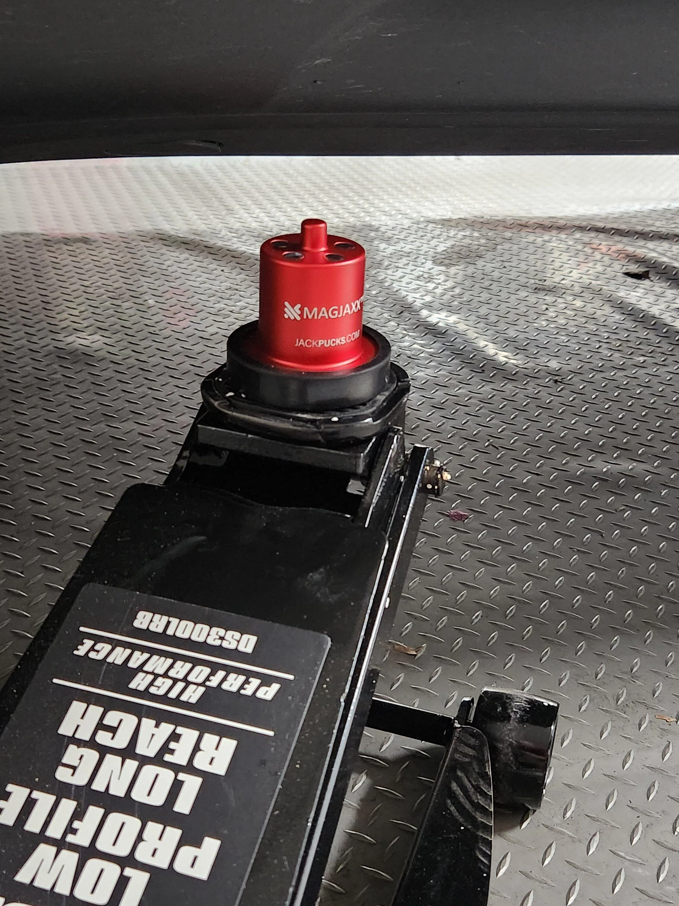

I rotate myself, as I just enjoy it. I can do it in 25 minutes with our jack pucks and a couple of floor jacks, coupled with two jack stands. It's therapy for me.
I'm a bit dense, but can you help me understand where you place the jack stands to support? Surely, you can't use them as pictured with the pucks on top since you need to use that as the jacking point? My jack stands are not flat on top like yours and I can't figure out a good place for them to take the weight unless I remove the plastic panels underneath.
I use the 25" lift floor jacks on the drivers front and the passenger rear and the two flat top jack stands on the other two positions with our pucks. The two floor jacks lift the entire vehicle off the ground.
I’m with ya regarding your question-I use my Jackpucks and a 3 Ton Daytona Harbor Freight floor jack, all terrain at max height and do one tire at a time( 5 tire rotation). I have bottle jacks but they are less than stable at the Rivian suggested tire change height stated above. Running 20’s.
