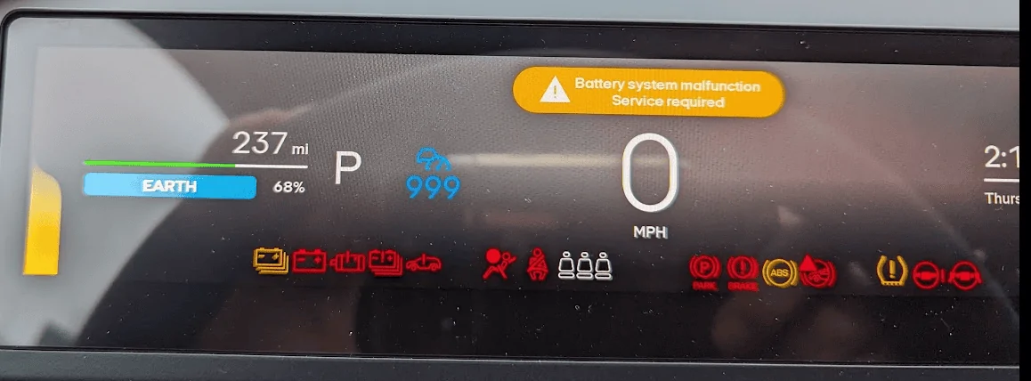

IMO support is likely overworked because of the amount of software issues. Most of them can't truly be fixed without software updates (my camera happened to work just fine on my lunch break where it didn't work this morning). I think they are probably having issues sifting through tickets that they can't do anything about versus ones they can. But they do seem to prioritizing things that make the vehicles undrivable. If someone experiences a repeated "permanent" hard failure, it's time to put a ticket in. Otherwise you're wasting your time. I'll admit I am much more forgiving than the average consumer really should be here, but I also don't like shouting at brick walls either.
I didn't have issues getting my vehicle serviced when I had an issue, but I pushed on them because it was basically undrivable. Low battery coolant caused it to go into a limp mode that was barely adequate to get the vehicle off the road. Tech said I wasn't the first person he'd dealt with that had the issue. Several others have had a similar problem that was the result of a bad pump instead of bubbles in the battery from manufacturing. Could get about 30 seconds of driving until it'd fail and basically just coast down. Until getting out of the vehicle, locking, unlocking, and driving again. Of course the car doesn't tell you what's actually wrong. (ignore all the telltales, most of them were just there because of the power-on-self-test, but the error message was real)
Rivian R1T R1S Fisker Ocean review: ouch 1708363361043
I drove back to work and let the vehicle sit in the parking lot. Arranged service and took an uber home. Tech was out that same week and drove the vehicle back to my house after "fixing" it. The issue hasn't returned but I've got the tools to get under the hood (stupid design decision, Henrik), and the coolant to top it off again if needed. Fun fact about my Tech, he came from Rivian and said he vastly prefers working for Fisker. I didn't ask him to elaborate.
