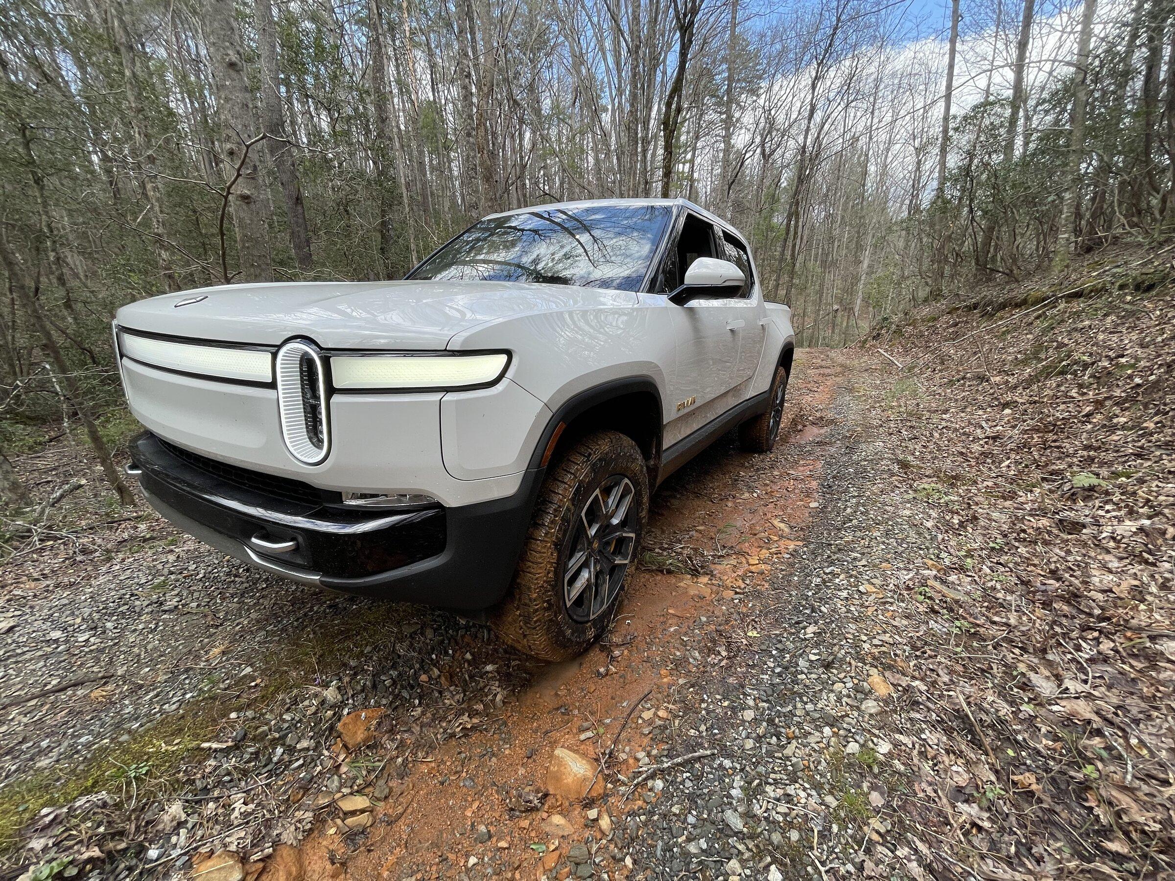

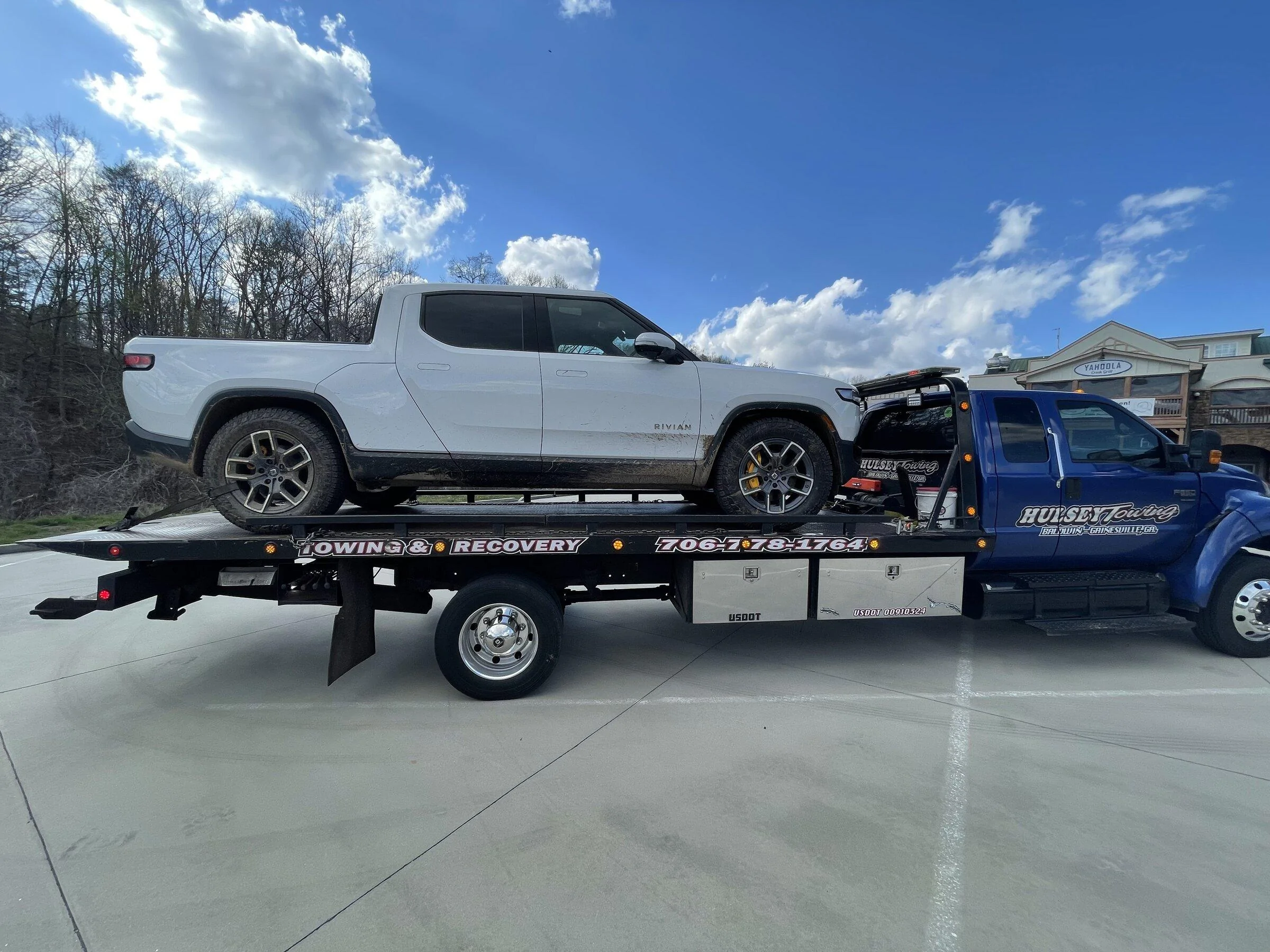

As the title says, I had a front drive unit failure at 40 miles. I had driven the truck about 5 miles and my wife probably 10 miles. Fortunately, it died in the driveway and not on the road because it was DRT. After almost 3 weeks, I’ll be getting it back tomorrow.

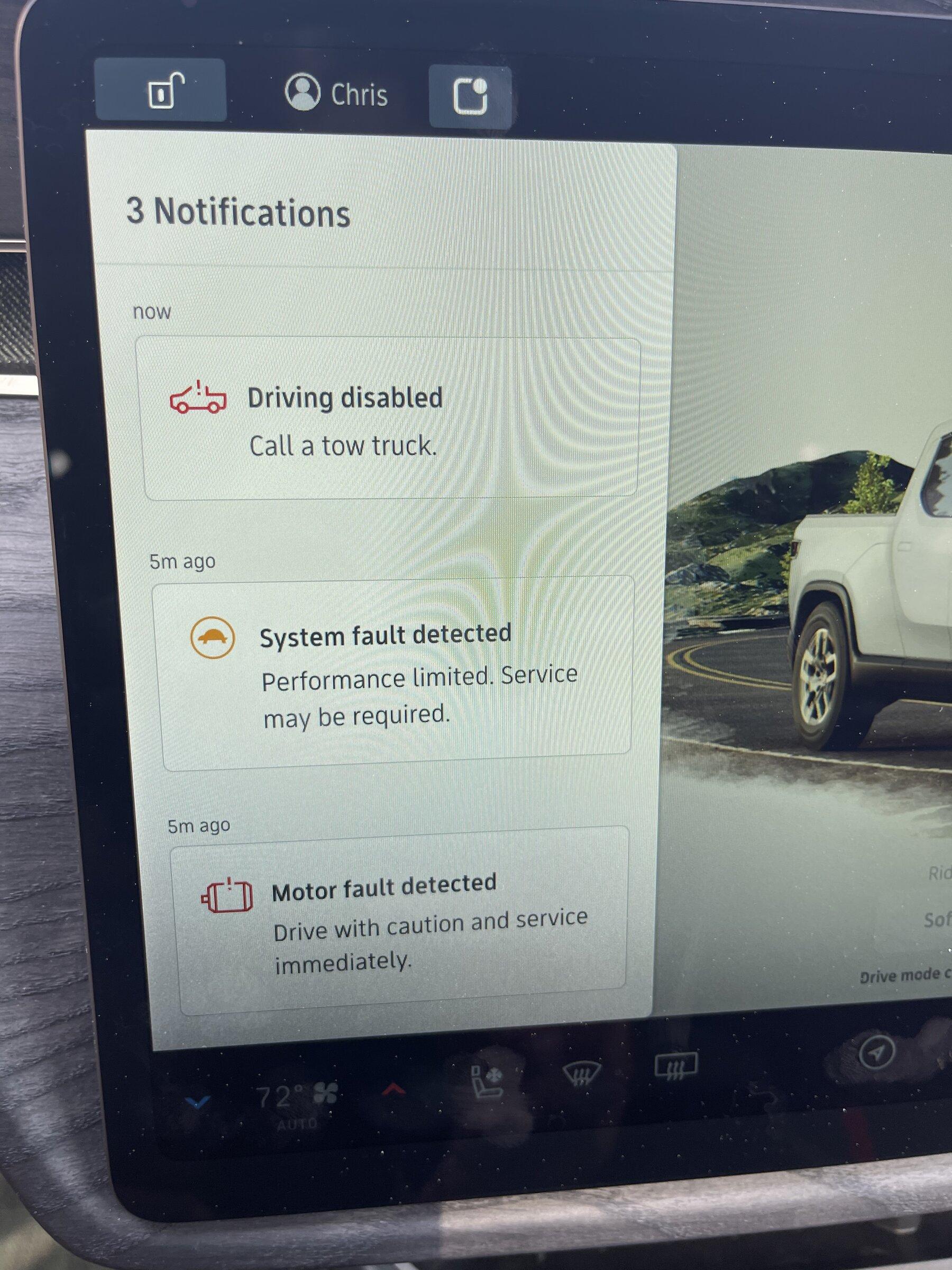

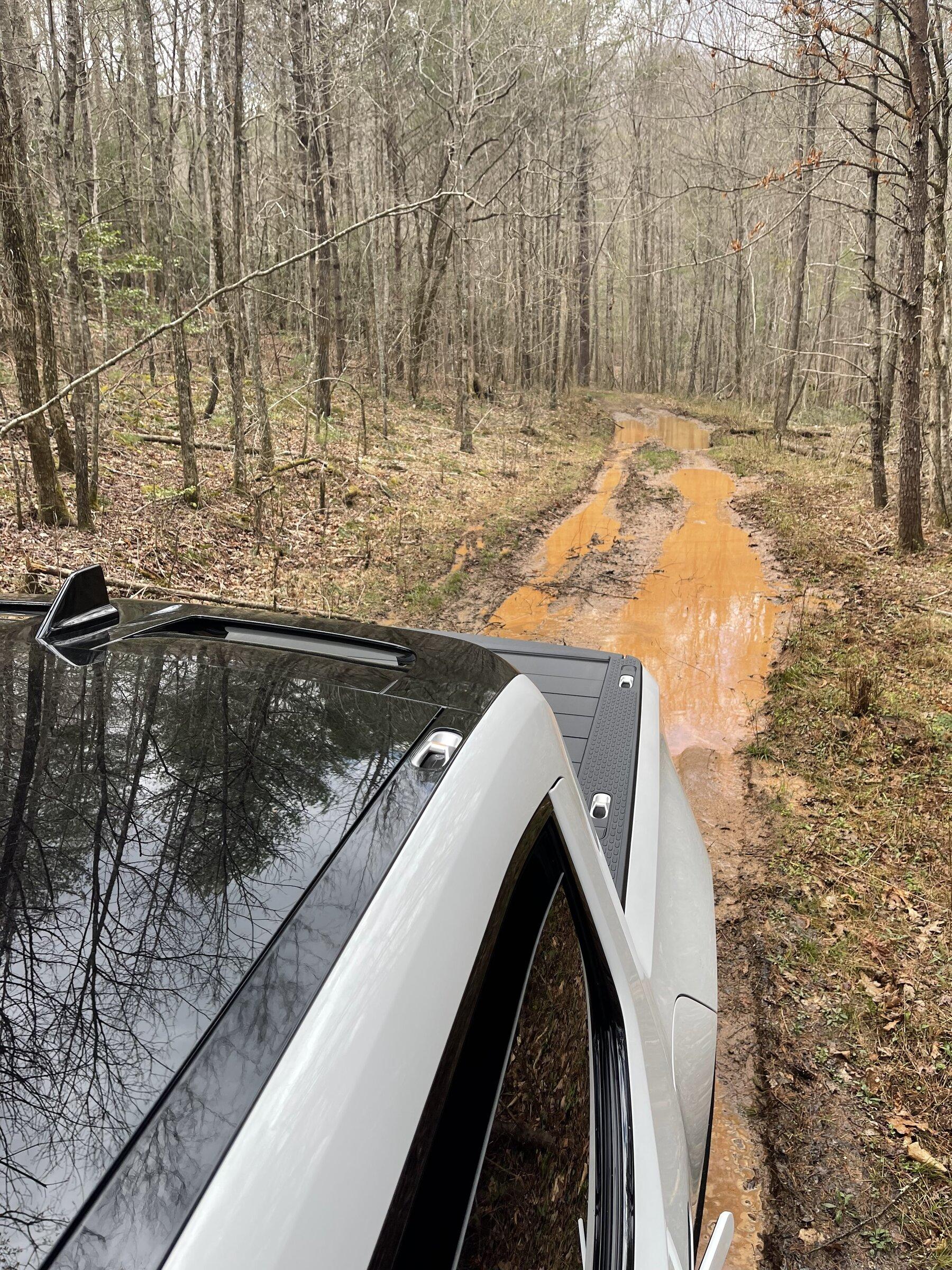

I had the exact same issue with under 100 miles. Took it off-road on day one, lifted the right front off the ground in off road mode at one crossing. I left the dirt and went into sport mode on a paved road for about 4 miles before stopping at a stop sign. When I pulled out I heard a pop in the front and got both the motor fault and the system fault notifications. The truck entered limp mode (top speed 42 mph, very sluggish) for another 2 miles before telling me to pull over and have it towed. After putting in park, it would not go back into drive or reverse unless I performed a hard reset. Flatbed ride to my service center, 2 days to remote diagnose, 5 more business days to trailer it to another service center with a lift to replace the drive unit. I was given a loaner R1T which I named the RESV (Riven Emotional Support Vehicle). I have mine back now and it seems fine, but makes me a bit nervous to try solo off-road any time soon.

And we still don't know specifically what is failing except that they are replacing the front drive unit?

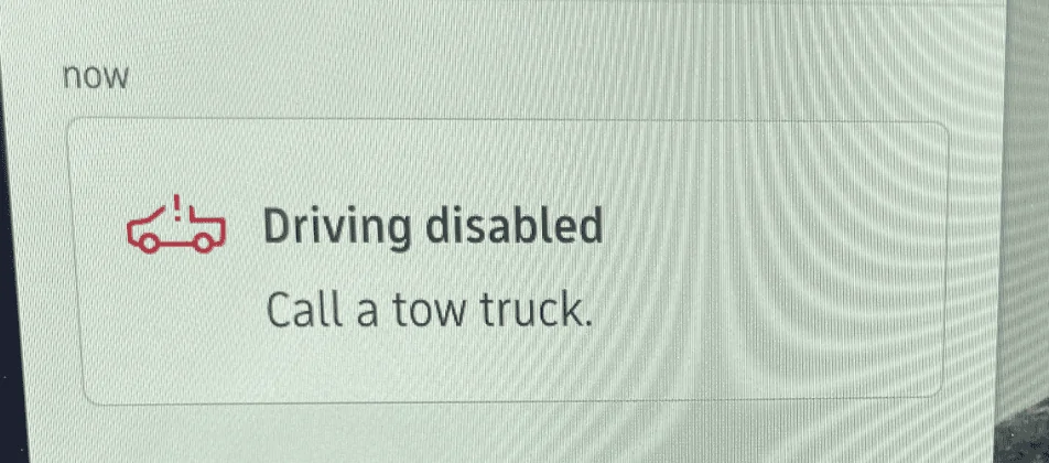

Whoever designed this message needs to put more thought into it:
Rivian R1T R1S Front drive unit failure at 40 miles 1650379564924
This message should basically never happen. Before the truck declares itself dead, it should have offered at least a couple of debug options, the computer should have called home for remote support, the car should offer to call SOS or tech support, then step the driver through a couple of reboots, and ultimately a menu on the touchscreen and a known sequence to force the vehicle to go into drive with whatever it's got and get moving (e.g. foot on brake, hold sos button and hazard button and select Drive five times … if the touchscreen is malfunctioning, you can't rely upon it, so a "with extreme prejudice, just get moving" function must exist.)

I Just had a similar problem. Started couple days after I got it. Mine could limp home with very little power and not go over 42mph. Then sometimes it was fine. It happened 5 times in the first week. It got towed off and determined it was a front drive unit that I am waiting for them to replace. Wish they would put in the new 300hp motors. ?

With four motors, I expected software to allow the vehicle to continue with three dead motors and for there to be a dialog on the touch screen showing the fault and allowing the driver to drive the vehicle … "I'm in death valley, no phone signal, just keep going" sort of thing.
The vehicle is owned by the owner, not by the factory. While the factory wants to protect its warranty costs, or continue to debug it's new product as a beta in the hands of the early adopter customers, the owner has the prerogative to keep going even if the "low oil" light might result in further damage or failure … it must be the decision of the driver in control of the vehicle at the time, not the business interests of the corporation.
Yeah you must be new to this whole "EV" company thing, none of them want your car to treat you like you own it.
It would absolutely improve the product to make it capable of running with a motor down but as it stands it seems like we just have 4 points of failure instead of one or two. Hopefully this isn't a common thing.
