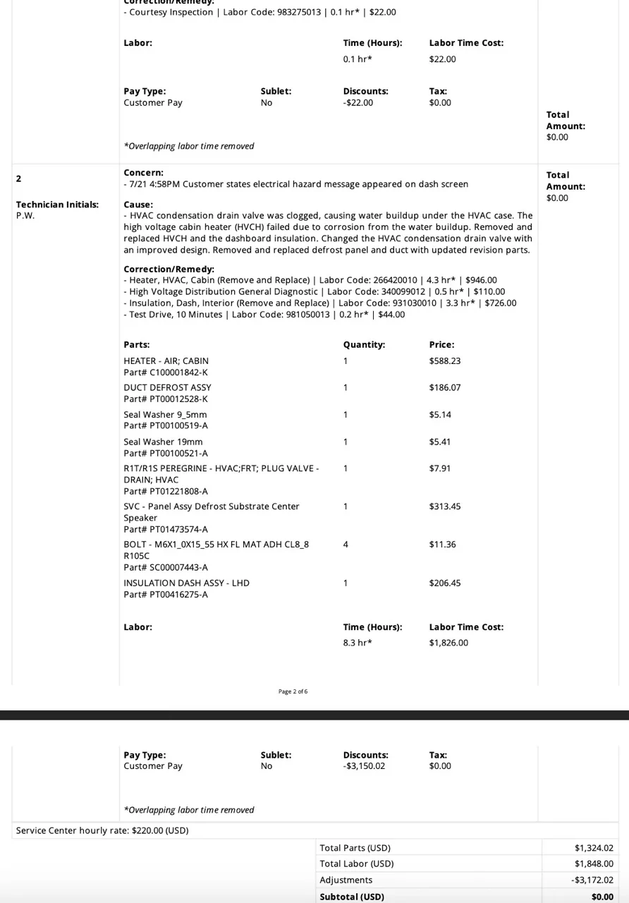

I believe the campaign goal is to catch it before it get's to the level you have hazard lights on your dash.
Here is an example where member @1stPlace had electrical hazard message appeared on their dash screen. The fix as seen below was to replace the HVAC.
PSA: Make Sure to Check Your Driver Side Mats and Passenger Side Mats for Moisture after HVAC drain Plug Campaign RCA-26-24-002-1
Rivian R1T R1S Fun "Critical Battery Issue" on vacation 1758398322436-mv
I just posted in the other thread about this... here was my work order.

It is possible this issue could reappear again even after the service center installed an "updated design" in my vehicle. I'm not cynical--I just want to be prepared. The original chilewich mats that came with the R1S are nice, but they are not waterproof and it is easy to place blame of wet carpet on that. I am thinking of just using the all-weather mat in the drivers side from now on and doing spot checks for any wet carpet underneath once a month during the warm seasons.
