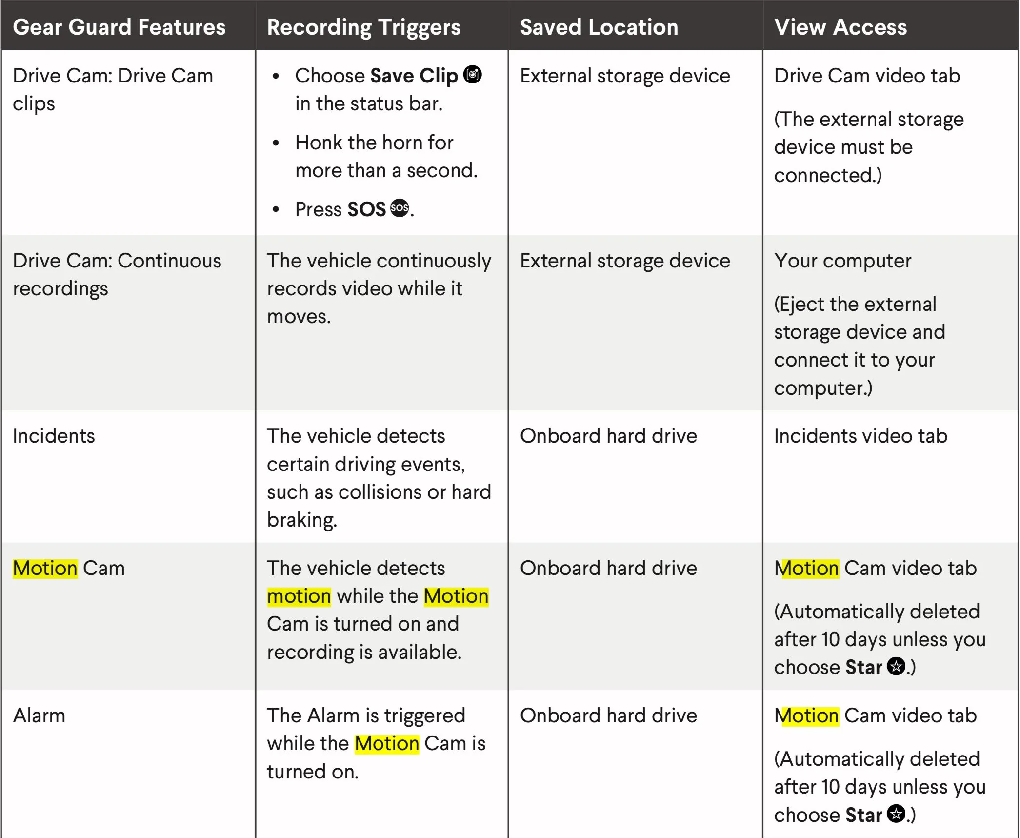

For the motion events, it records to internal hard drive? How much internal storage does Rivian have onboard? So how much of motion cam is recorded before it has to delete over?
I grabbed this from the owners manual. I hope this helps.
Rivian R1T R1S Gear guard always on IMG_0703

Thank you for pointing these features out. I have been somewhat confused about this from the beginning.
