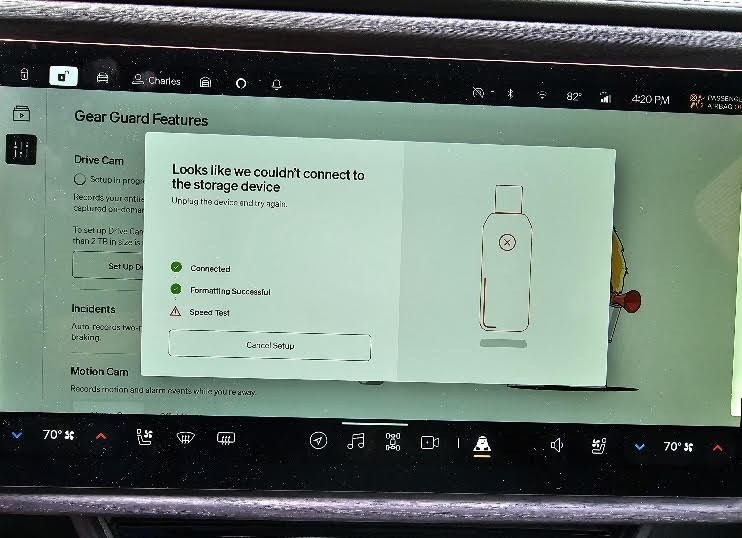

I finally got around to getting a flash drive for the Gear Guard. Based on the recommendations of several forum members, I bought a Samsung 256 Mb drive with 400 MB/s transfer speed. While the Rivian recognized the drive and formatted it, the drive fails to pass the speed test, so can't connect:
Rivian R1T R1S Gear Guard / Drive Cam questions Screenshot GG
Is there anything I can do to get this flash drive to work, or is 400MB/s simply too slow and I need to get something faster?
Try formatting in a Windows PC as exFAT. Then put in Rivian and try again. I highly recommend an SSD for DriveCam though. Its constantly recording a a video stream and member sticks/flash memory don't do as well with a lot of writes.
I use the crucial X6 SSD. https://amzn.to/47VZdHv
Harvey Mushman
Jul 23, 2024
Bloomfield Hills, Michigan
2024 R1T
Bottle Washer
I just ran into this as well with a Samsung T7 drive. Got through formatting but consistently failed the speed test. Do a soft reset of the infotainment system with the drive connected, then do the setup process. Worked for me first time.

Thanks for the responses. The drive is the same one as @SwampNut references and I'm pretty sure is genuine Samsung. I will try a soft reset and see what happens.

I had that same exact Samsung USBC flash drive work up until last update. I was hoping THIS update would correct it. I also tried a SanDisk rated USB-C 3.2 with even higher transfer speeds.
Mobile service came out and verified all of my hardware was working, updated to (at the time, latest software--there was a .6 update he pushed even though we weren't too hopeful--and it didn't help), and ran benchmarks on the 2 flash drives I was using using his laptop, which he said were testing fine.
A forum member, @TollKeeper recommended this SSD drive to me in this thread: https://a.co/d/05g9yHy as he was using it successfully. I had to use a different USBC cable than what it came with, but it's working perfectly since I installed it.

I got the crucial X9 and ran into the same issue with not passing the speed test. I also tried another SD card with the same issue. Have people tried a different wire?
Thanks!
Not sure about the x9 I use the X6. Format it first in my Windows PC with exFAT file system. Then I put it in the Rivian and go through the motions.
Maybe try infotainment reboot if that doesn't work. Far left and far right steering wheel button at the same time until it reboots.
Trayner22
Terrance
Jun 15, 2024
Holly Springs, NC
2022 Rivian R1T QM Adventure w/ 22” Sport Dark
Thank you for the info in this thread. This just worked for me with the 2024.35.0 software + Samsung Flash drive mentioned above on my 22 R1T. After formatting on my PC, I inserted the drive in the center console, rebooted the infotainment and then proceeded to set up drive successfully (again). It was baffling because it has been working fine for the last 3 months and then I took it out to view the contents.
