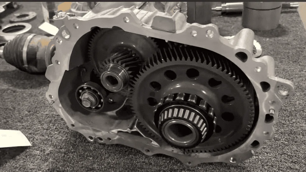

Well, technically, there is a single speed transmission (reduction gear). So even though the motor isn't an issue, you still don't want to shock load the mechanical gears.
Rivian R1T R1S Gear Shifting 1720806813868-nc
