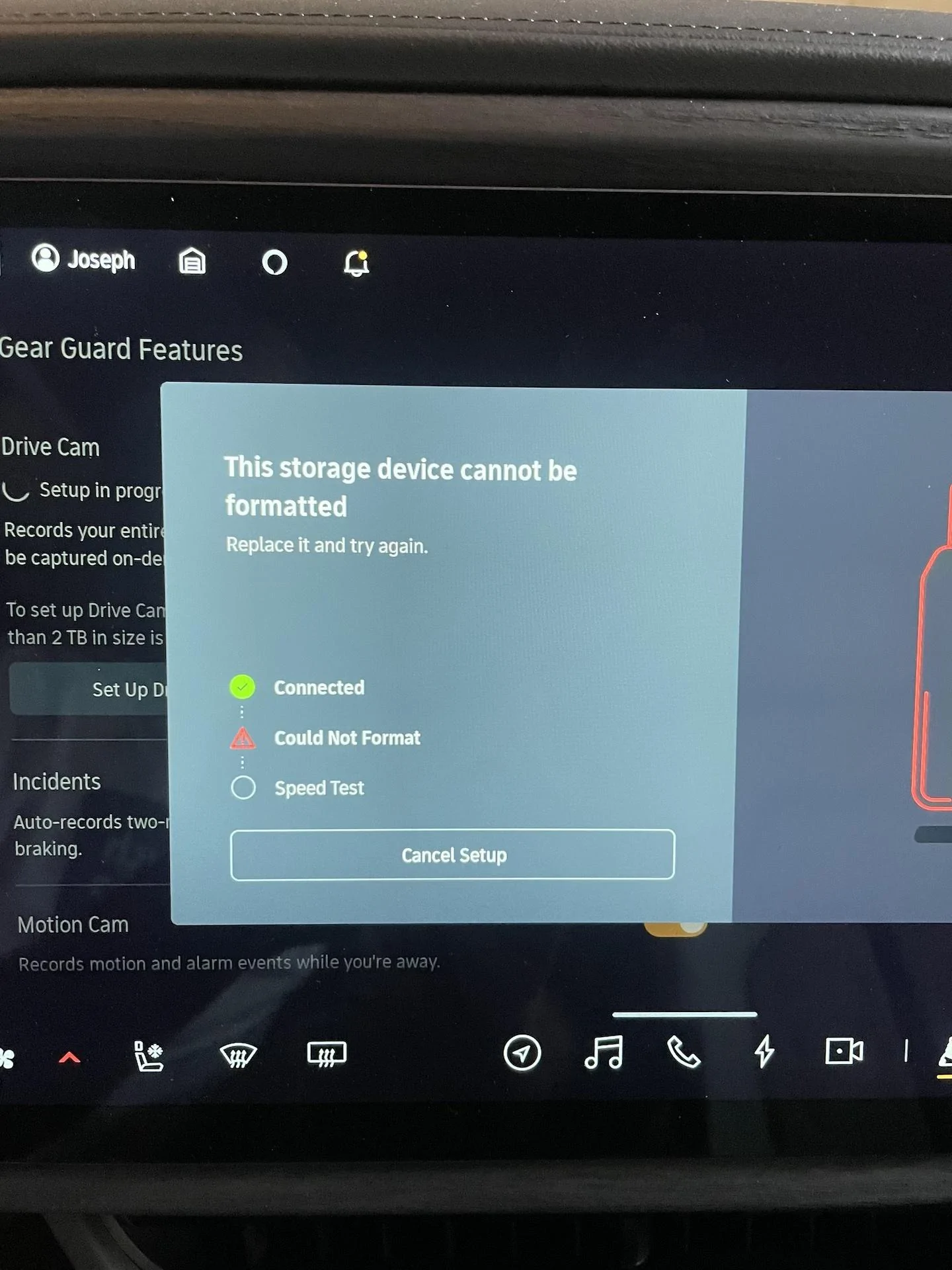

Trying to format a thumbdrive to save gearguard videos but every time I just get a "Unable for Format" error message.
Rivian R1T R1S GearGuard videos to external flash drive -- "Unable for Format" error message Rivian_disk
Yes I have the latest updates.
Flash drive is 2T size, formatted as MSDOS (also tried exFAT).
Anyone every successfully mount a flashdrive in their Rivian?

@godfodder0901 I assume you mean a Software RESET? I'm not familiar with resetting just the infotainment system.
I did a SOFTWARE reset but that did not change the behavior, still will not format the flash drive.
Has anyone been successful in formating a flash drive and using it to save video?

Yes I did the two outer button sequence. The doc refers to this as a SOFTWARE reset.
But i'm still trying to figure out if anyone has successfully formatted and saved video to a flash drive?

what brand & size of thumb drive are you using?
dholt
Jul 20, 2023
Maybe try deleting all the partitions on it first. I pulled a new one out of the box and it worked fine.
