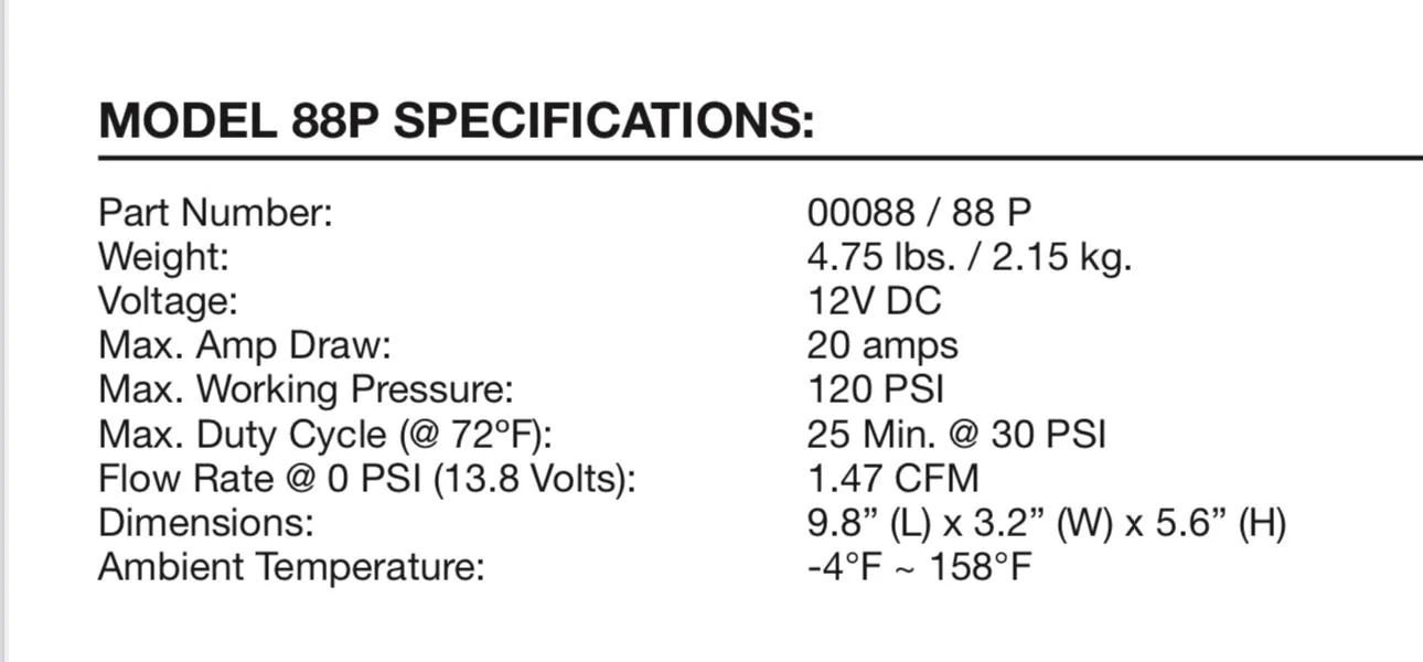

I already have a 12V VAIR compressor (with alligator clips that you connect directly to a traditional 12V car battery). Could I buy a simple 12V socket -> alligator clips adapter and plug the 12V end into the back of the R1S?

The Rivian 12V receptacle circuit has a 10A fuse rating for a max output of 120W (this isn’t very much). Your compressor has an amp draw of 20A.
