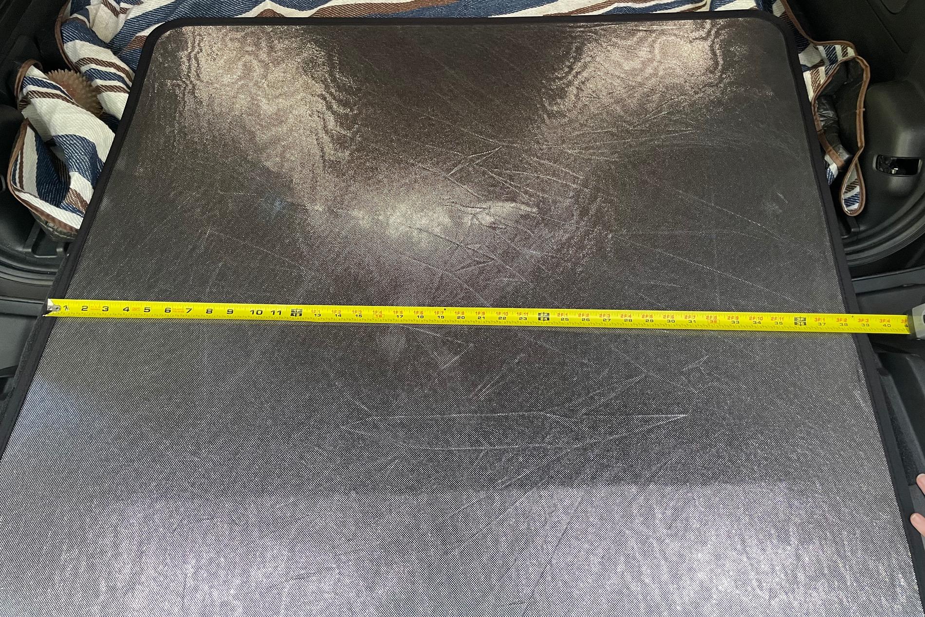

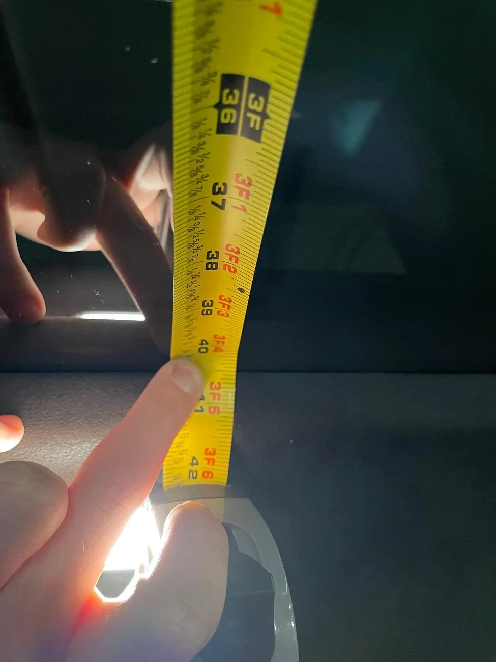

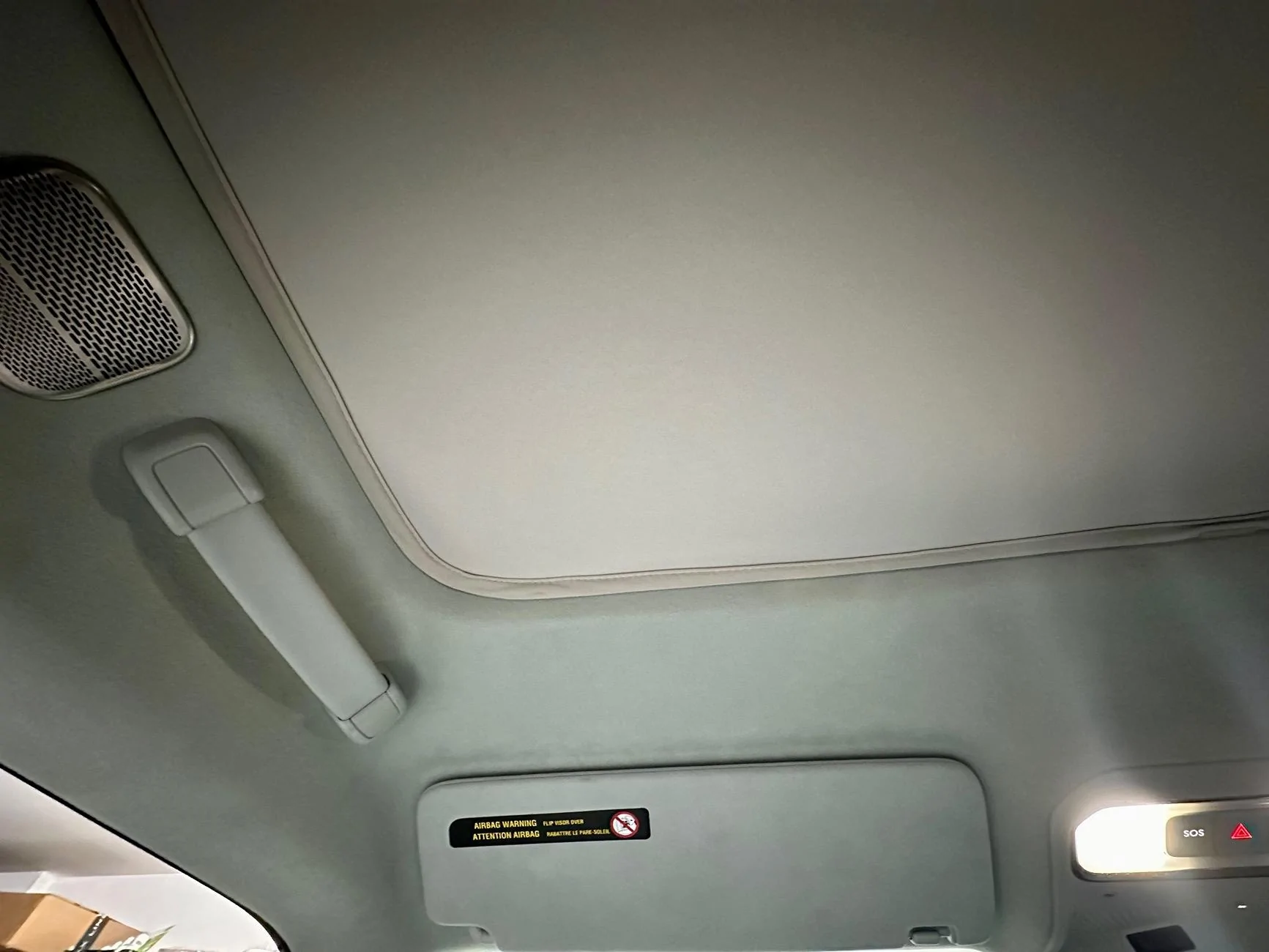

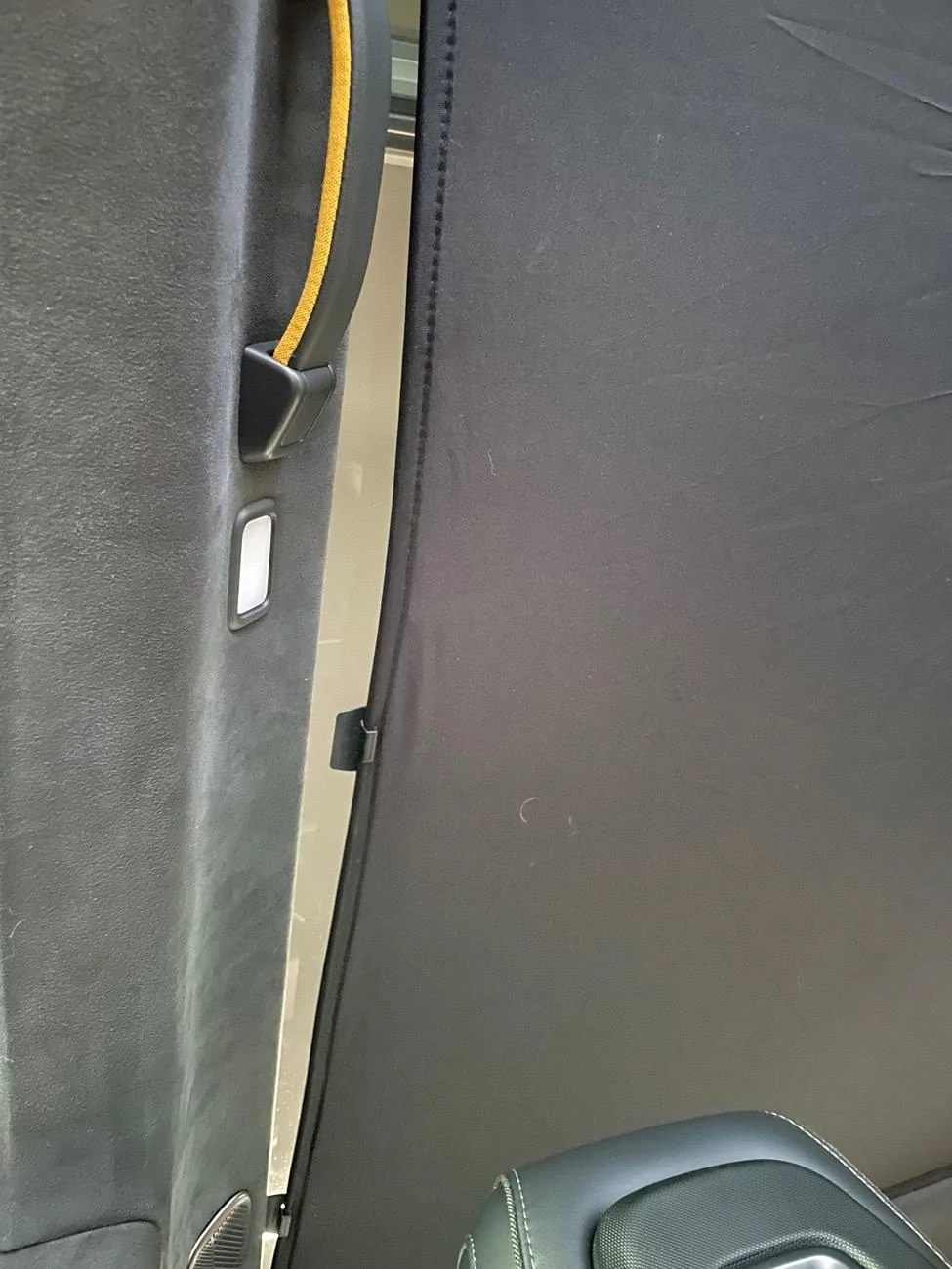

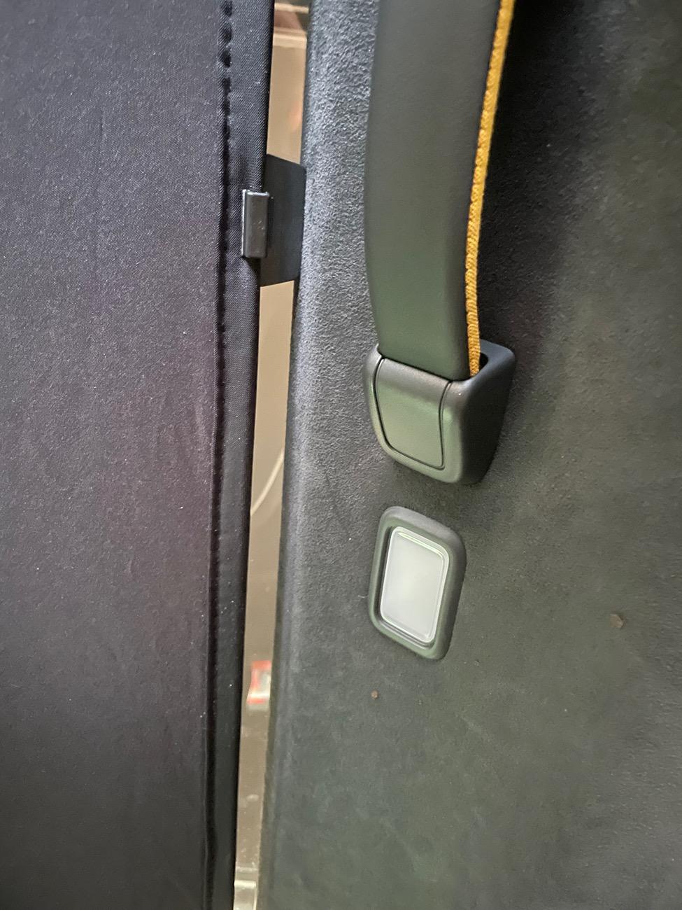

I have the EV Sportline panoramic sunroof shade and I like it a lot. I can set the temperature 1-2 degrees F higher in the car now, since there is less thermal radiation from the sunroof. I also have a Llumar 80 tint on the windshield which helps reduce thermal radiation a lot when I'm driving towards the sun. I'm going to add it to the front side windows soon.
Do you have the shade for the R1S? I just got mine in and it doesn’t appear to be wide enough. I watched the video on their site, tried flipping it 180 degrees, and still had no luck installing it.
I think @EV Sportline may have updated their sunshades with this latest batch because I noticed the reflective barrier is already installed unlike what you see on the videos online
I mean, perhaps it’s user error, but I could not get the sucker to stay in place and after doing a quick measurement it seemed too narrow.

Far from precise measurements on my part so I’m hoping I’m wrong.
You need to rotate it 90degrees or 180 degrees. The roof is not square even though it looks to be. I can tell by the gaps it’s needs rotated. Thx!
Thanks! That’s what I did but when I do it 180 it appears the window by the windshield is too wide and the back of the sunroof too narrow. I turned It 90 degrees and it’s obviously too wide and not long enough. I won’t say it’s not user error, very possible it is, but I tried all directions to no avail. I logged a ticket to get some help (also in ATL if it’s easier to drive by and see what I’m doing wrong)

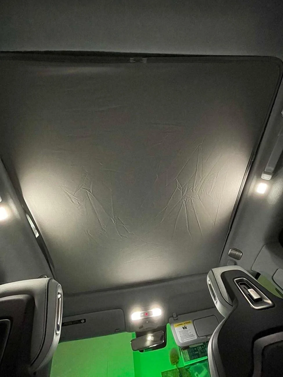

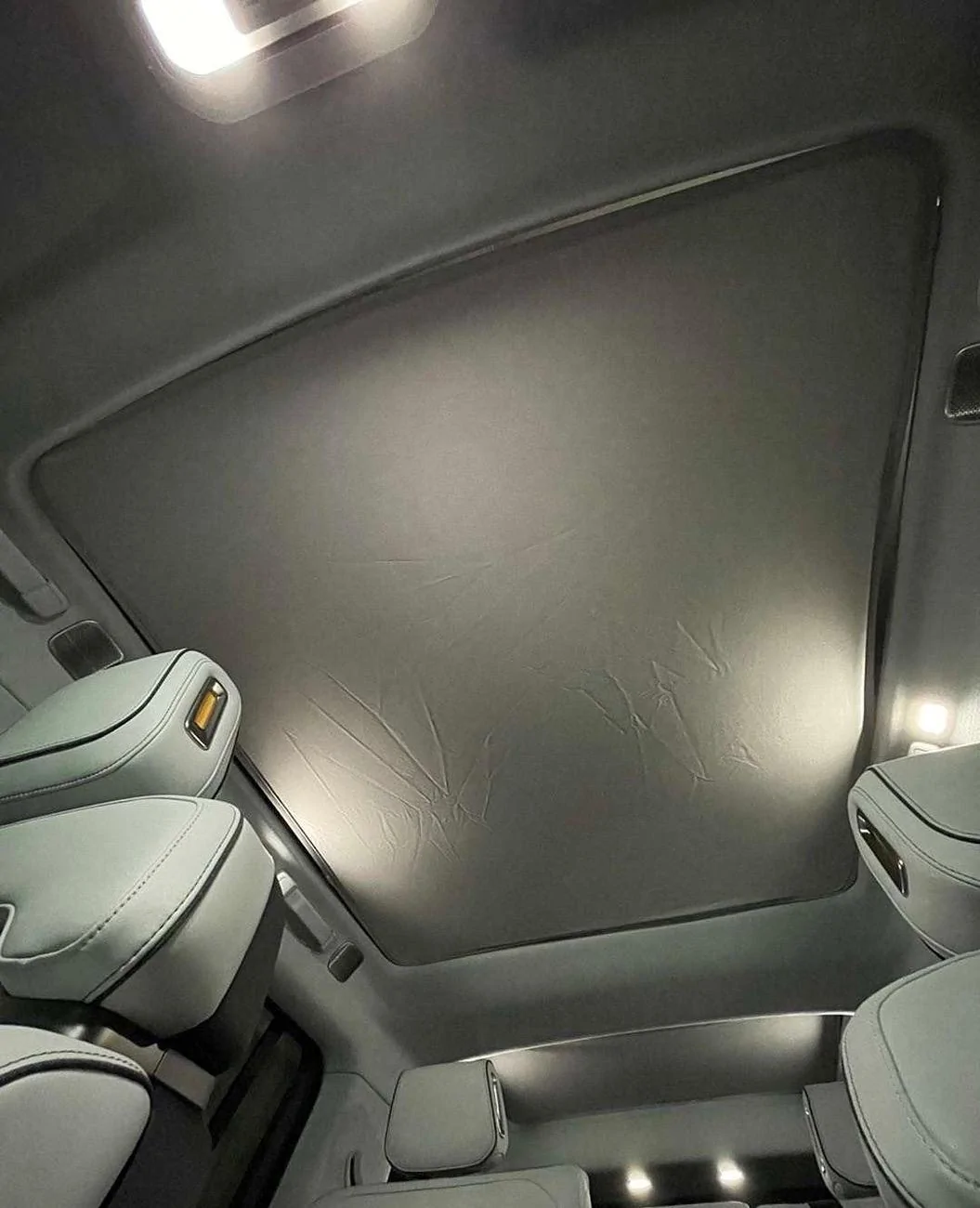

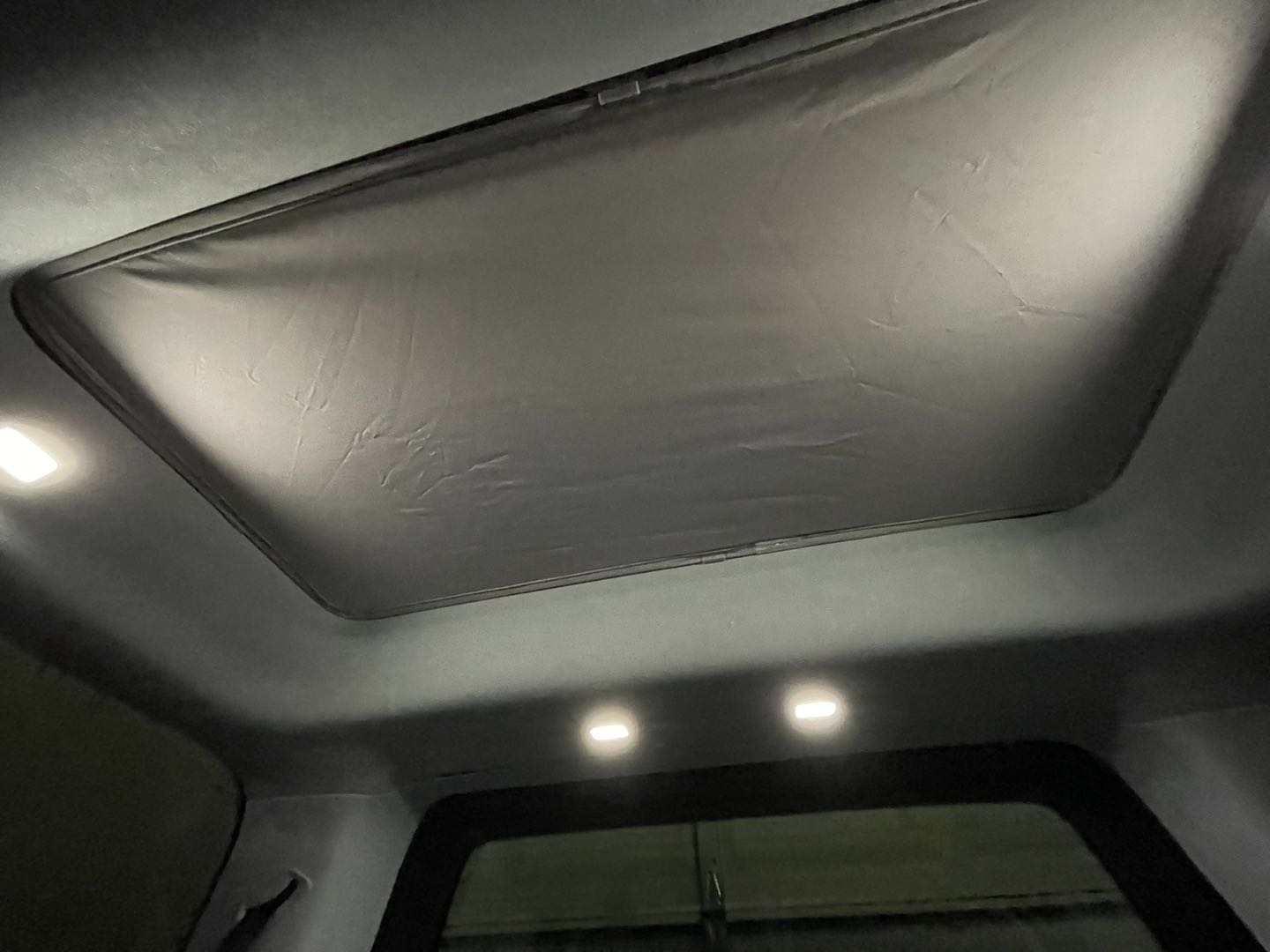

I’m testing like 5 different panoramic sunshade suppliers for fitment / quality and performance.
if y’all can hang tight and precondition the cabin for now, I’ll have the best possible option available soon for sale.
I’m also working with a supplier to improve their fit / quality so hopefully I’ll eventually have a custom solution based on forum member feedback as we improve the current designs.
The sunshades are a game changer, they just need to be made a little better.
Dual layer Grey with reflective layer

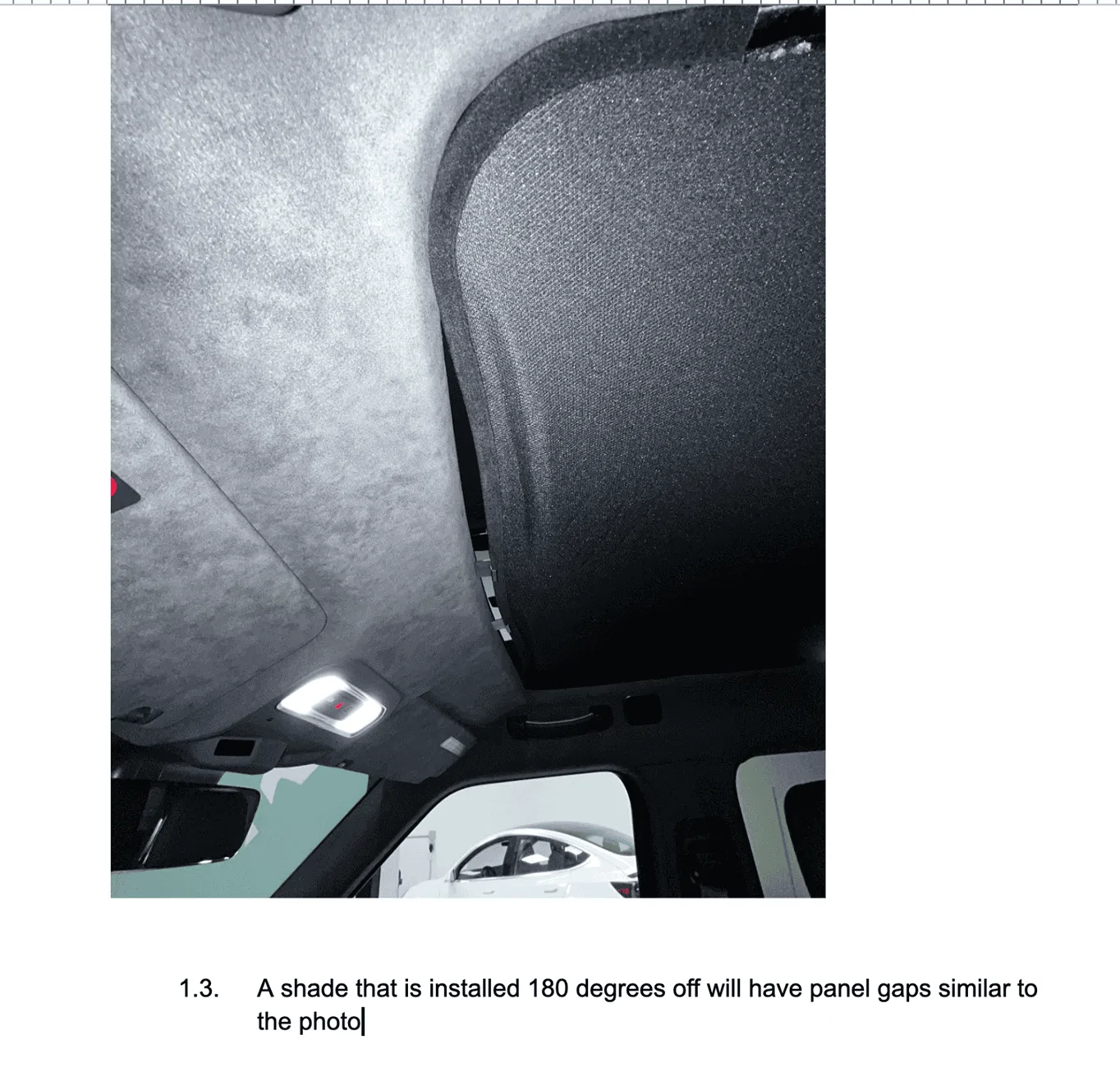

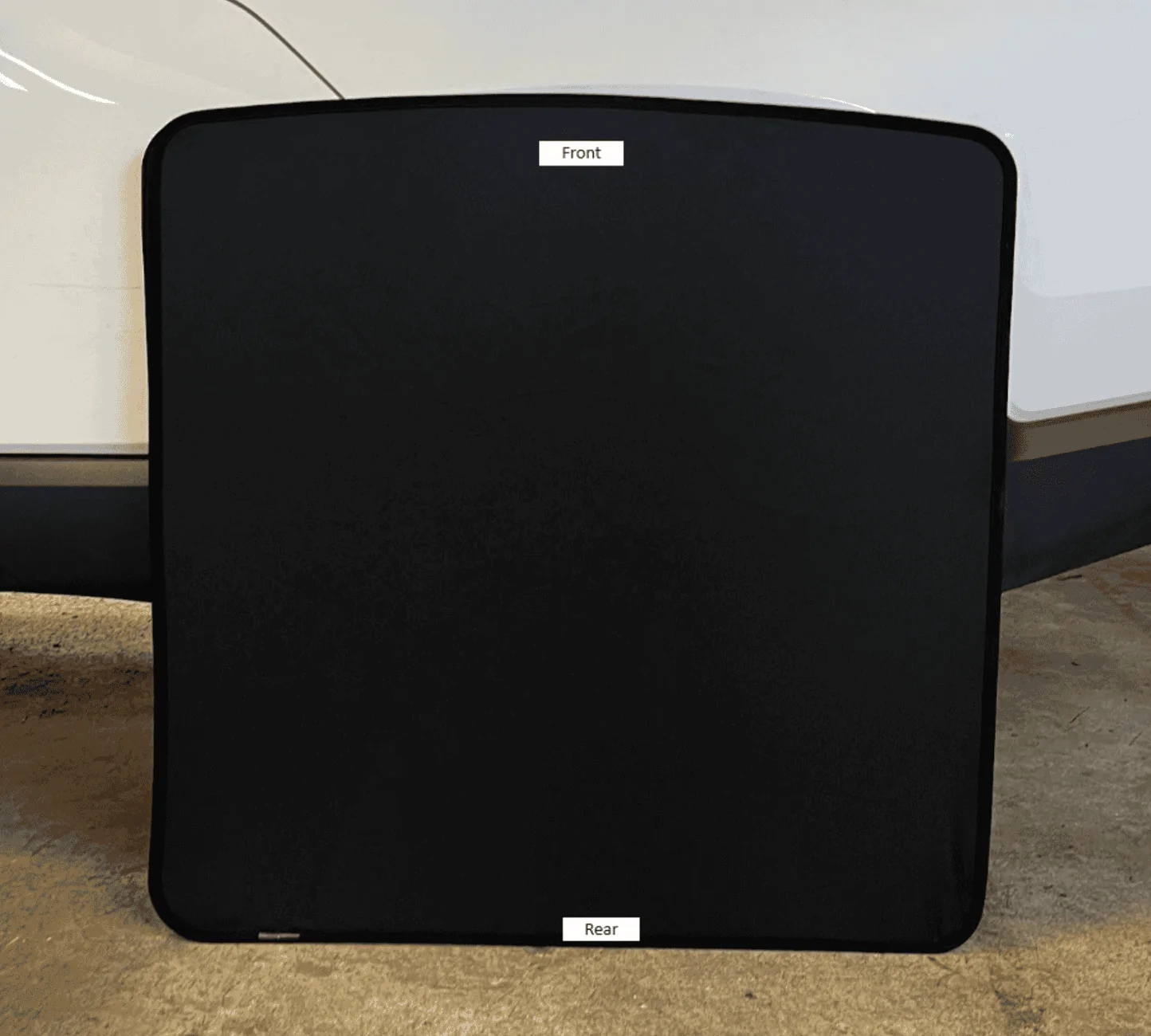

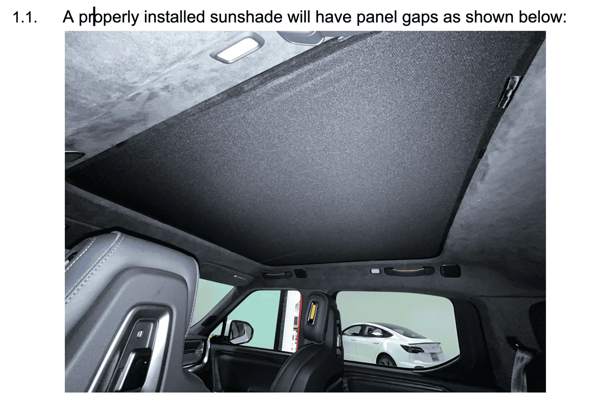

Gang - pulled one of our R1T shades from stock today - tested it. Fits like a glove, like it always has!
The #1 issue people have when the sides are 'bowed' is they have it in 180 degrees backwards. See the photo to get a better idea. Make SURE you have this curved section facing forward.
Rivian R1T R1S Glass roof cover Screenshot 2024-07-17 at 11.49.41 AM
And installed:
Rivian R1T R1S Glass roof cover Screenshot 2024-07-17 at 11.53.01 AM
and if installed 180 degrees rotated:
Rivian R1T R1S Glass roof cover Screenshot 2024-07-17 at 11.55.29 AM
