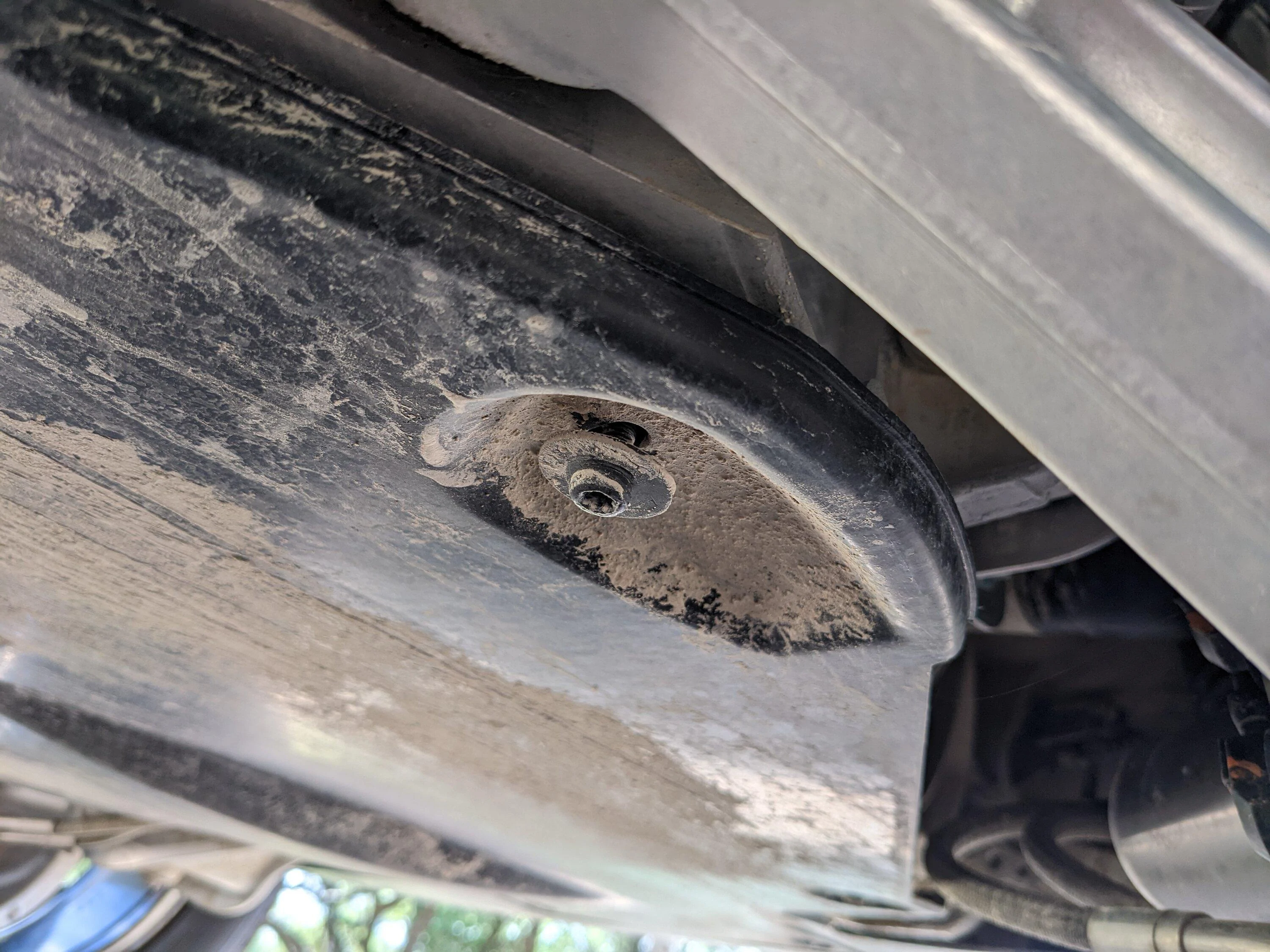

Looks like I am missing at least one fastener and a few loose bolts myself.

Today the rest of the underbody shield fell off while driving on the highway. It appears the bolts little by little started to unscrew themselves.
What's shocking is when I did check some of the bolts still connected, they didn't have any type of loctite. I can't believe metal bolts threading into the metal frame/chassis had no form of loctite to prevent them from backing out.

That's too bad. Hopefully a quick fix. Whereabouts in FL are you?
Are most car bolts loctite? Every car I’ve worked on did seem to have any loctite.

FWIW while cleaning it Wednesday, I noticed a loose piece below the driver's side door. I had to pressure wash the mud/dirt off the piece so I could see the fittings to reattach... Using the 40° nozzle of course.

So the bolt I shared was put in sideways and the bolt hole was stripped. I had to loosen the entire panel to get the hole free and clear but still could not thread in straight. Will leave that to Rivian to rethread.
I found three bolts backed out, and two more finger loose.
Since it will be "awhile" for service I retightened all of them but only a bit with a screwdriver (not wrench). Most were had a lot of play, but will let Rivian torque them down to whatever is appropriate.
I'm confident they will back out soon, some threadlock is probably appropriate.
I would encourage people to visually inspect the underbody when delivered and then check for loose bolts soon after delivery.
