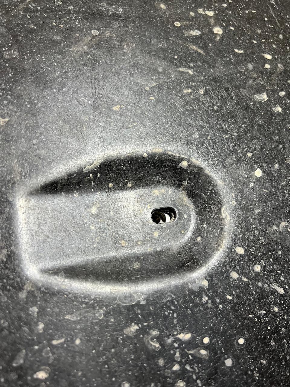

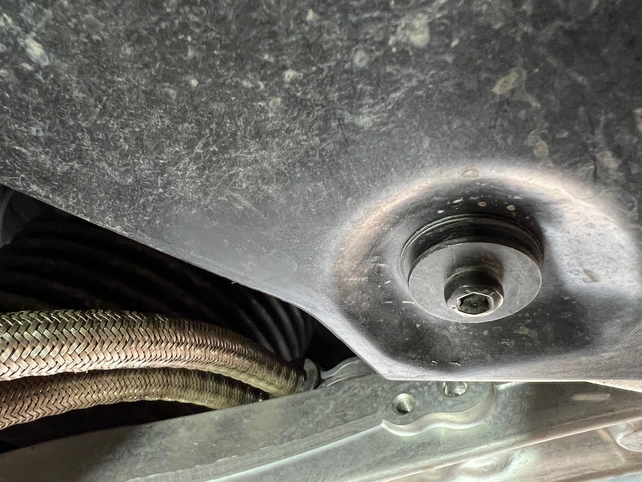

So the bolt I shared was put in sideways and the bolt hole was stripped. I had to loosen the entire panel to get the hole free and clear but still could not thread in straight. Will leave that to Rivian to rethread.
I found three bolts backed out, and two more finger loose.
Since it will be "awhile" for service I retightened all of them but only a bit with a screwdriver (not wrench). Most were had a lot of play, but will let Rivian torque them down to whatever is appropriate.
I'm confident they will back out soon, some threadlock is probably appropriate.
I would encourage people to visually inspect the underbody when delivered and then check for loose bolts soon after delivery.
I also had a cross threaded screw. Not sure if it was always like that or happened due to the panel ripping off and pulling on the screw. I also had one screw rip the welded bolt off the frame that it screwed into.

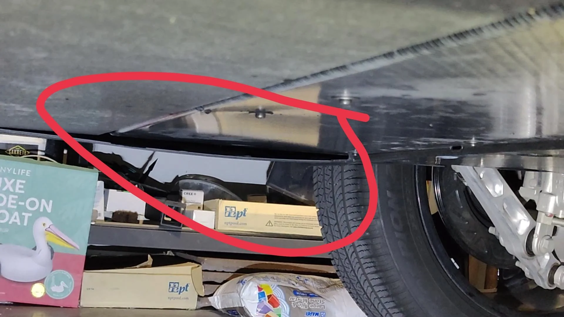

I've spent this morning under my truck trying to remove the body panel under the rear suspension. I was alerted Thursday by a co-worker traveling behind me that I had a panel loose. 7 of the 12 fasteners were missing. 2 of the remaining 5 were finger loose, and 1 little guy is cross threaded and isn't coming out. Rivian is sending a mobile tech out Monday to repair/replace fasteners. Even that took a lot of phone calls, and effort on my end. This is a major safety issue, not for us, but anyone traveling behind a Rivian if/when it looses the underside panel.
From now on, underside inspections will be routine for me.

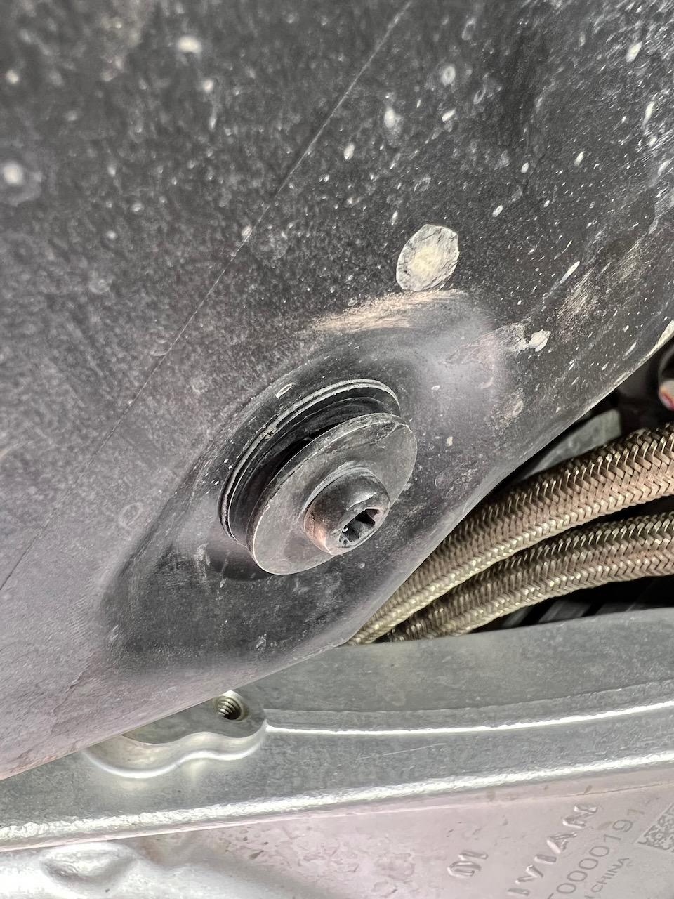

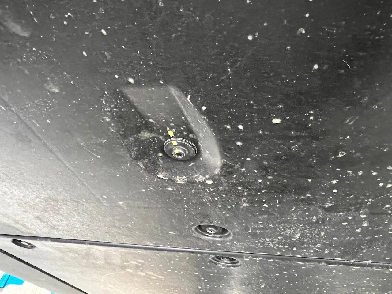

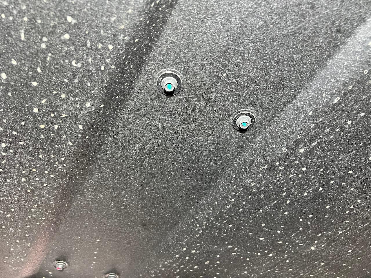

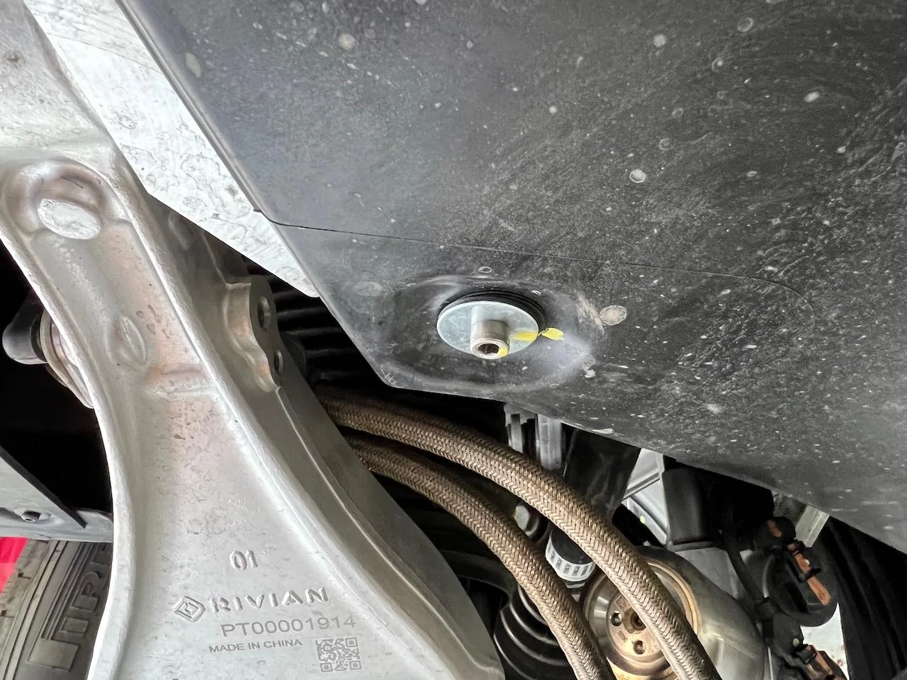

Well iI figured after reading this thread, I should at least go do a quick visual on my under-panels...

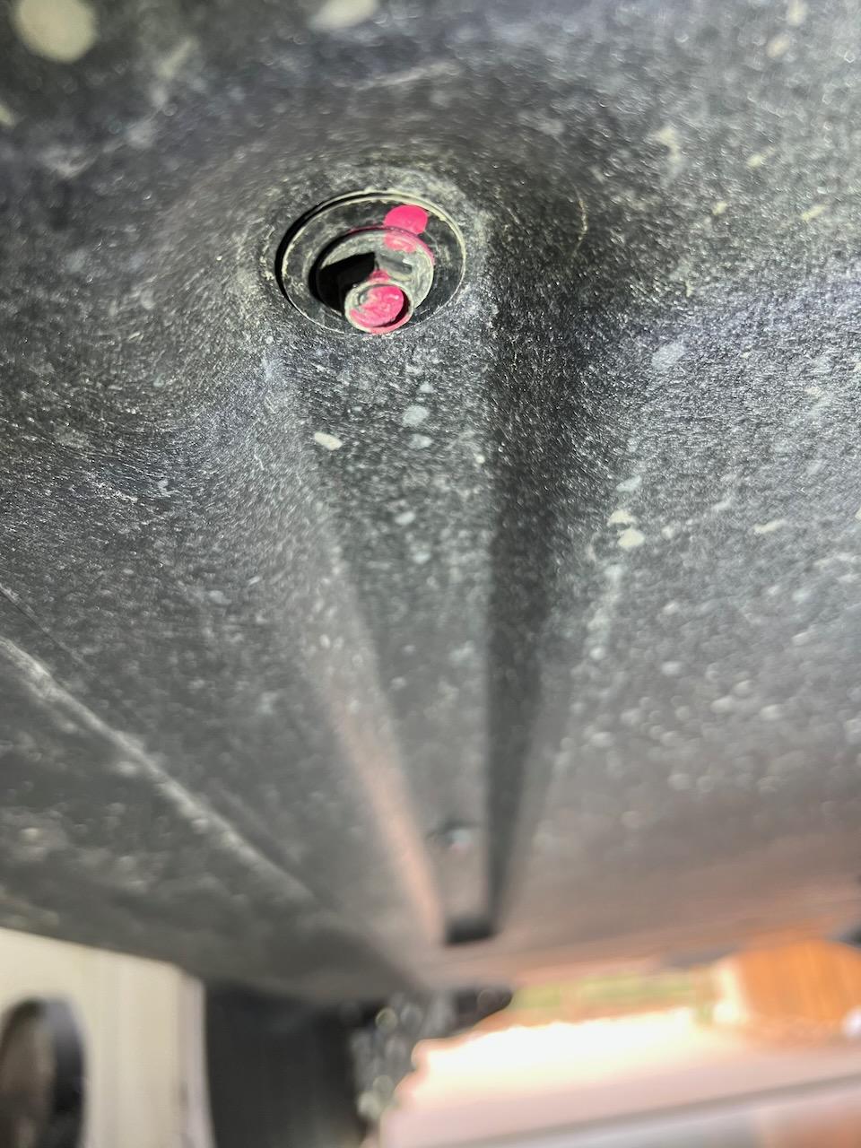

At the front and middle, everything seemed in place. I was pleased to see some color-coded witness or QA marks on the bolt heads and initially thought, "great, Rivian identified and now has procedures to prevent the issue..."
Rivian R1T R1S Has anybody lost their underbody shield yet? rivian loose bolts - 1
Rivian R1T R1S Has anybody lost their underbody shield yet? rivian loose bolts - 2

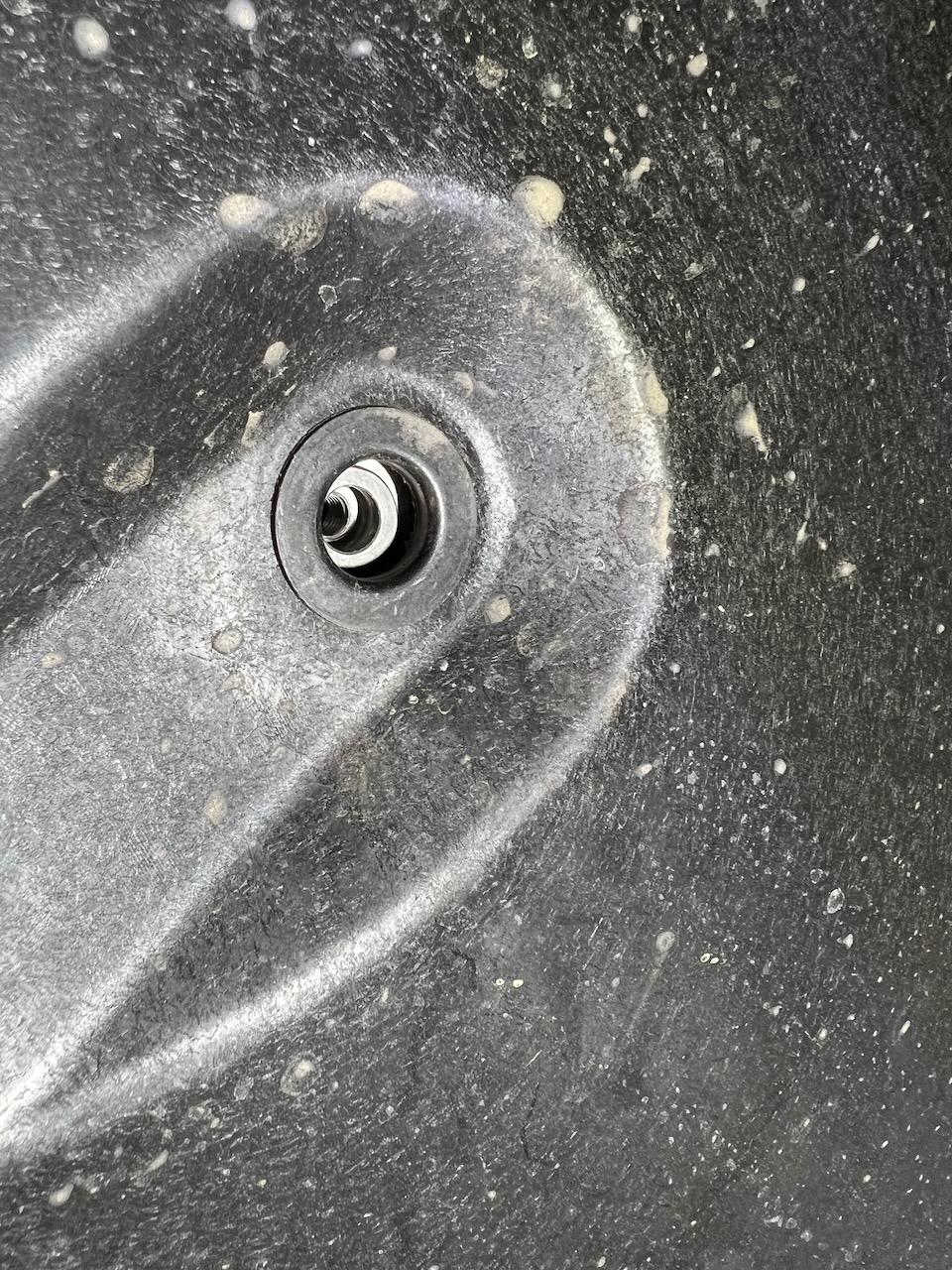

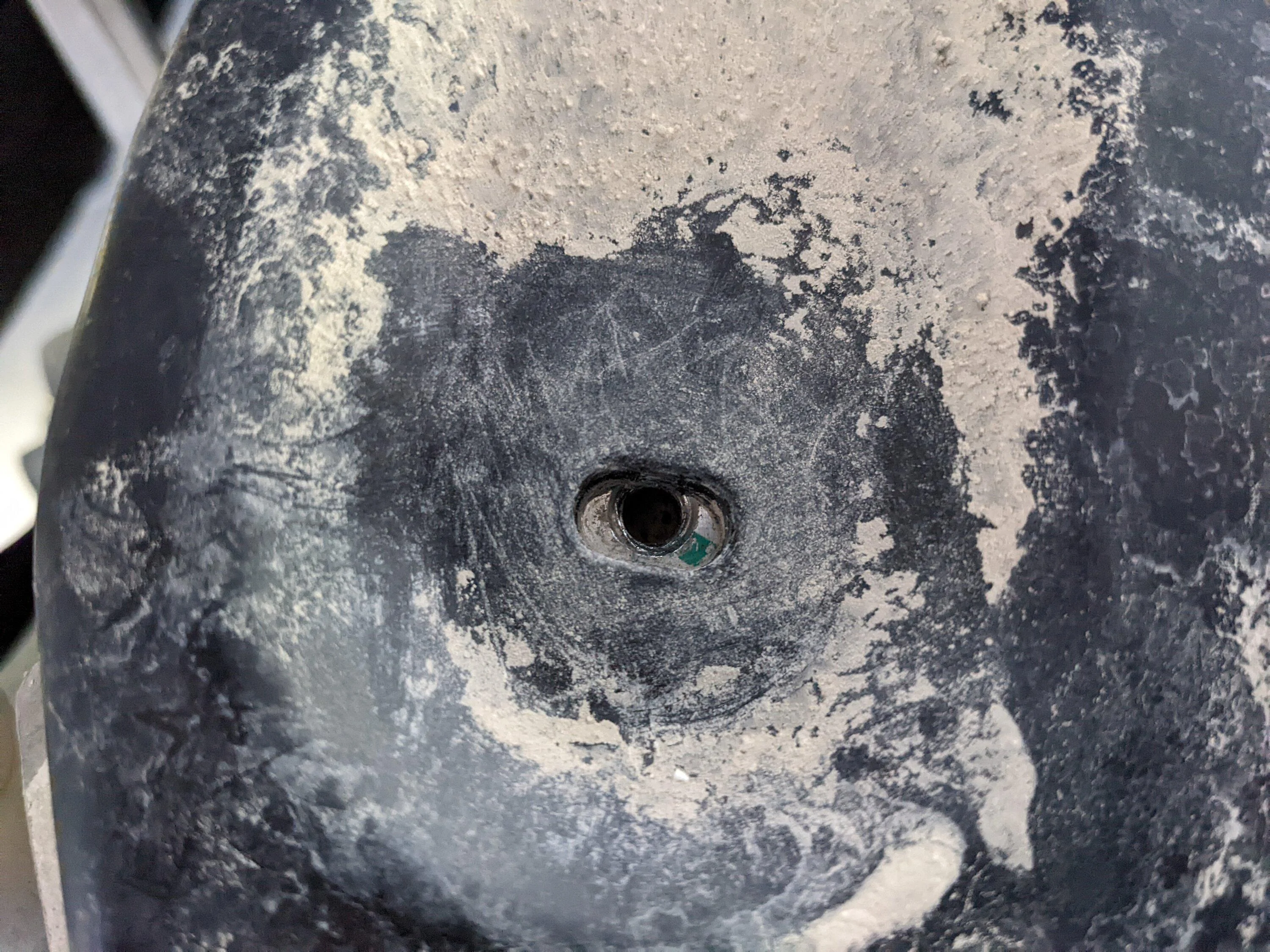

As I moved to the rear, not so good!
Two completely missing bolts, two very loose bolts.
Rivian R1T R1S Has anybody lost their underbody shield yet? rivian loose bolts - 6
Rivian R1T R1S Has anybody lost their underbody shield yet? rivian loose bolts - 3
Rivian R1T R1S Has anybody lost their underbody shield yet? rivian loose bolts - 4
Rivian R1T R1S Has anybody lost their underbody shield yet? rivian loose bolts - 5
Now just to note... The right rear airbag was replaced by the local service center just prior to delivery, so it is possible (even likely) that the loose or missing bolts were due to the service center not torquing/replacing the bolts rather than the assembly line... Not sure if that is better or worse in my opinion, but it is definitely different!
I tightened the loose bolts (didn't go crazy), Torx 30 for those that care, and also put in some temporary bolts to replace the missing bolts. I used allen head M6 as that is what I had, and again, tightened only screwdriver-tight. I put some of my own witness marks on the bolts so I can easily see if they start backing out again if Rivian doesn't schedule service quickly.
Other than these four bolts, didn't spot anything else loose on the undertrays.
