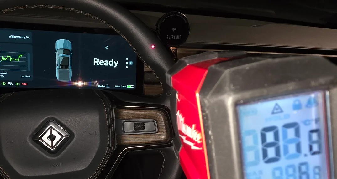

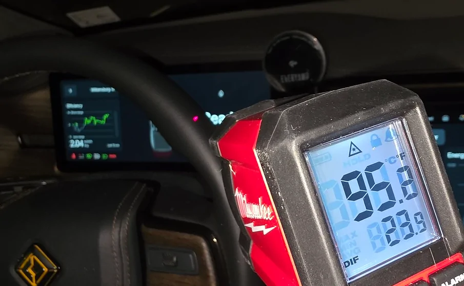

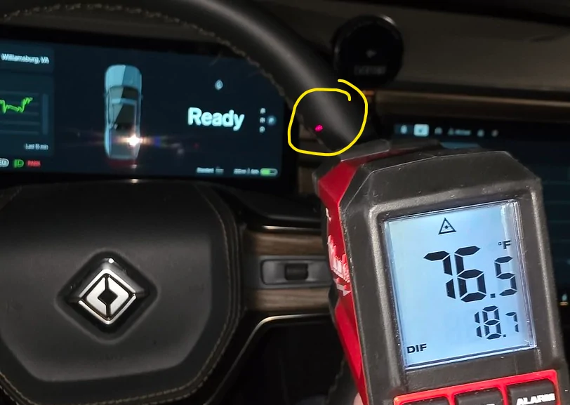

I can only comment on the Gen2, but I think anyone with a Gen2 is has the same steering wheel heater as mine. If you measure something different from what I show below, you probably have a defect.
Most likely the reason it feels like the heat decreases after initial heating is because your hands get used to it. My measurements prove the steering wheel heat is not reducing temperature after initial heating. It is true that when it is heating, some places on the wheel have higher temperatures. But it appears there is a target temperature, and the system maintains that temperature for as long as you have it turned on.
The temperature that appears to be the target is 85F. The outside edges of the steering wheel can reach 95F or 100F when heating, but the center seems to hover around 85. Is this warm enough? Maybe not. It is a design choice, but certainly it works.
From my testing, the temperature was maintained for more than an hour, close to two hours, and then I stopped testing. Definitely there is no drop off after 5-15 minutes as others have suggested. That is just your hands getting used to the temperature.
I measured the temperature on the inside, middle, and outside of the wheel at the 10 and 2 positions. On the inside, it was the coolest consistently:
Rivian R1T R1S Heated steering wheel? How warm is it supposed to be? 1765929589976-89
On the outside, it was consistently hotter. Especially during the heating cycle. During the heating cycle it was typically at 95F. When off, it would drift down to 85F before turning back on and heating again.
Rivian R1T R1S Heated steering wheel? How warm is it supposed to be? 1765929711067-iq
The middle of the wheel was consistently at 85F. When it got much below 85, the heating cycle starts again, and it heats back up.
Rivian R1T R1S Heated steering wheel? How warm is it supposed to be? 1765929806480-2t
This isn't a problem IMO. It is just a design choice, and it works fine.
Let me know if you have any questions.
