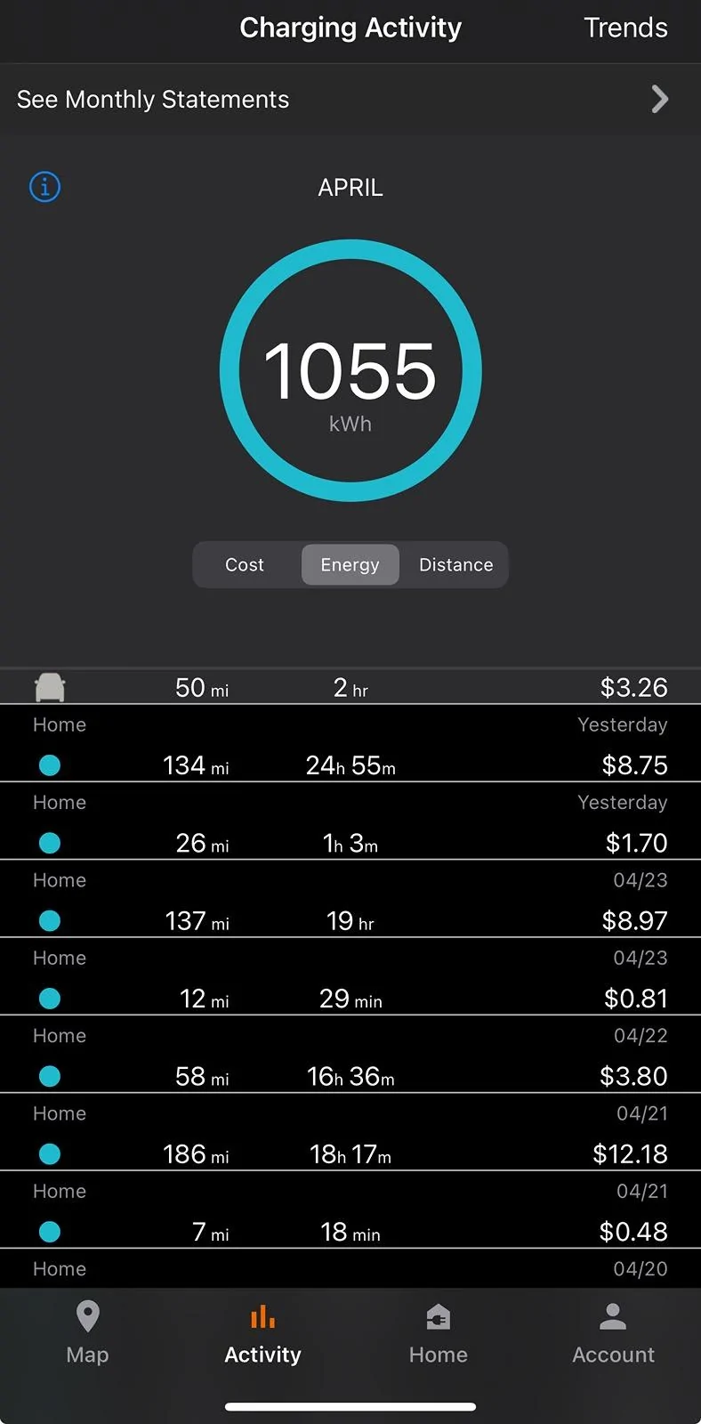

Hey I’m curious if the Rivian charge shows a history of past charge seasons that shows how many KWh were delivered. Does it give you the ability to see a summary of kWh by month? For example here is what data I can see on my ChargePoint. I have a Rivian wall charger I haven’t installed yet, I’d like to have a second, but also want to be able to monitor how many kWh are used each month.
