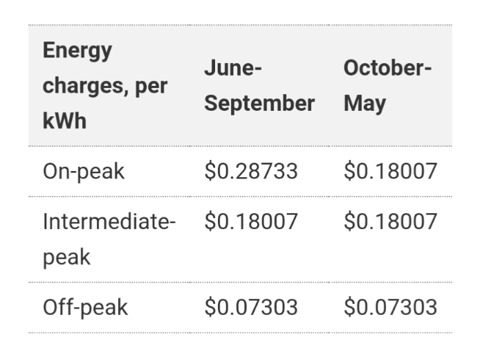

We had you use EV Juicenet to be a part of a pilot with the electric company in Wisconsin. You may want to check with local incentives before purchasing one. We get a $0.12/kw discount by using it so the difference can be significant.
If I got a .12/kw discount it'd be free
