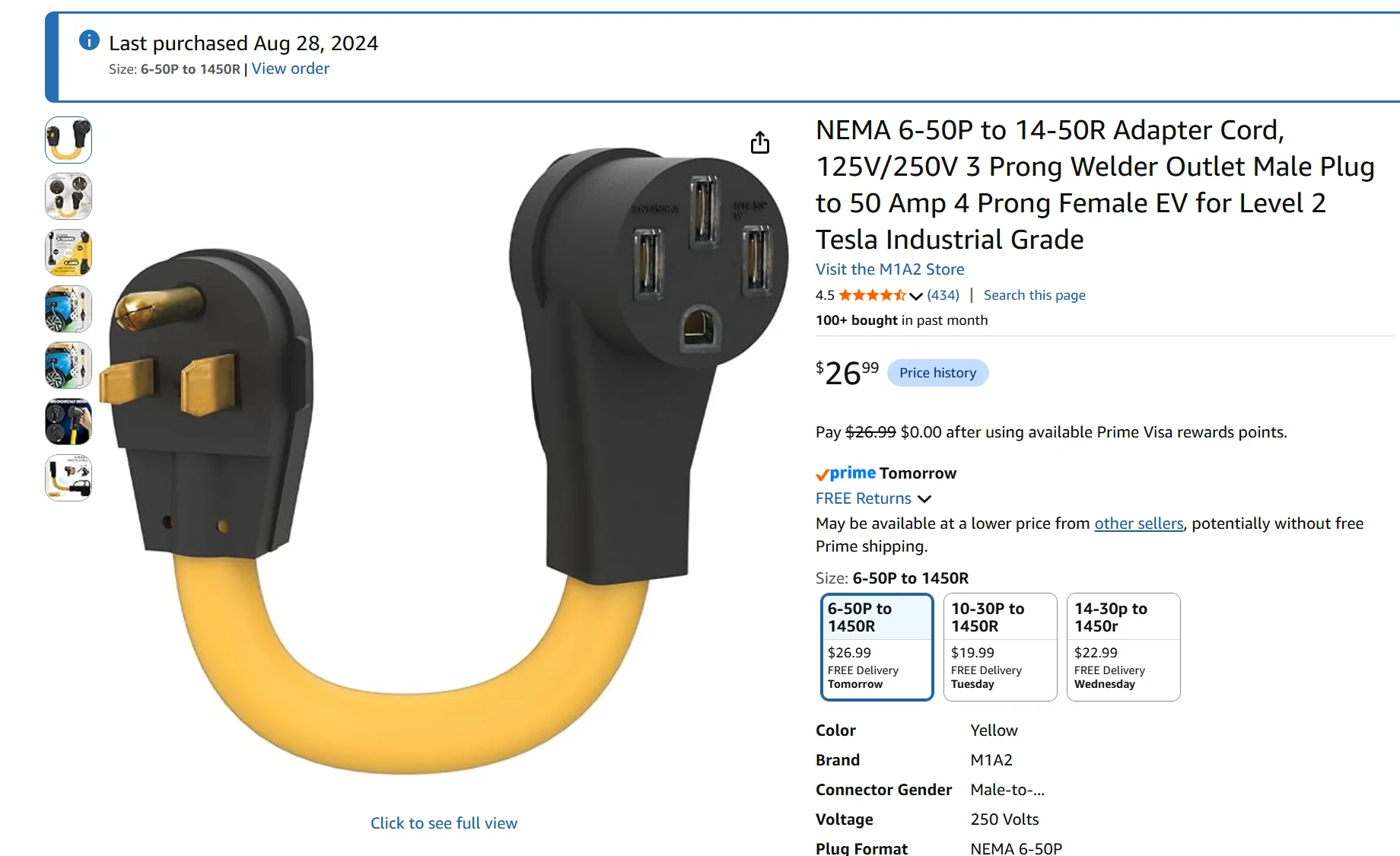

I’ve used a cheap adapter for years.
https://www.amazon.com/dp/B083LRJ4DP
Same.
5-6 years ago when we got our L2 circuit installed, I went with a simpler N6-50. Had an L2 and a modular mobile that would work directly.
Years later I wound up switching over to my BMW "portable" charger, it's modular, but no N6-50 option, so I just used an N14-50-to-N6-50 adapter, been running fine for years now.

When a Hubbel outlet alone is $60 there is no way that for $26 you can get something that has both a plug and receptical that can safely deal with 40 continuous amps for hours. Lots of reports of $20 non-commercial recepticals failing over time. It's probably OK to run your RV short term low demand load with one of these, but not 5 hours of 40 amps over and over. https://www.amazon.com/Hubbell-9450A-50a-120-volt-Receptacle/dp/B00EN9VO7W
But the Tesla adapter at $35 is perfectly safe right?
