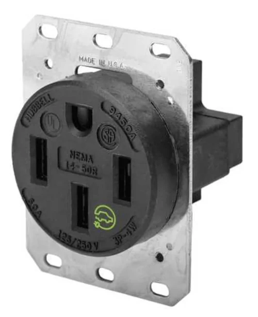

I had this problem with the Rivian portable charger. Since I had two other portable chargers, I had tried both with the same result - it would fail to complete the charge.
My NEMA 14-50 looked fine but it did get very hot. So I opened the receptacle and noticed that the back of the 14-50 plug had some heat damage. It was installed professionally with permit as a dedicated 50 amp single use for EV charging purposes but after few years, it must have failed. I replaced it with:
Rivian R1T R1S Home Charging Error - Using Portable Charger 1777485106516-it
https://www.amazon.com/dp/B00EN9VO7W?ref_=ppx_hzsearch_conn_dt_b_fed_asin_title_1
Notice that this 14-50 plug is especially designed for EV charging. My old plug was made by the same company but did not have the green EV charging logo.
Since changing a year ago, never had any failure and my 14-50 and the line conduit both stay much cooler than before. My vehicles are set to 30amp charging.
Good luck.

If the outlet is fried, I'd suggest you just hardwire the ESVE given you say you never unplug it. Get rid of a point of failure.

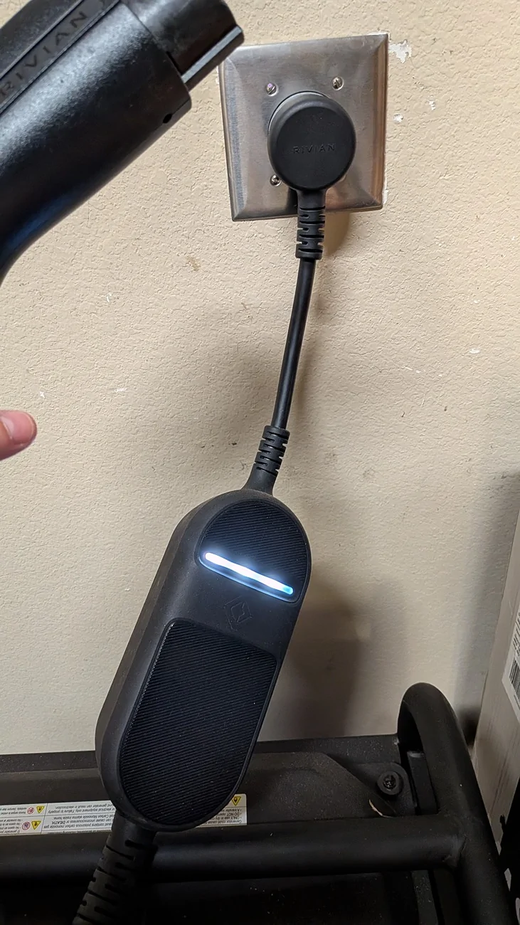

Been using the Rivian Portable Charger the last year in my garage which never gets unplugged
Let's see a picture of how that's hanging, before you start talking about ripping out the wiring.
VSG
Oct 3, 2022
3,382
6,407
R1T LE/RB/OC/20
Thank you. Notice the short wire between the charger body and the outlet - that is detachable and doesn't snap into place.
The charger body is heavy. When you have it hanging that way the weight of the body pulls down on the wire, and over time there is less and less contact at the junction between the wire and the body. This can cause charging errors - ground fault trips, heat issues due to the increased resistance at the connector, and other issues which cause the portable charger to terminate the session.
This specifically becomes an issue over time if you keep the portable charger plugged in and hanging there all the time. Which is exactly what the case is in your situation. Like they say, gravity sucks.
The fix is simple - the portable charger is meant to hang on a screw. If you read the manual, they tell you this:

Most people, me included, skip #2 and #3 until it becomes a problem. So you might want to check that.
Thanks. That cord seemed tight in there. So I puty bmw on 20a charging and tried the charger all day. The recepticle is cooler and I haven't had any errors from the bmw unless their software doesn't show stoppage or notify if it happens
