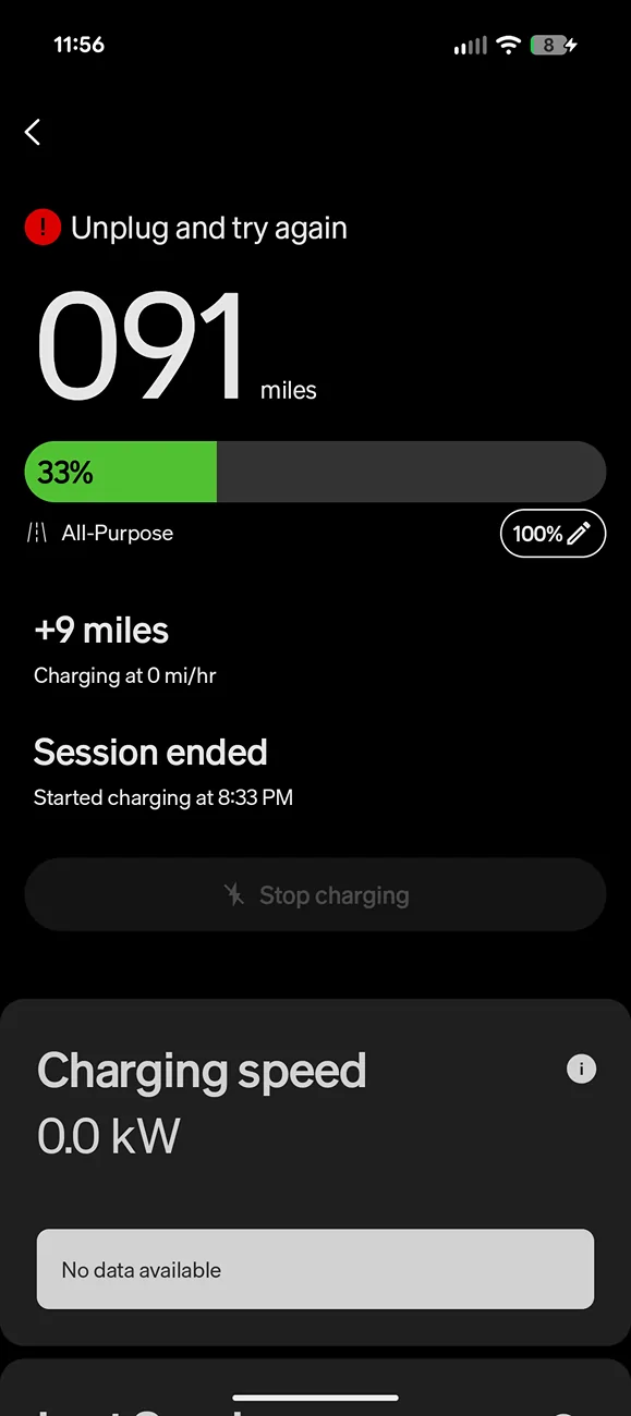

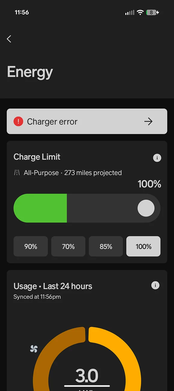

Been using the Rivian Portable Charger the last year in my garage which never gets unplugged. Currently have had my R1S set to charge at 28amp or 22amp. Once or twice during the charge I will get a charger error notification asking me to try again. After a few minutes it starts charging again. The wall plug is very warm but not burn your hand hot.

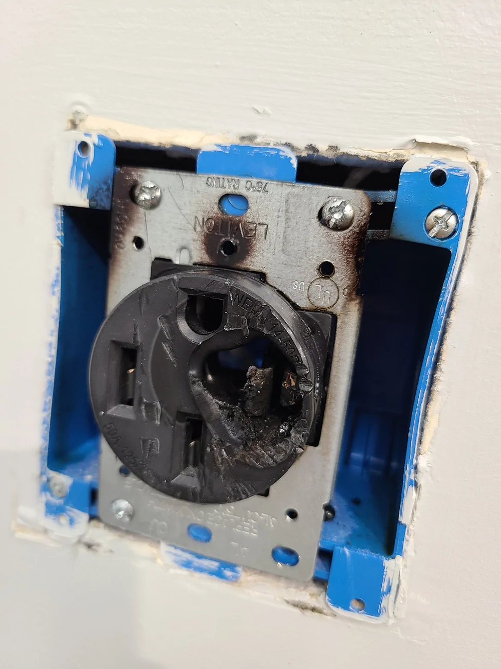

You probably have a loose terminal on your receptacle. Unplug, remove the receptacle and tighten the terminals with a torque driver (not just a screwdriver). The receptacle could also be starting to fail if it's a $15-$20 part. This is what they look like when they fail:

Do you have a HD EV rated outlet? It will say it on the packaging and cost about $50 instead of $12.

Definitely sounds like an outlet problem, especially if it's warm to the touch.
I put a Hubbell NEMA 14-50 outlet in my garage. Ran 6AWG/3 Conductor ROMEX style wire to it, and put it on a 50A breaker. From there I run a 50ft "RV Style" extension cord to the front of the garage where the Rivian portable charge sits in a wall mount bracket. Charge nightly at 7.4kW (~30A), which is the max the portable charger can/will supply. I check everything biweekly with an IR gun to ensure no loose connections or heat buildup. Usually wait 2-3hrs into the charge cycle to ensure it's had high current for enough time to build heat. I've yet to see more than ~10deg rise on any component over ambient temps. Nothing ever feels "warm to the touch".
If you already have a 14-50 outlet in the garage, replacing the receptacle is quite easy, and honestly doesn't take much more effort than replacing a regular 120V outlet. Turn the power off to that circuit, unscrew the old one, screw in the new one, turn power back on.

Mine melted after a little more than 2 years. I probably only unplugged it 3 or 4 times. I used a Tesla gen 1 UMC which let me charge at 40A though.
If you're just replacing the receptacle (14-50R), that shouldn't be very expensive, probably whatever the electrician's minimum charge is. Hubbell and Bryant are popular names because they've always been known as a "heavy duty / commercial / industrial" supplier, but other companies like Leviton now have "EVSE rated" receptacles that should be fine as well.
