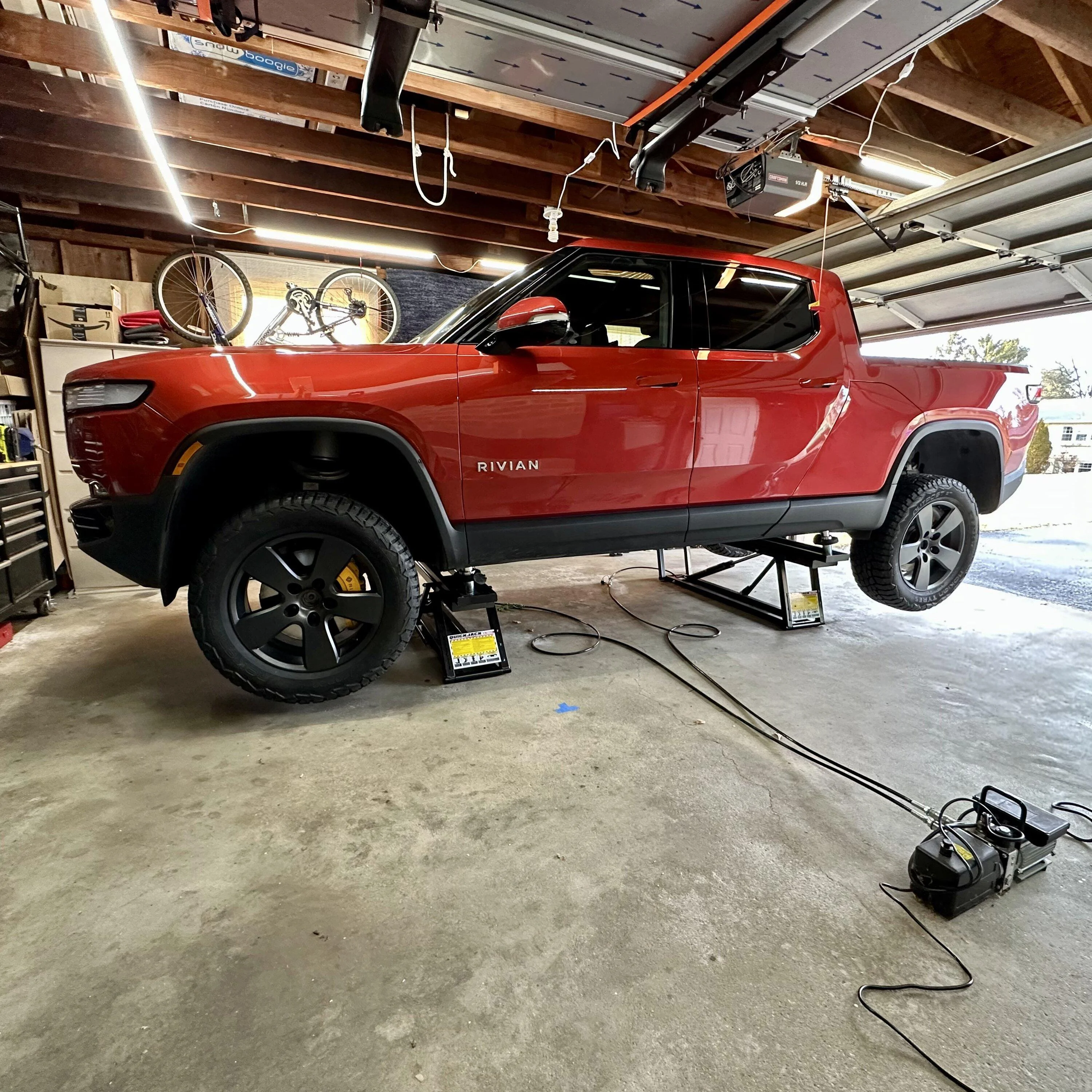

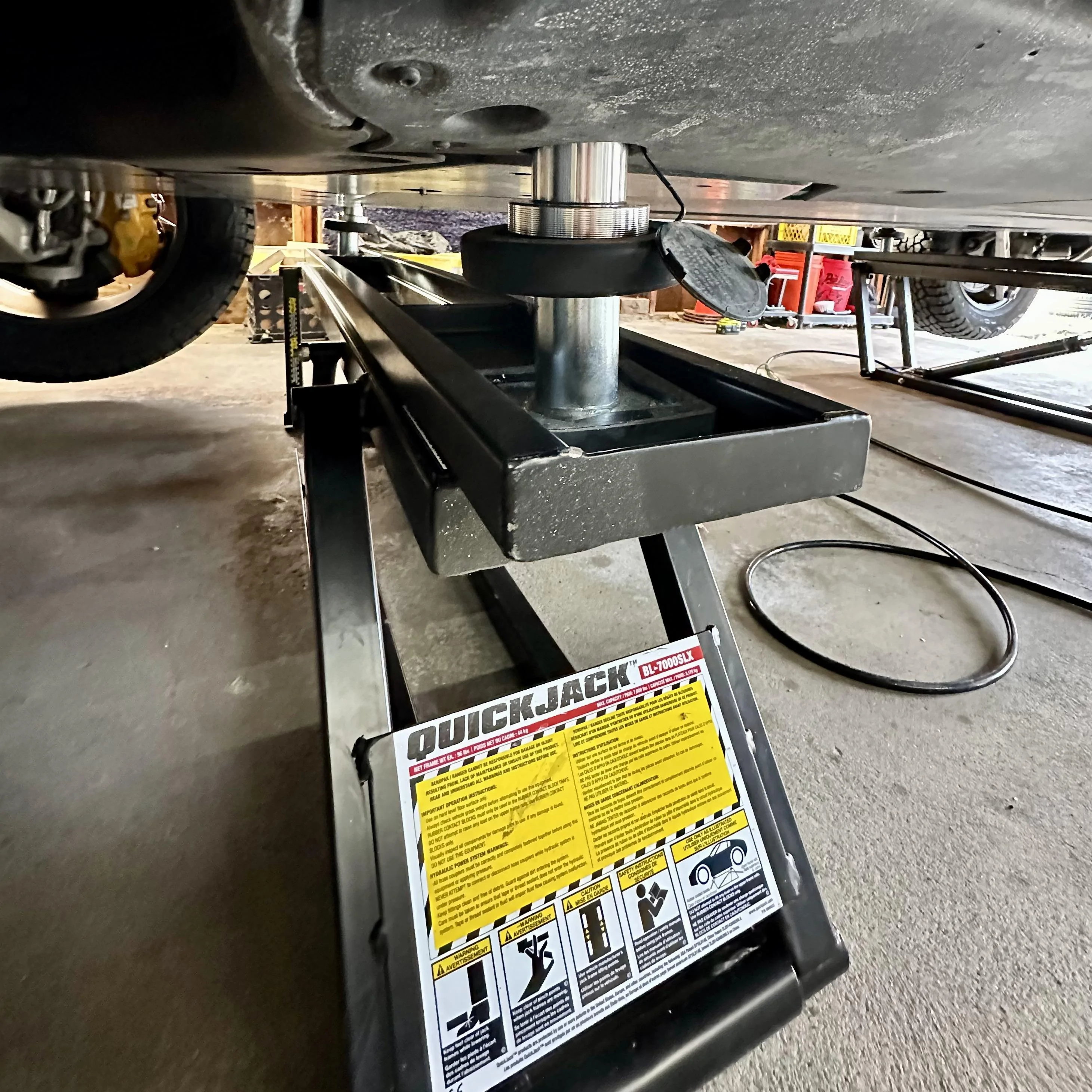

I was finally able to try my QuickJacks this past weekend. I only could lift to the lowest lock setting in my garage, and once you get them positioned correctly they work ok. I did have to use the SUV/Truck adapters with the Rivian Jack pucks, the standard rubber lift blocks compressed more than I was comfortable with. The side to side motion does create a weird lifting motion. I might try to find a way to allow the tires to slide easier on the floor next time. Also I did have to use the frame extensions (interestingly, the rear jack points are further apart than the fronts).
Rivian R1T R1S Home lifts that work?! 20230211_213436253_iOS
Rivian R1T R1S Home lifts that work?! 20230211_213429027_iOS
Sorry didn't get a full video, was trying to film and lift myself, while watching the garage door open above and making things were square below.

What is your reasoning for lifting side to side instead of front to back? I've never seen them used to the side like that.

I've never seen quickjacks used that way before. do they not fit under the frame rails?
The jack points are too far apart front to back. This is the alternative lifting method QuickJacks recommend for these situations, but it does make some weird lifting dynamics until the suspension has fully drooped out. I used tire change mode to lift the suspension to the highest and keep it from adjusting, but it was still hard to get the jack/adapter stack to stay lined up. I had to go down and up a few times to adjust as things moved. Once it was all positioned correctly though, it was perfectly stable.

Makes sense. Surprised they don't have a larger one that would actually work yet.
I measured the points to be 82" apart front to back, the longest QuickJack that will support 7000 lbs is 66" (same as mine with extensions). Will have more freedom for jack placements with plastic underbody panels removed or sliders. Definitely is more stable the farther apart you place the jack points though.

I have a QuickJack with the frame extensions and truck adapters like you, but I find it's quicker and much easier lifting the Rivian at each corner with a 3 ton jack to change wheels than navigating the QuickJack to lift it sideways. The QuickJack is not that useful on the Rivian since there's practically nothing under-body to work on, not like ICE vehicles where you need to work on exhaust, transmission, engine, or oil changes. You can do it all one corner at a time with a 3-ton jack.
I definitely agree that it would be faster to do a 5 tire rotation using a conventional jack, and there is very little that you would need to raise the whole truck for. I was just curious to see if it could be done, and now I know if I need to do it I can.
