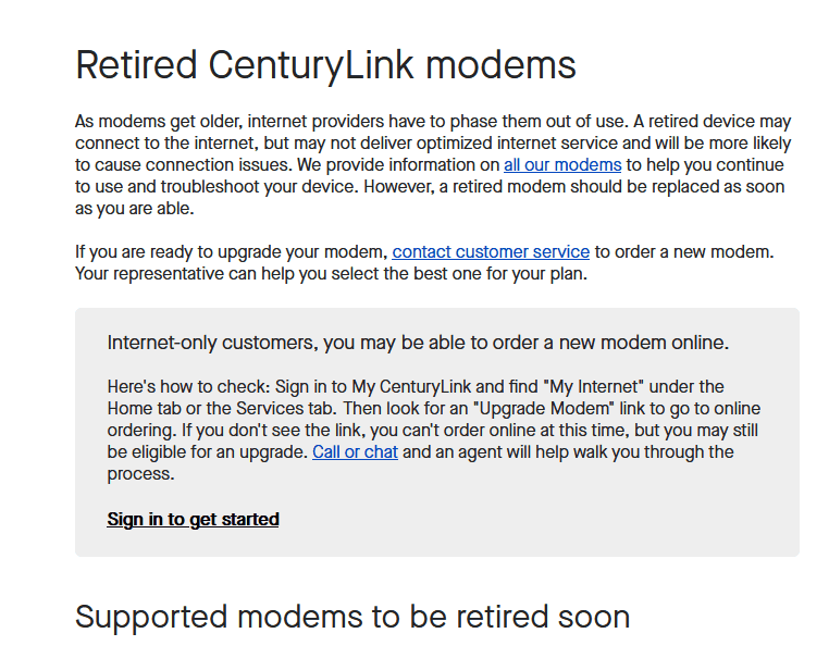

Understood. Just so you know dsl 1 and 2 is the feed coming from the phone company. From outside the house. The WAN connection. There should be a wifi section and maybe it's under the LAN portion? Look for for the model number on the label of your router, and they have instructions for each model.
edit, try this.
https://www.centurylink.com/home/help/internet/modems-and-routers/actiontec-c1900a.html
edit again, oh it says it does not even have 5 ghz, so this may be of no help.
