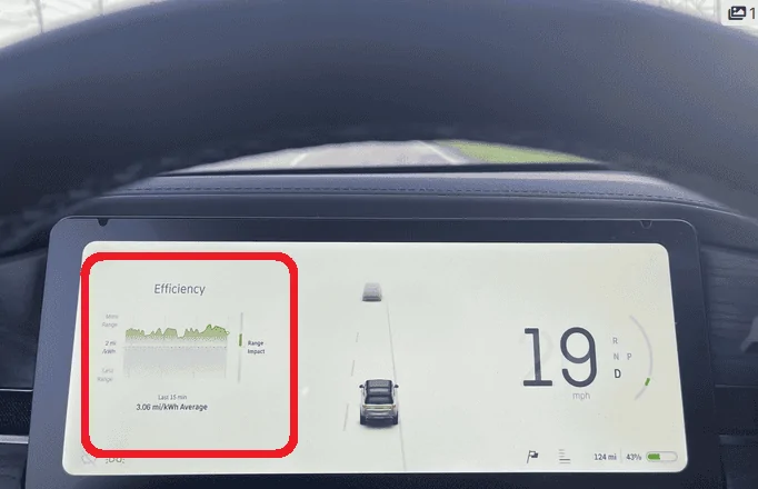

OP.. if you're making a lot of shorter (less than 20min) trips, that dings efficiency as the battery pack takes at least that long to warm up to optimum temps. The same happens in an ICE vehicle... terrible mpg until the engine and transmission get up to optimal operating temps.
Keep an eye on the energy graph screen on the far left of the driver side screen. In the beginning you will see it start below 2mi/kWh but it will eventually creep up once the battery warms up.
