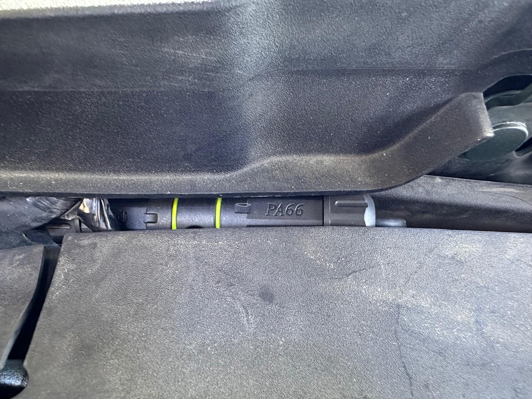

Where did you run the other end of your USB cables for your solar panels?
I ran them up to about where the frunk struts are — and terminated to a waterproof connector which I’ll connect to solar when charging the Anker.
Cool. For some reason I had the impression you were running them through the cab interior and back. Hence the confusion.
I do plan on finding a way to do that, as I think it’d be great for leaving truck, like at airport or when backpacking and leaving truck at trailhead.
