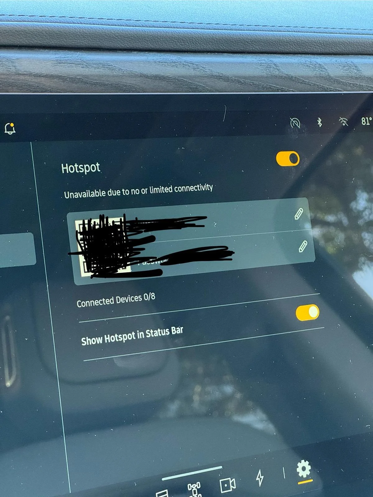

ISSUE: Hotspot unavailable; cannot connect and unable to turn off

I haven't seen this issue until recently, but it seems my hotspot is stuck in an unavailable state. The toggle is darkened and doesn't respond when tapped, so I'm unable to turn the hotspot off and back on. Has anyone else encountered this before? I'm charging right now but my next step is an infotainment reset to try and clear it.

I had this happen, infotainment reset fixed it.
It's been a while since I had to give it the ole turn-off-turn-back-on so hopefully that works ?

Infotainment reset fixed it; thanks all!

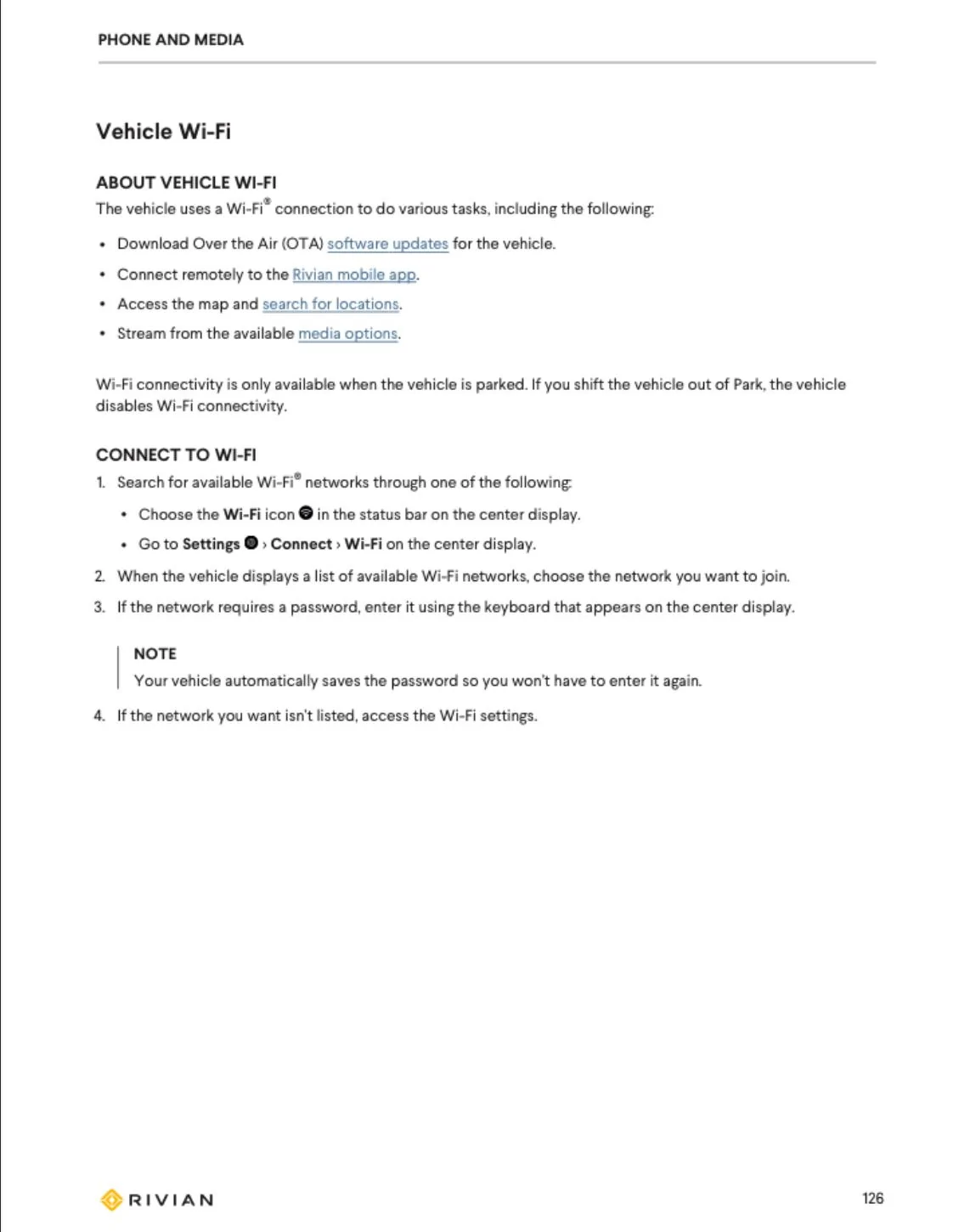

WiFi is disabled when you shift out of park.

No one's talking about vehicle Wi-Fi. This post is about the mobile hotspot. Hotspot absolutely works while the vehicle is in drive.
