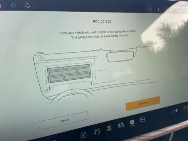

So on a related note, I have a gate to my community which has a really crappy little remote that seems to only send a signal to open the gate quickly then stops transiting..
I've always had trouble programming that little fob to any of my vehicles.. with enough time and cursing it eventually seems to get the code captured. That being said unfortunately that wasn't the case with the Rivian.
I thought about it for a minute and decided to get a cheap aftermarket code learning remote off Amazon and cloned the gate to this device. Then I told the R1T to learn this remote instead of the other one and *poof* worked first try..
So if you guys have automatic gates or something having shorter transmit times you might want to look up a 3rd party remote to clone your current remote to then try paining the truck with this..
I know it seems weird but it totally worked in my situation and now both my garage and gate work great with the truck.

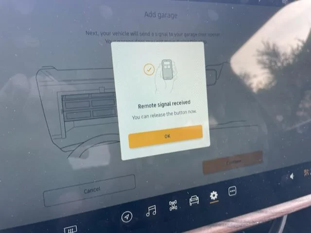

I’m curious of others are running into the same issue I’m having trying to program my gates. I can get the truck to read the transmitter but it fails at the next step.

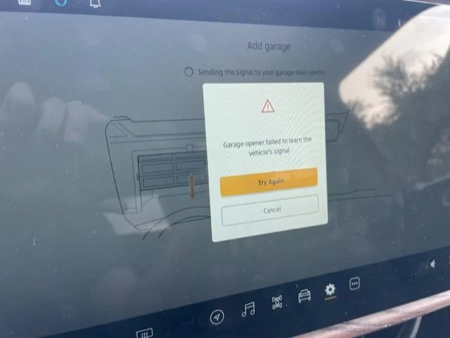

yeah i tried a couple combinations of the learn button and none worked.
Same my liftmaster gate just cannot add. It claims it adds it but when you hit test..nothing. You also can't hit the cancel button.
