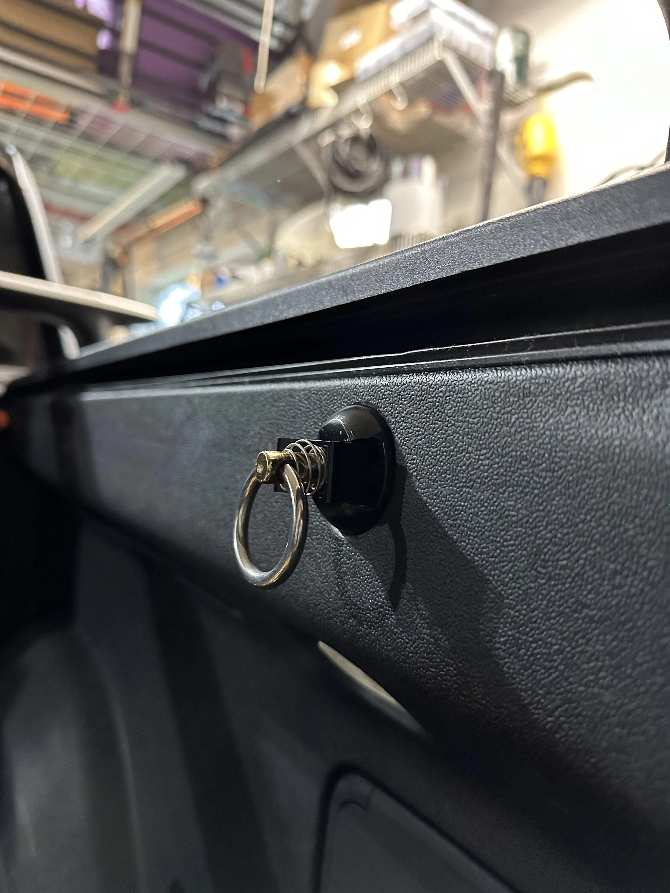

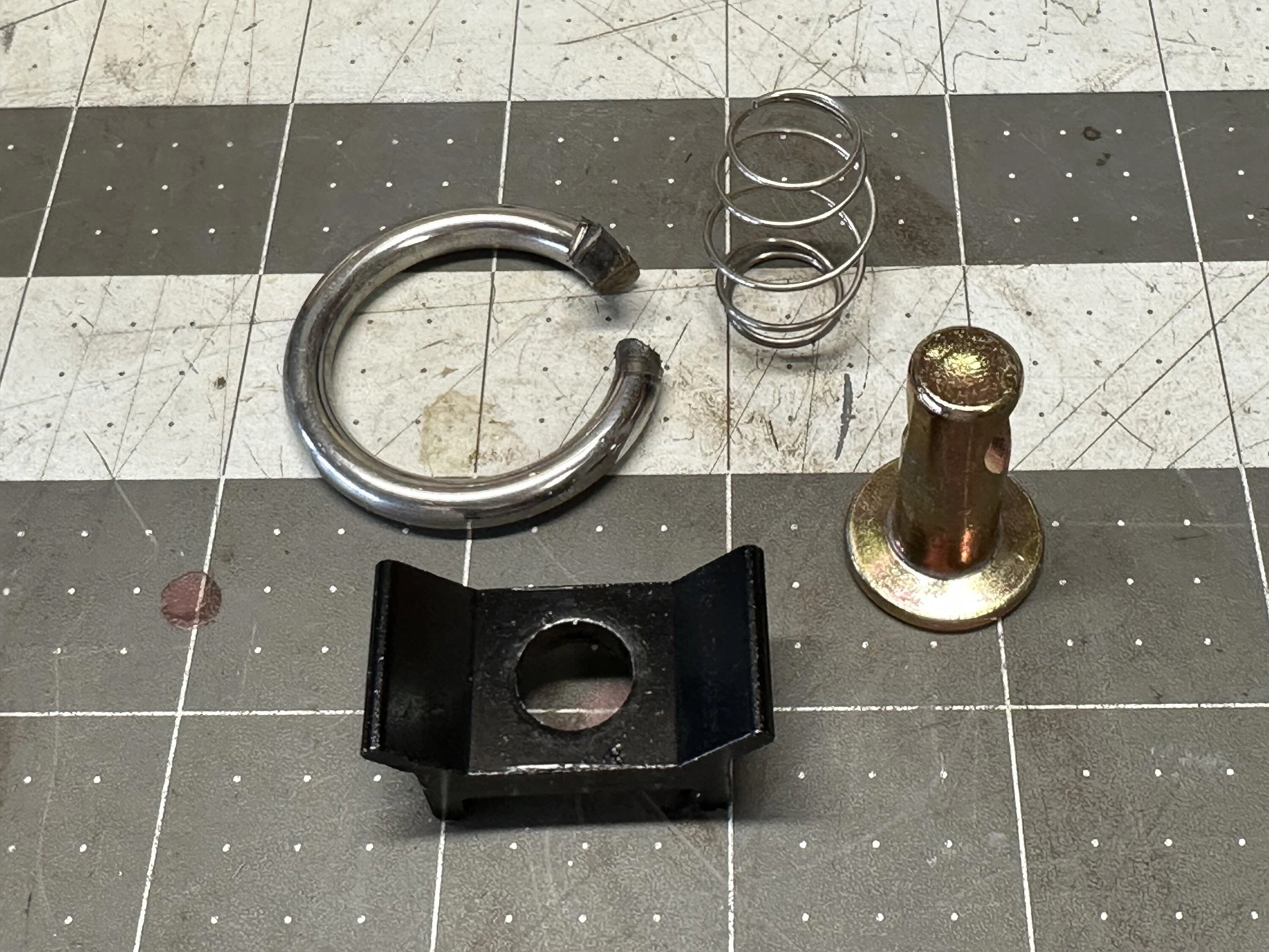

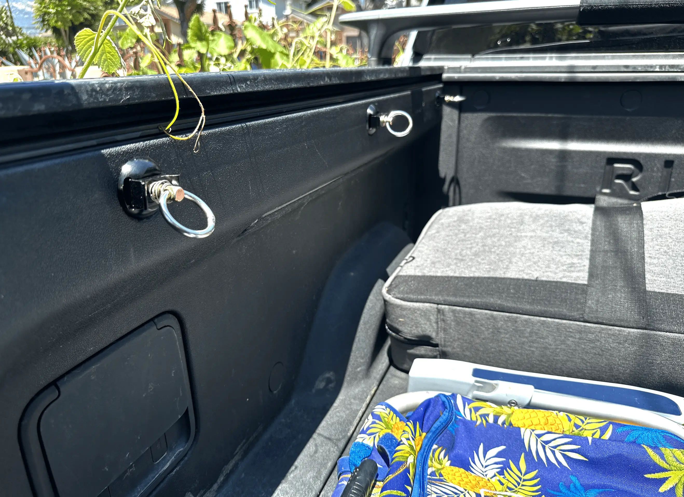

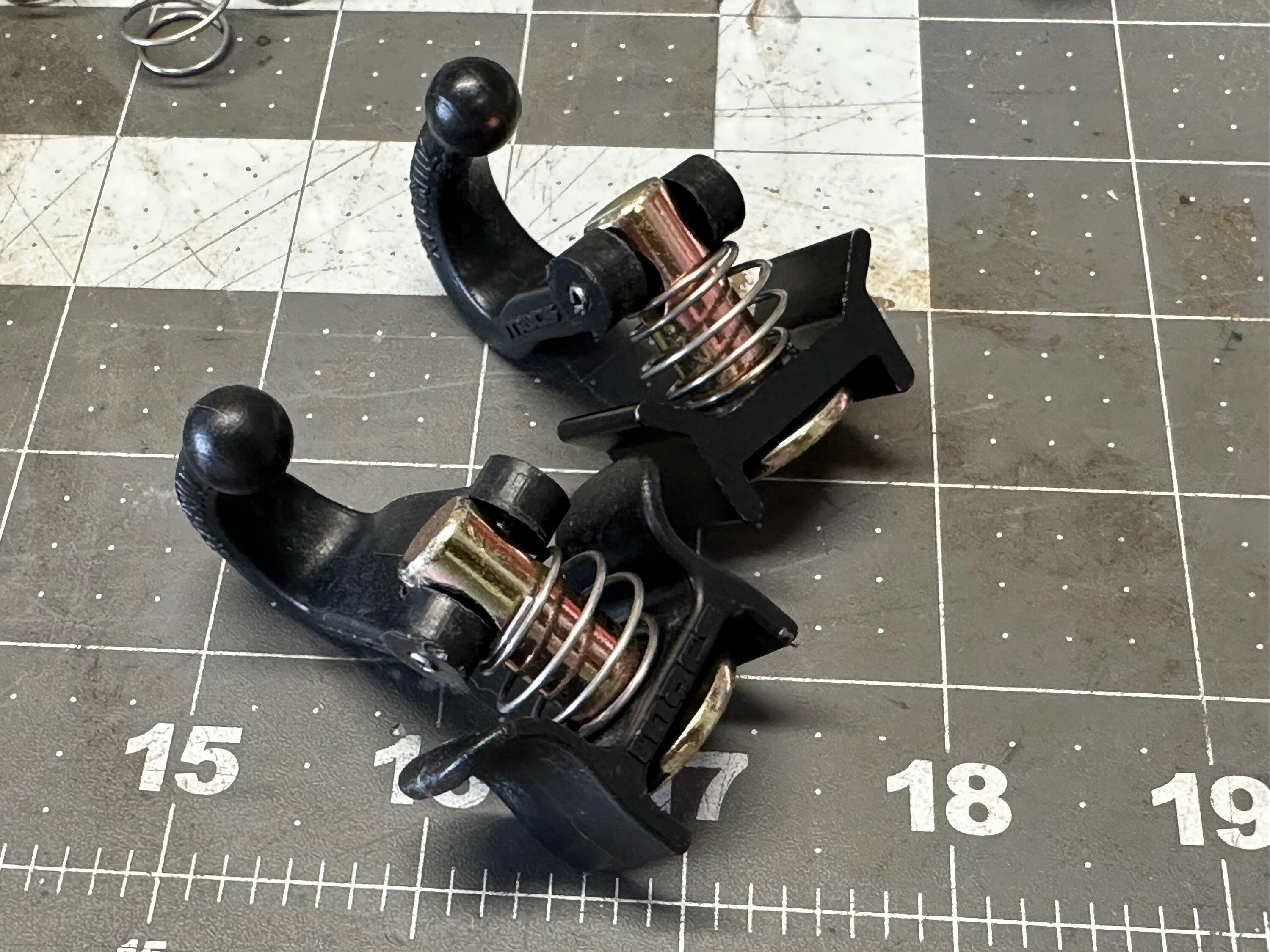

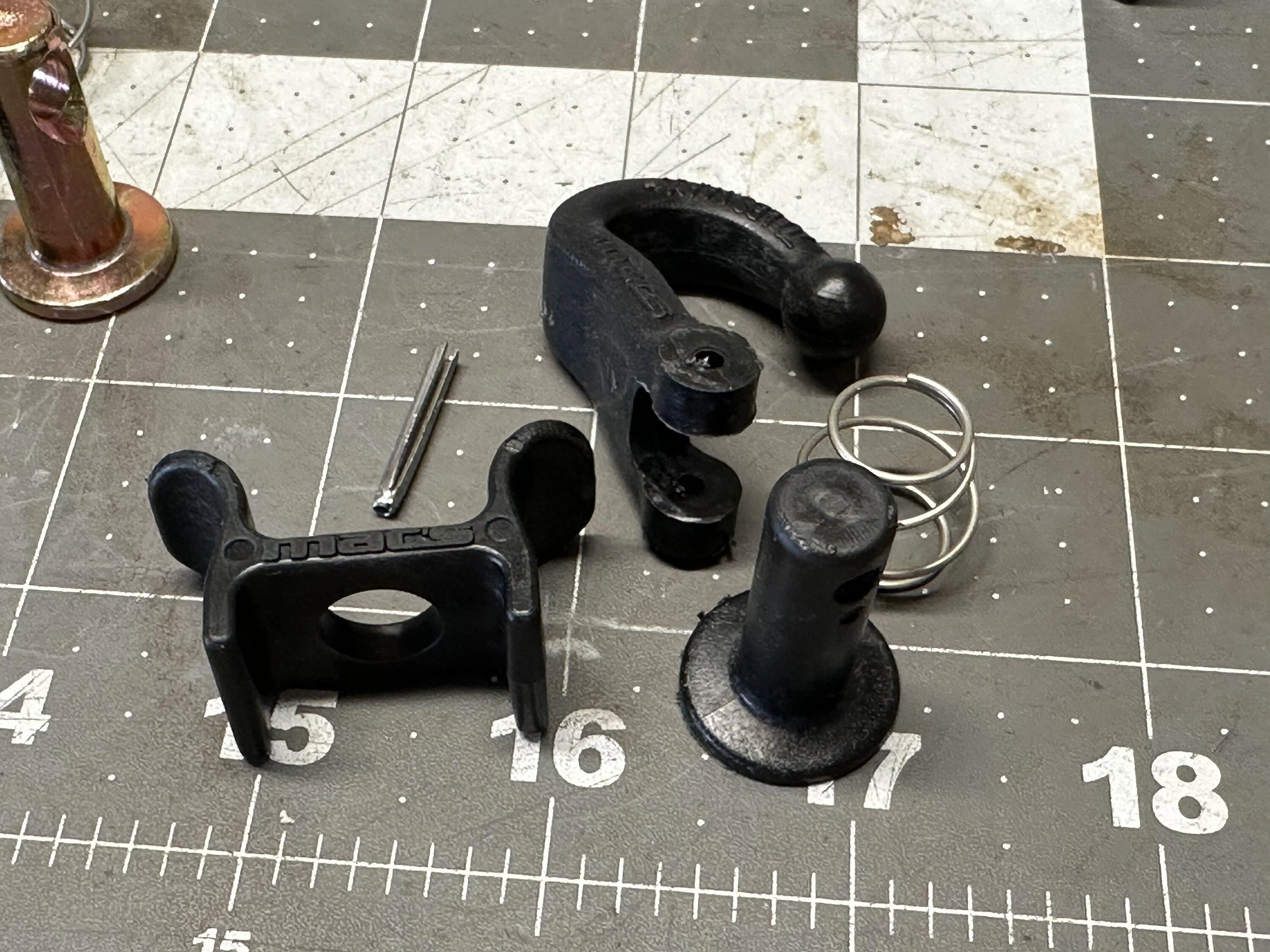

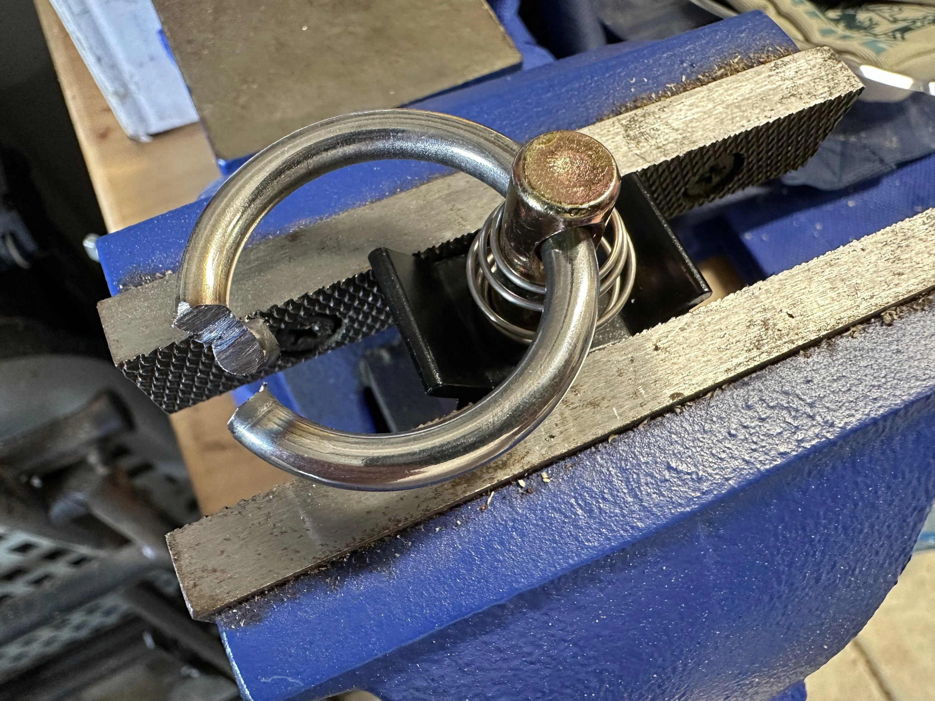

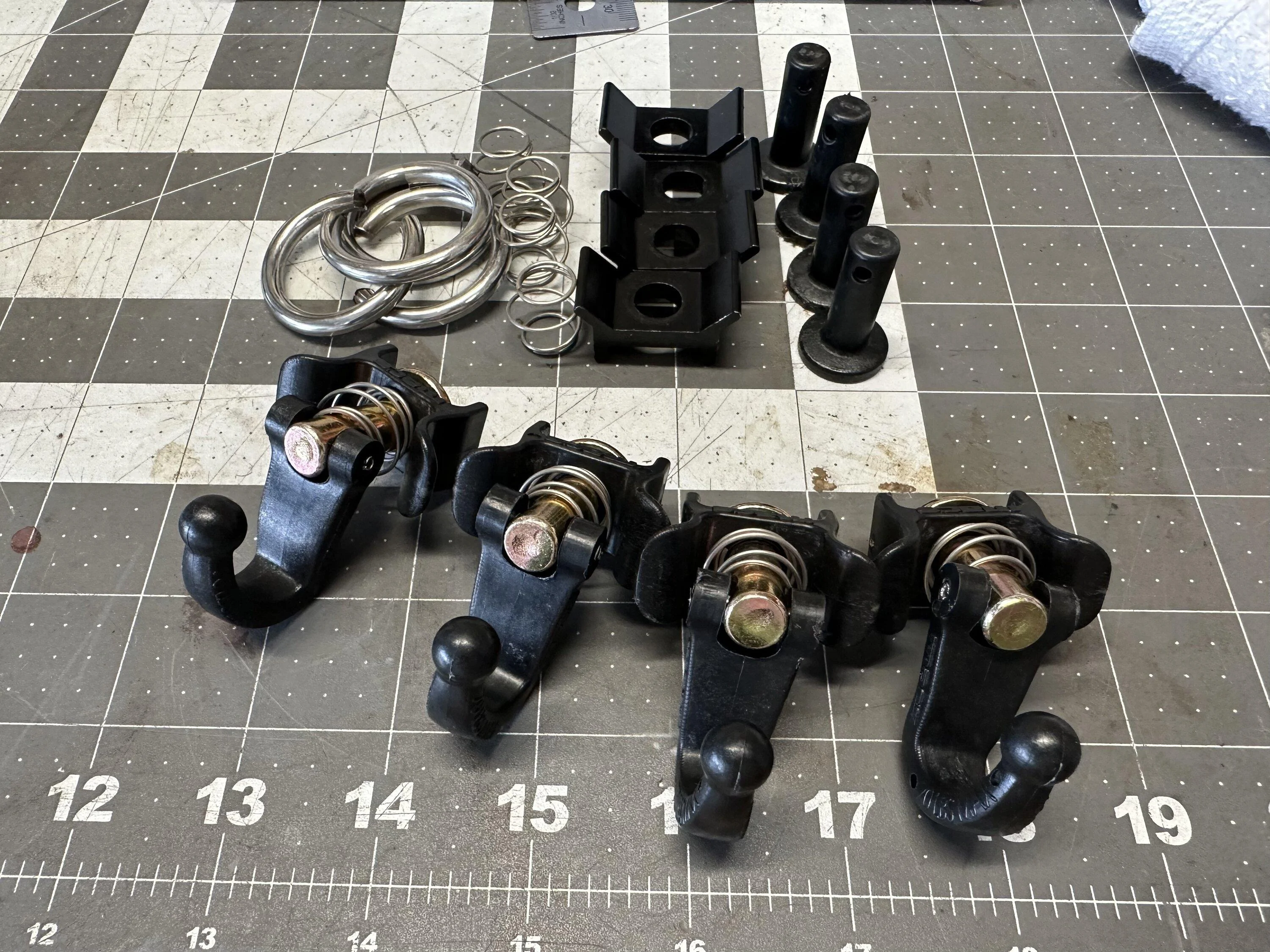

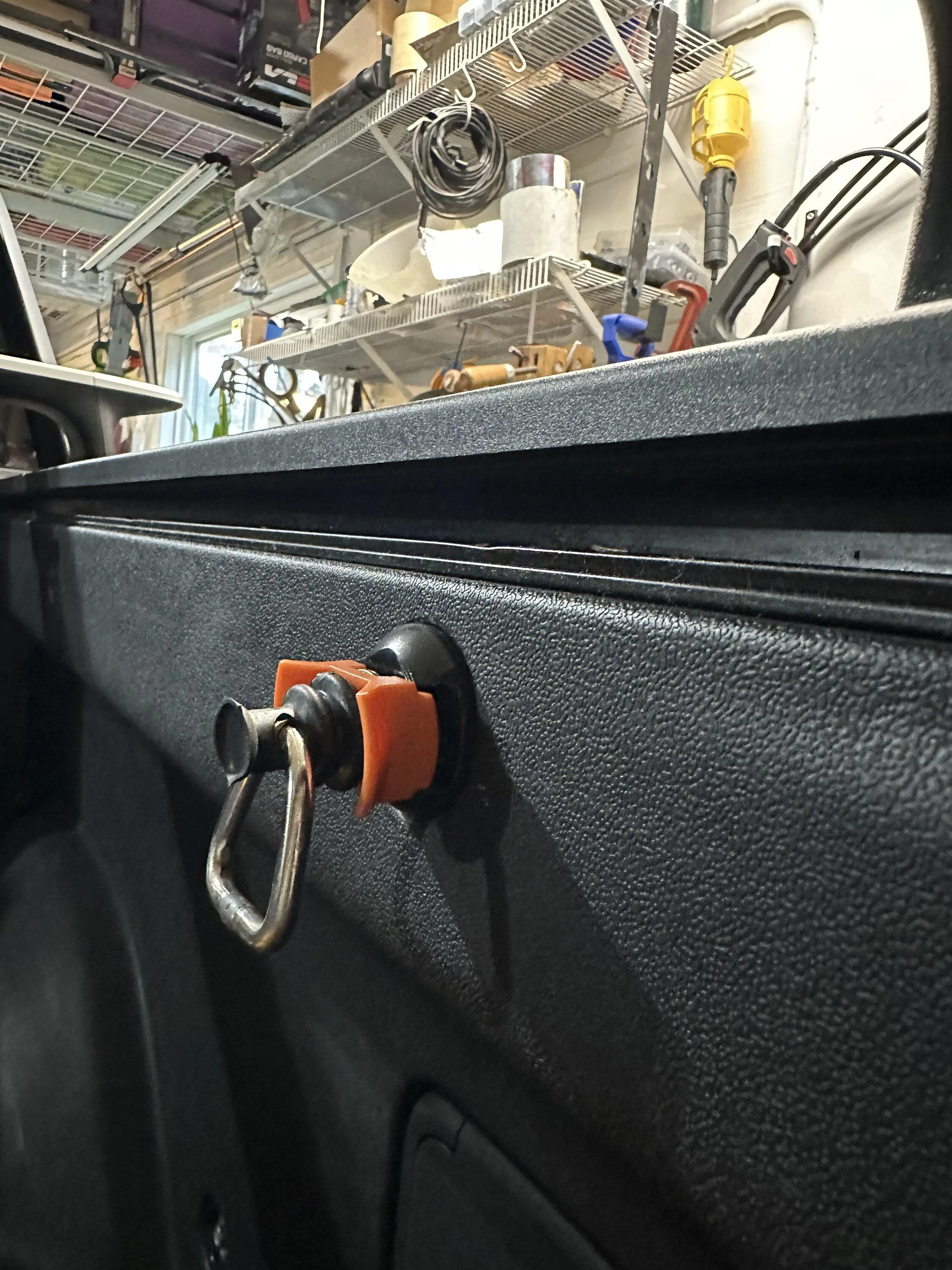

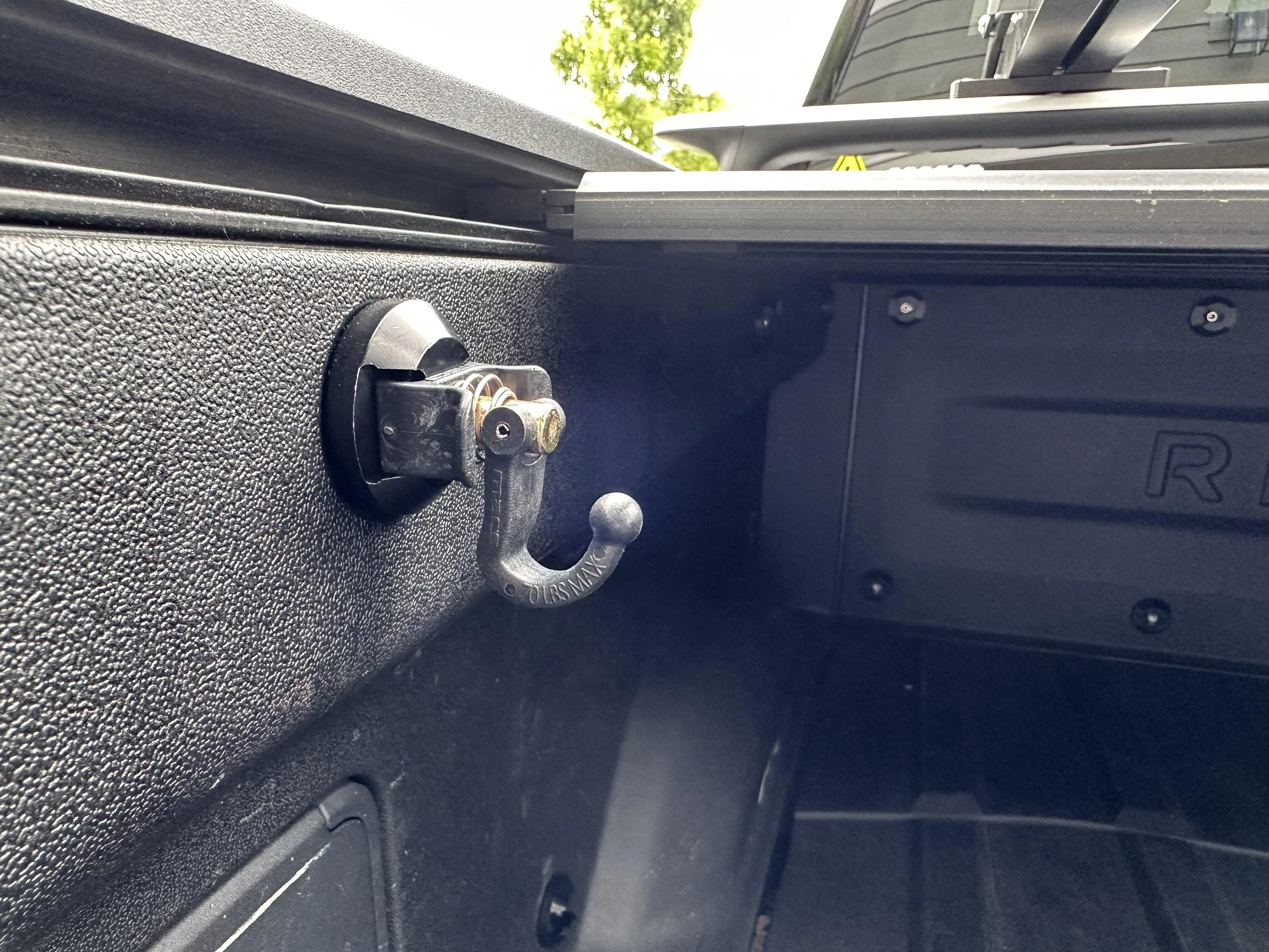

Okay, time to bring it full circle.
As suggested, I did some fabri-cobbling and made some frankenhooks. Overall, I consider the operation a success.
I originally thought it was excessive for EVSportline to include 16 fittings, but now that I've sacrified four of them, I'm glad they did.
I tried with both the aluminum extruded retainers from the EVSportline fittings as well as the plastic retainers from Mac's and found the Mac's design to be more comfortable and to have a better fit in the L-track. One change I may make, in the future, is the addition of a small-diameter washer between the spring and j-hook. But for now, this is a servicable solution.
Thanks, everyone, for your feedback and suggestions.

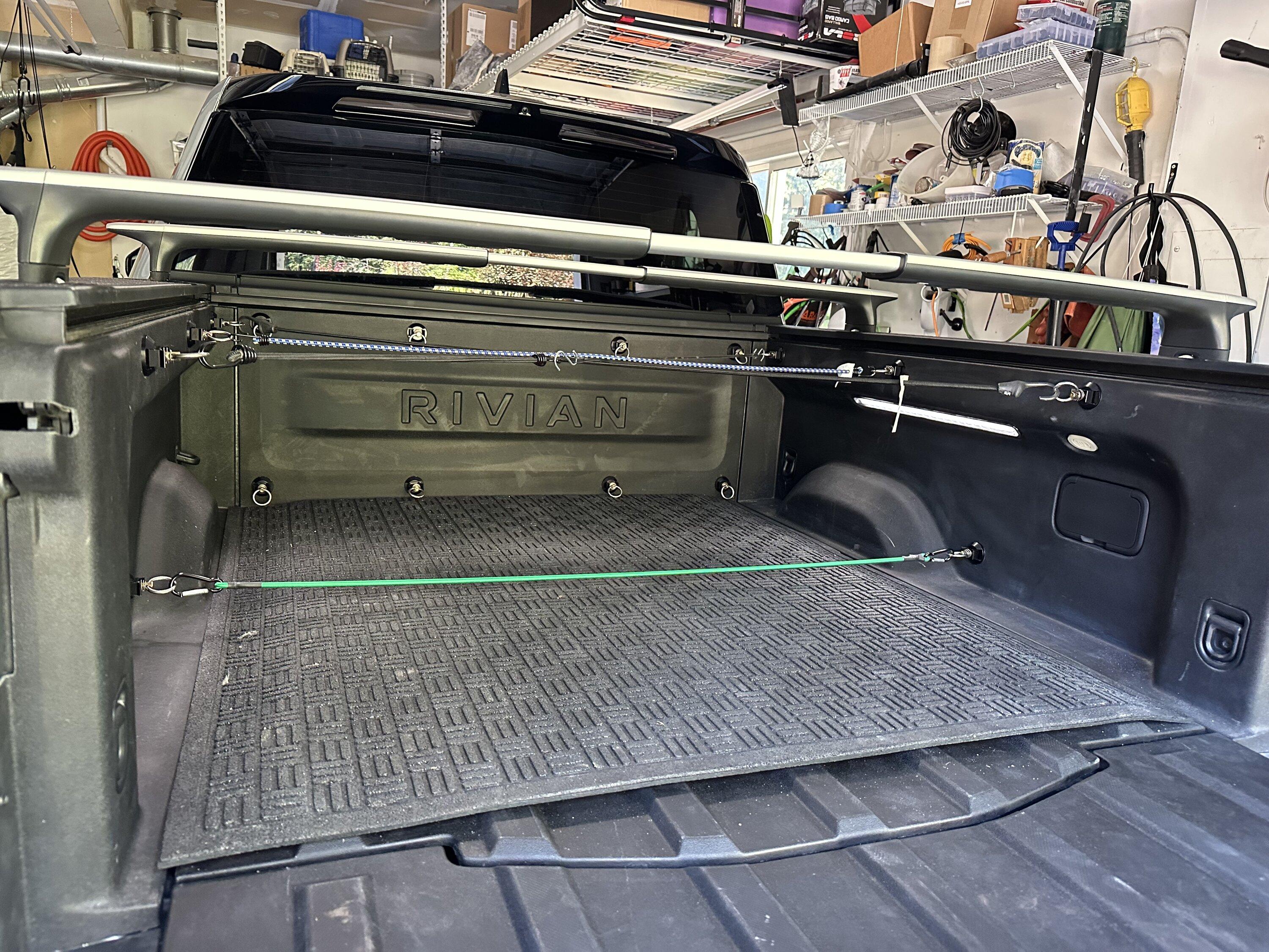

“My precious…”
Rivian R1T R1S JEBINC’s bitchin’ no rails tie downs mod! IMG_7836
Rivian R1T R1S JEBINC’s bitchin’ no rails tie downs mod! IMG_7835
Rivian R1T R1S JEBINC’s bitchin’ no rails tie downs mod! IMG_7834

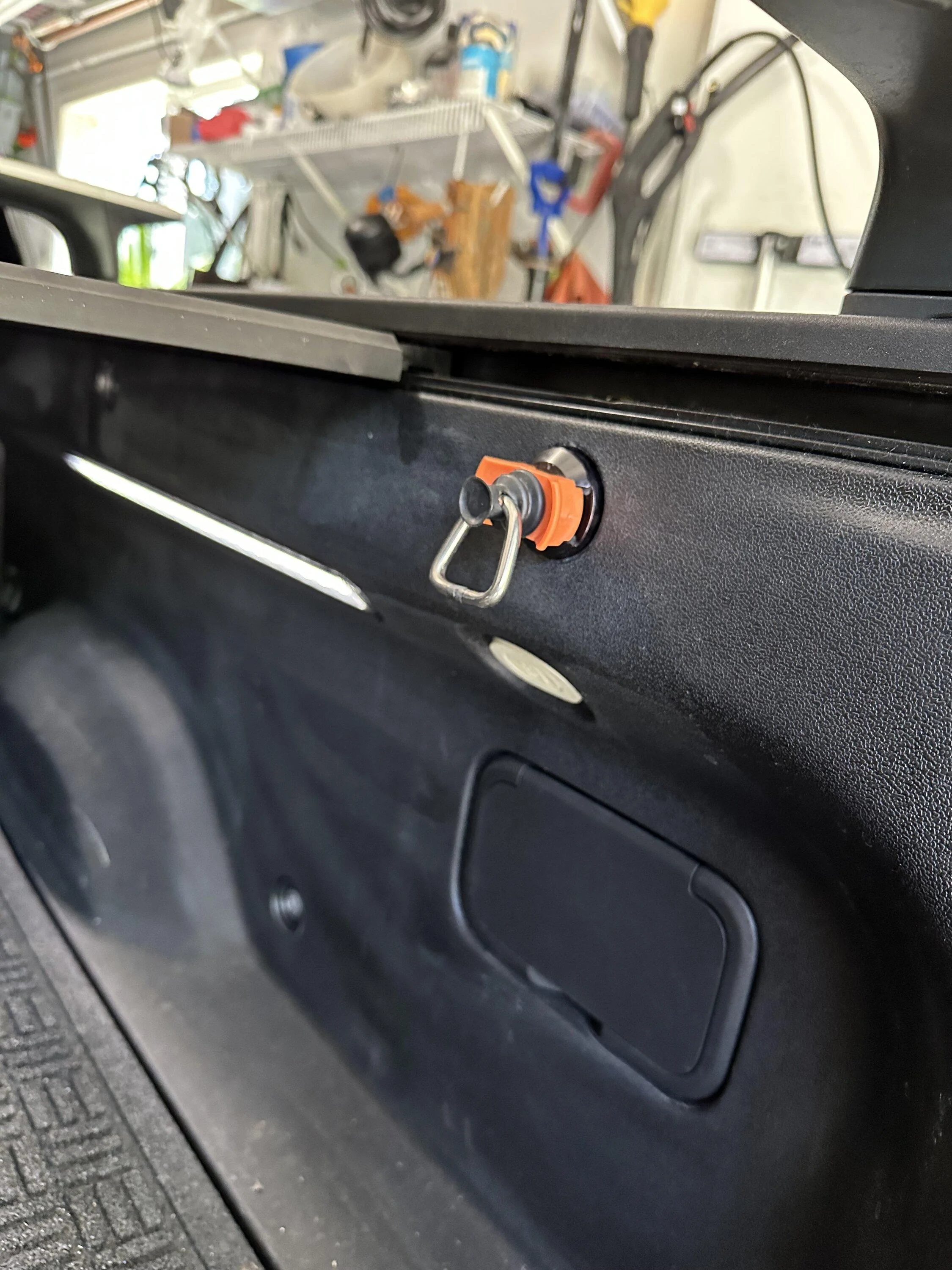

So , what do we think about doing when the mounting hole isn’t centered on the cutout of the plastic liner? Some of mine have been pretty good, but the alignment of others makes the mount sit too proud & crooked of the cutout in the plastic liner. Taking a hole saw to the line seems too extreme, an exacto not beefy/accurate enough. Maybe some Dremeling? Can’t wait for the melting plastic fumes…
Edit: I managed to get most of them to fit close enough on the back wall within my OCD tolerance by removing all eight bolts, allowing the plastic liner to move around a bit. Then I loosely attached each mount where I wanted it, then cranked it down.
I prolly could’ve done the same on the sides, but in order to free up the liner I would’ve needed to loosen up the torx securing the existing hooks, and I didn’t feel like going down to the basement AGAIN for another driver bit. :) So a couple of those exceeded my OCD, but that’s my own lazy *ss issue.

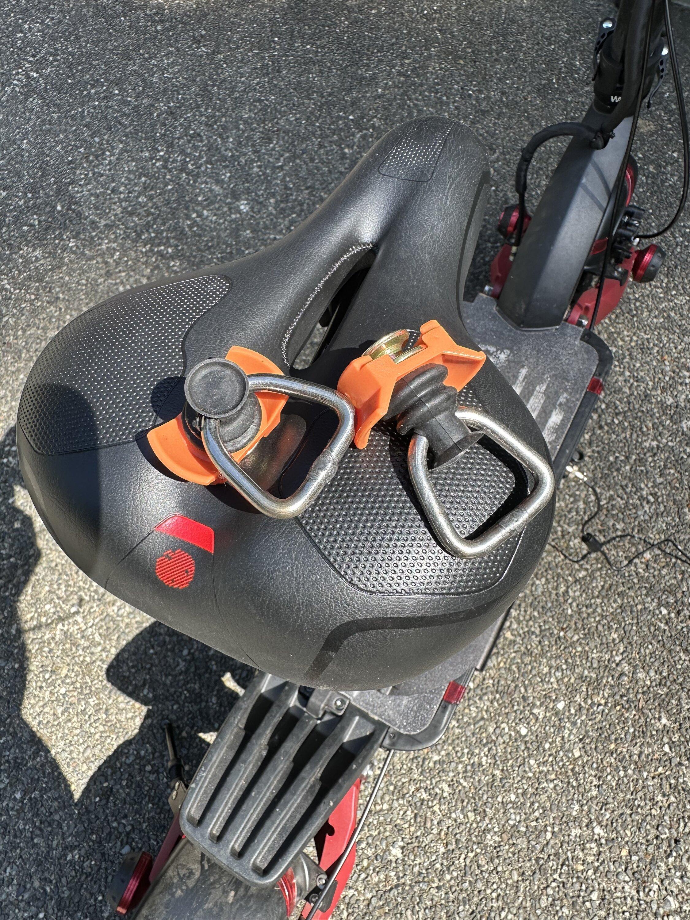

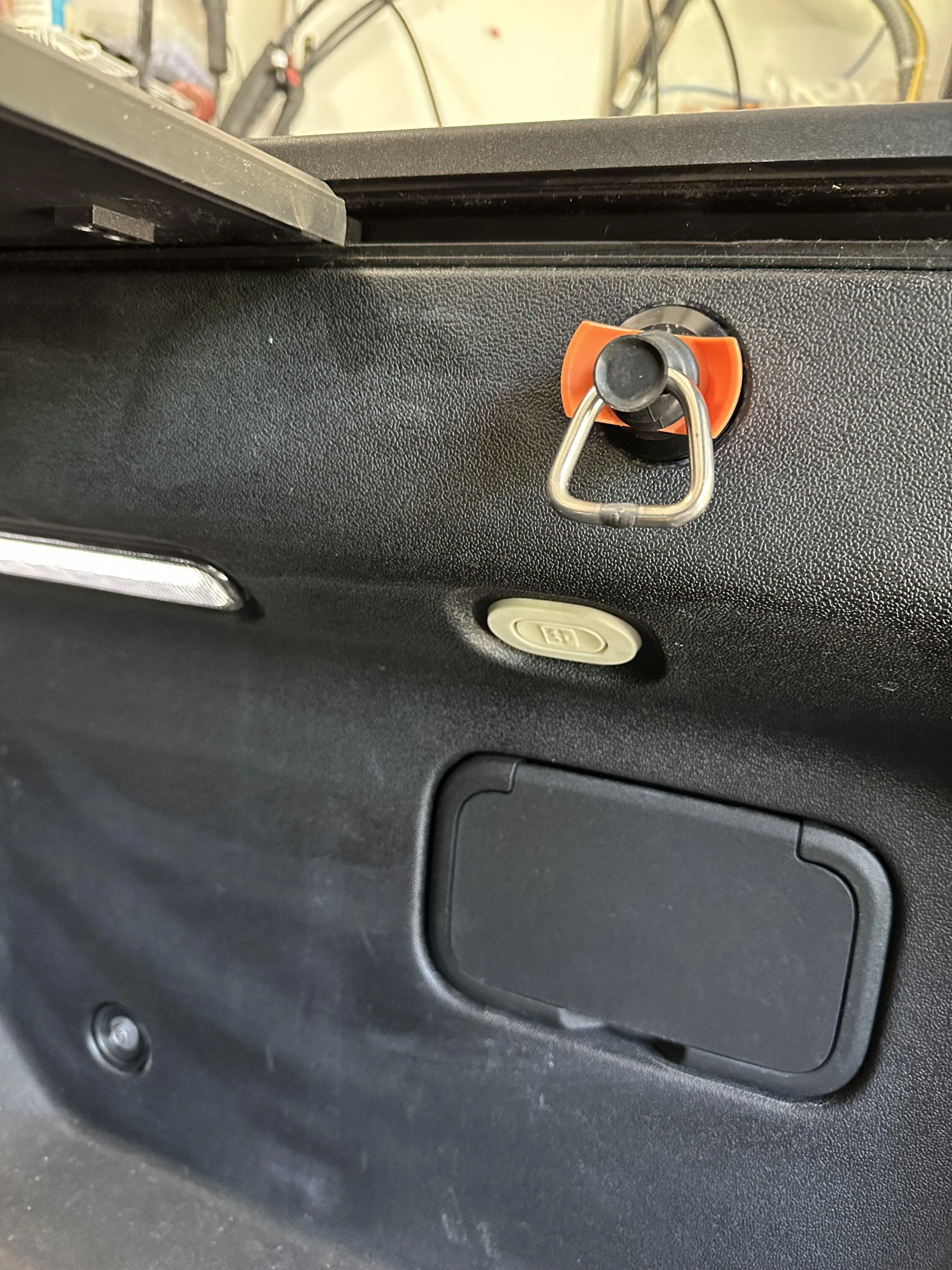

Playing around still…. :like:
Rivian R1T R1S JEBINC’s bitchin’ no rails tie downs mod! IMG_7893
Rivian R1T R1S JEBINC’s bitchin’ no rails tie downs mod! IMG_7892
