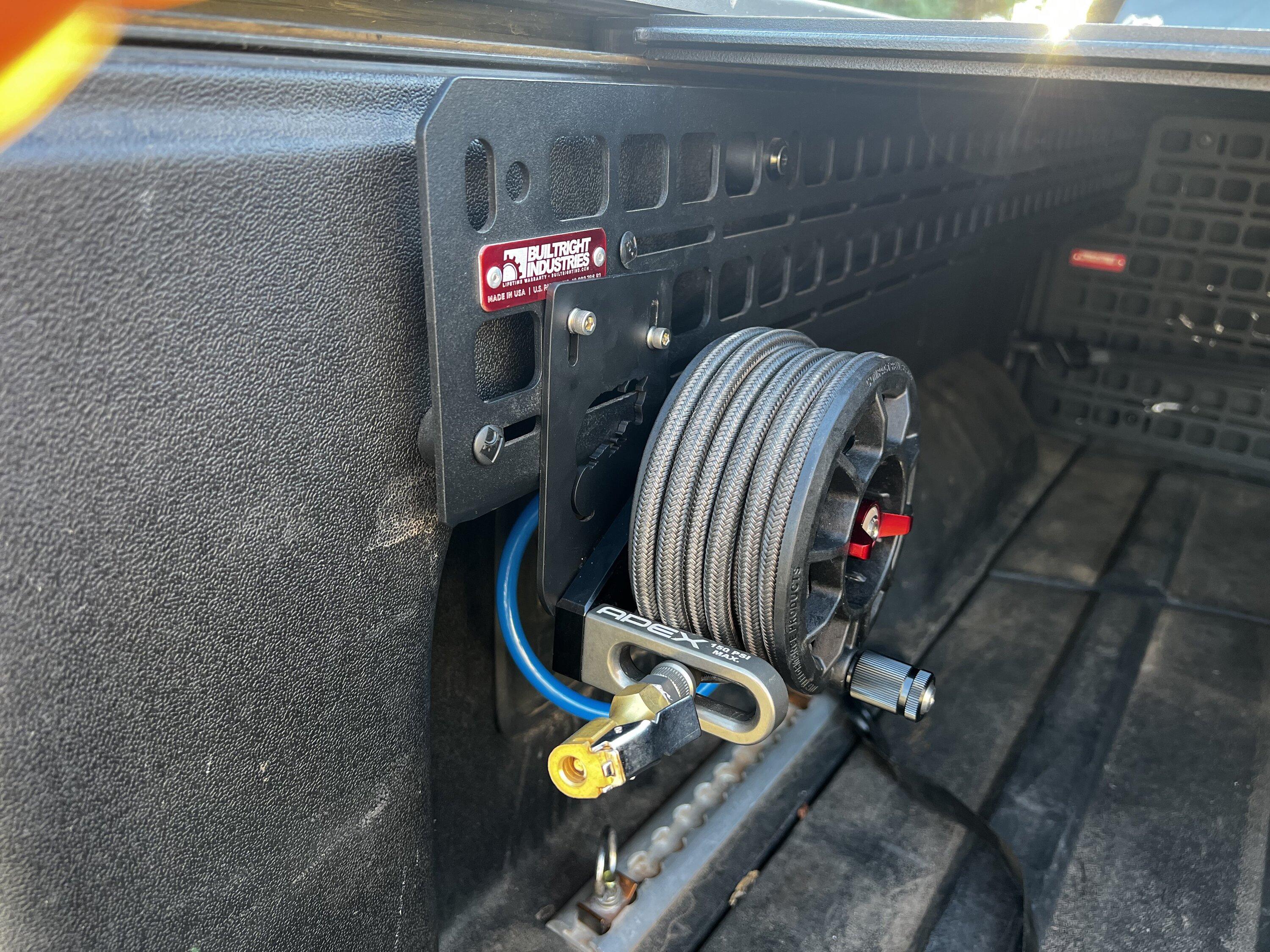

I added a builtright molle panel on the left side of the bed, and then bolted an Apex Offroad Compact Reel to it:

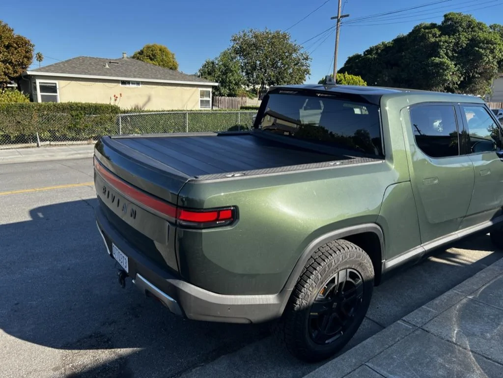

My interrobang tonneau cover came in:

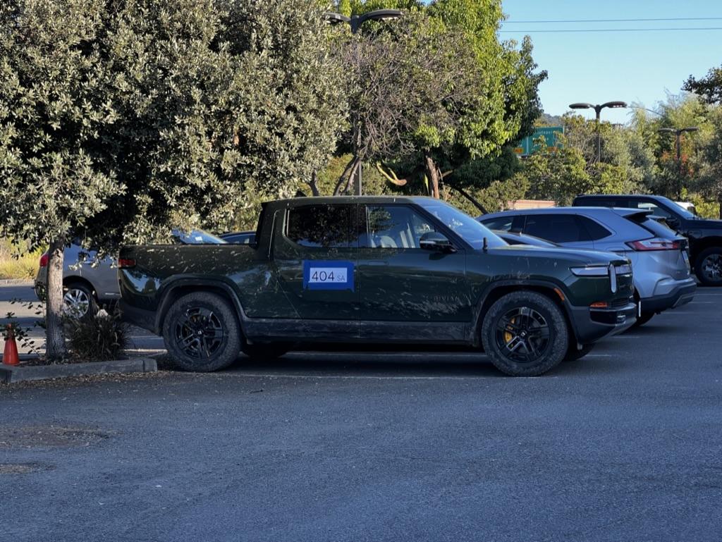

I got third in a rallycross:

So, I didn't like how my air reel was mounted. Having the fairlead pointed up wasn't the best for coiling it, speed, etc. Also, a bit of rallycrossing was all it took to wiggle it loose. Time for a proper bracket! A little bit of cardboard trimming, sharpie work, and CAD later...
I've got a pattern sent off the sendcutsend for laser cutting and powder coat, and will update here how the install goes!

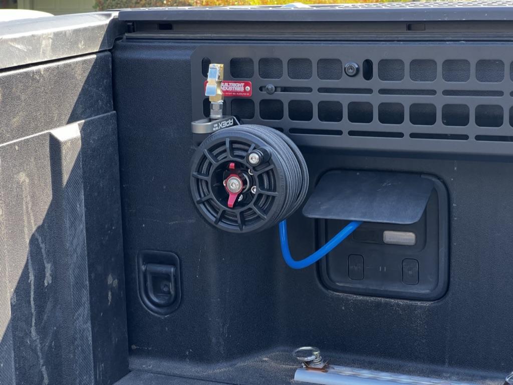

Air reel drop brackets are in! They fit just fine:
Rivian R1T R1S k3g's R1T build thread IMG_4863
Here's a DXF of the part. If you happen to want to put an air reel onto your truck using a builtright panel, upload this file to sendcutsend or oshcut. The one pictured is made of 0.125" (3.2mm) 5052 H32 aluminum, and I had them powdercoat it black.
Edit: Installing the air reel in this position means the spare tire door can't open very far. In my case that's fine, but be warned, getting the tire and wheel out with it barely open requires significant upper body strength.

I love your Air reel mod! I’m thinking of doing the same.
Questions:
Are the brackets being sold from Apex webpage not good enough? Also is the blue hose on the pics came with the reel order or is that a different brand?
You made a great point on the real location that it’s going to be harder to access the spare tire compartment. Have you tried other positions within that builtright molle panel?
Questions:
The universal bracket on their site would put the reel further out, and rotated 90 degrees. I preferred the upright position.
Regarding other places on the molle, no I haven't tried any others yet. I've thought about moving it to the front corner: I could access it by sliding my interrobang cover just one panel out. Someday I'd like a powered tonneau, but for now I'm fine with the location. Maybe I'll try the other location and see how easy it is to access.
The blue air hose is just some 3/8 ptfe with a push-to-connect fitting threaded into the reel, and a another ptc threaded into a air hose qd.

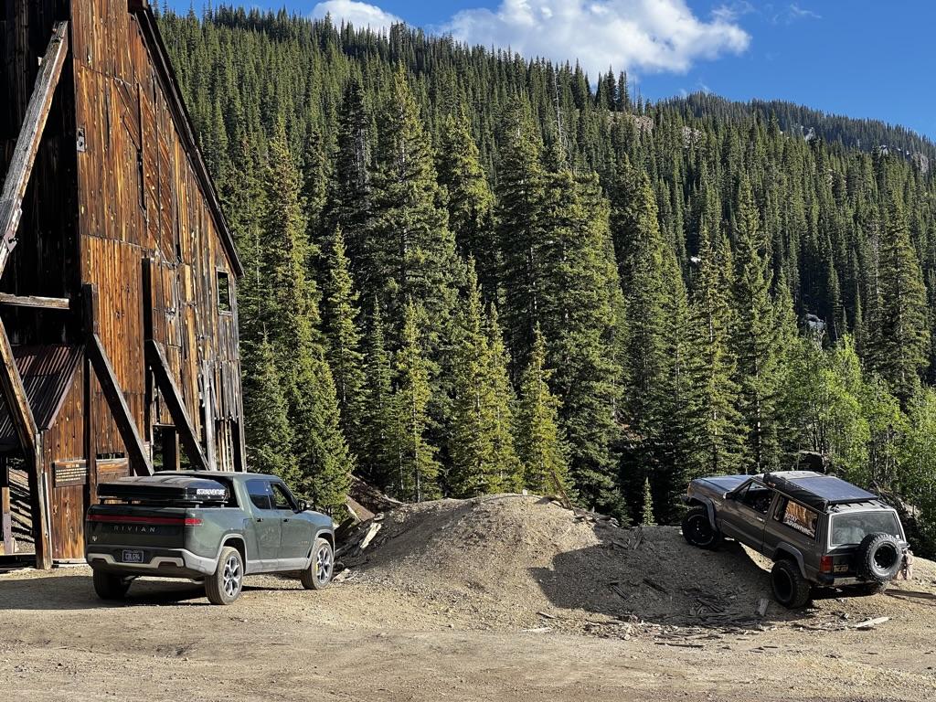

On a roadtrip from CA to the Pike's Peak Hillclimb race, my truck gave me a lot of issues. I didn't post much about it here, but our trip had so many wrenches thrown into it that we started steadily changing Rivian's "stay adventurous" thing into a somewhat sarcastic "Are YOU staying adventure?" every time some new twist came up. We made big decals of it and threw them on our stuff on the way back to make light of all the shenanigans like a truck failing to charge, a displaced rear axle in a tacoma, a failing wheelspeed sensor, a drone stuck in, and then shot down from a tree.
You can see the decals here, outside Ouray CO:
Rivian R1T R1S k3g's R1T build thread 0CF6F546-70C2-4ED2-B208-ADD27ACB63E4_1_105_c

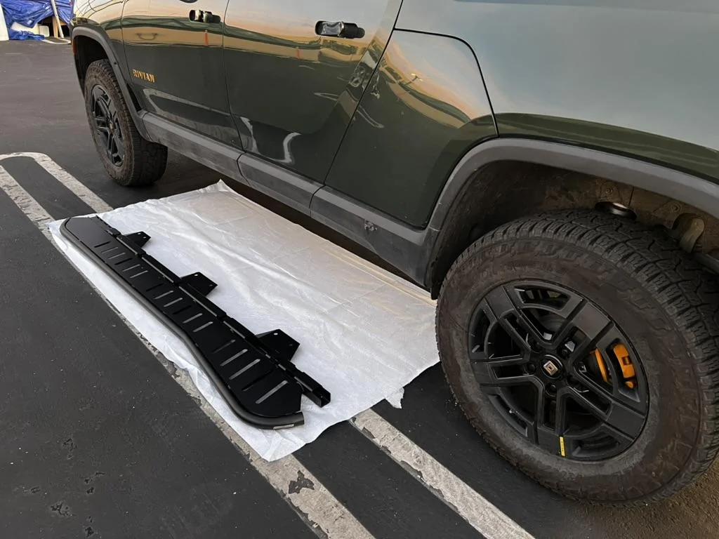

I ordered some Megawatt rock sliders a while back, and they've come in!
Rivian R1T R1S k3g's R1T build thread 24E847DA-6441-4138-8BEE-8F95E759DEFB_1_105_c
The install was super easy, there's great videos and instructions from Electruck4x4 on how to get them on the truck. I used my badlands jack to easily position the sliders while I worked on them.
Installed, they've got great wheel to wheel coverage, with nearly no clearance impact. I've had tough sliders on other trucks (bamf sliders on my taco, for example), and these are in the same league for sure. Really high quality welds, beefy steel components. Very good product, I recommend them.
Rivian R1T R1S k3g's R1T build thread DEC7EDED-F8EE-4964-90AC-BD64FB60753E_1_105_c
Rivian R1T R1S k3g's R1T build thread E041F4C0-4524-4F7D-9AD6-96055F758E49_1_105_c
