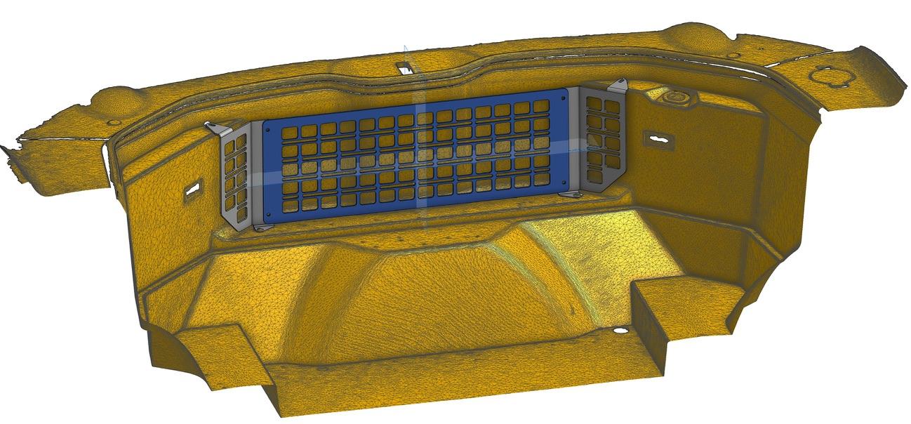

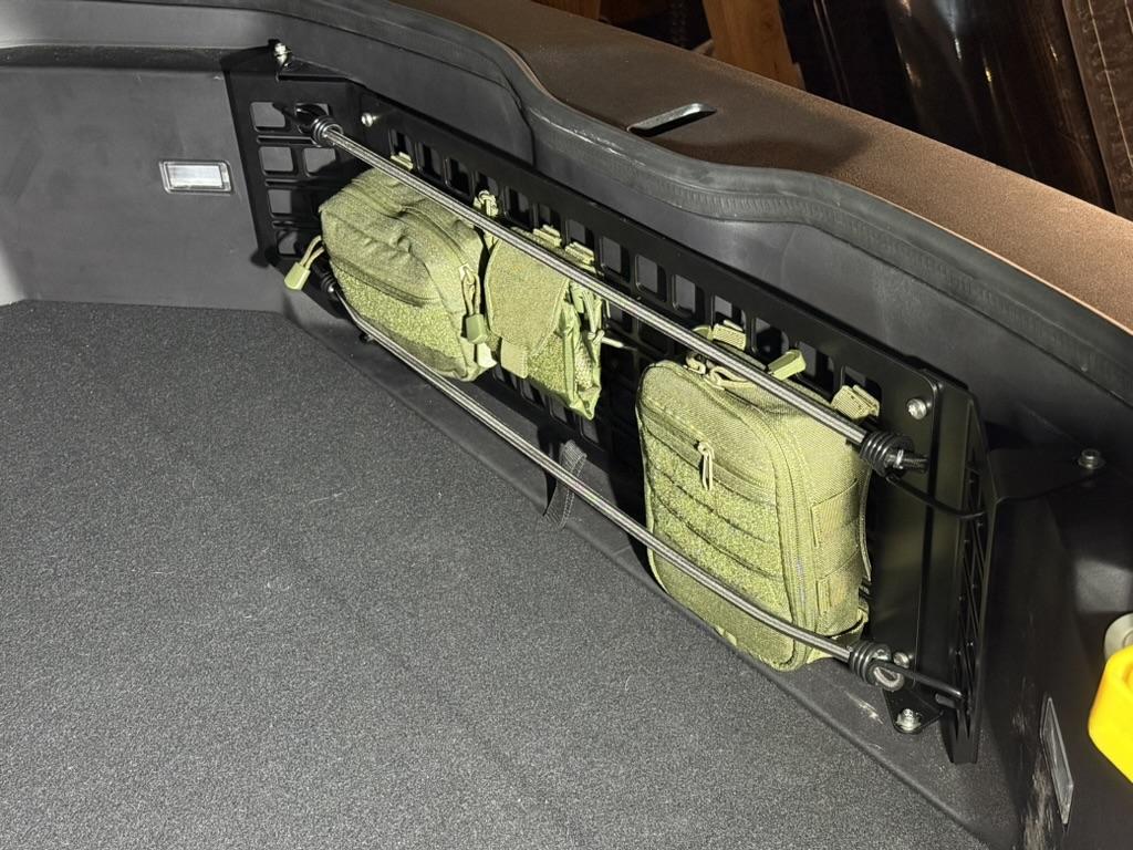

Now, this is a build thread, so here's a new thing I built! I liked the idea of the bungee net in the frunk, but the execution left a bit to be desired. Nothing a 3D scan can't solve...
Rivian R1T R1S k3g's R1T build thread 27053B6C-982D-4D7C-AA00-32149EA3B3B3_1_105_c

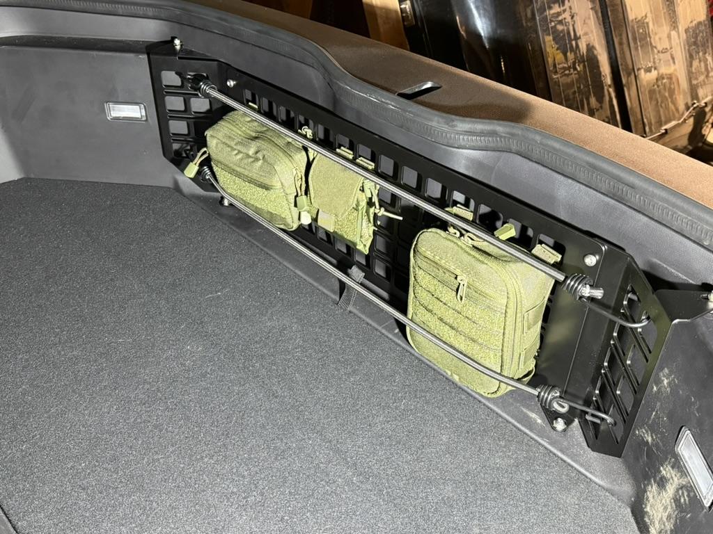

This one turned out even better than I expected.
Rivian R1T R1S k3g's R1T build thread 77C74AD5-1844-432C-ADC3-E4D7DF2A87BD_1_105_c
It's three pieces of laser cut 5052, black powder coat, with stainless steel PEM nuts pressed into the outer pieces. The corners clear the false floor nicely when you're folding it up. It holds bungee cords too, to hold a single object in place when you're dabbling in sport mode on the way to the local pot luck.
I've got three organizer pouches on it so far, one for my NACS adapter, one with pens/allen wrenches/tire pressure gauge/other bullshit like that. The middle is a dump pouch. My thinking there is it's an easy collapsible bag for muddy shoes or something else.

Two questions:
1: who made the fog light film on your previous truck? it looks more amber than what twraps offers.
2: how can i buy a frunk molle panel? ?
Fiarly certain it's this, just cut to size. There was a similar post ages ago with an owner opting for the orange film over the TWraps yellow. I keep contemplating the swap from amber to orange. Significantly easier as well as I can just cut them to match my old TWraps film once removed.

Two questions:
If you’re interested, another option for bungee cords is https://thebetterbungee.com/
Really wish Rivian had installed the same track system in the frunk that is in the cargo area of the r1s.
It’s Laminex Orange film, comes in square sheets that you cut to size.
For the second question, there will be more news on that front s00n.
Anything on this yet? Would be a huge help to have this panel to get some of the crap I have in the frunk to stop rattling around.

In other news, I've started to find ways to share my designs, while ensuring the parts get built right. Enter sendcutsend, and their new marketplace. Turns out you can list parts that SCS can make, and let people just click once to order stuff you've made. The people that upload designs still own the design, which I also think is cool. Here's the garmin powerswitch bracket I designed, and here's the frunk MOLLE panel. What's missing is installation instructions for the frunk MOLLE panel, so here goes on that:
Tools/parts needed:
- a gen1 Rivian. This doesn't work for gen2, like _at all_.
- Automotive interior panel pry bar
- riv-nut installation tool. Harbor freight has options, and youtube is great to learn to use one. Practice on something else first if you have doubts, it's easy though.
- 4x M6 Riv-nuts
- 4x M6 stainless pan-head screws in gods own fastener drive: torx. I like these.
- Torx bit to drive the above screw, or bit to drive your fastener of choice.
- 2x M6 spacers or other standoffs to total ~6mm per side, stacked washers are totally cool too here.
1. Open the frunk and remove the cargo net from the four little pegs it loops onto. Set it aside, you don't need it anymore.
2. Use a prybar (definitely _don't_ use that big flat head you're going to reach for, go get a real pry tool for automotive interior work, they're cheap on bezos-mart) to pop the four pegs that used to hold the cargo net out of the frunk tub. They're pressed into a metal part, so don't worry about being decently forceful. Just pop those suckers out.
3. Once removed, install a riv-nut of appropriate size (I used M6) into the square hole in the metal you just exposed.
4. Placing a spacer between the upper panel mount holes and the frunk, bolt the two outer sections of the panel into the frunk.
5. Bolt the center section of the panel to the outer two using 4x M6 bolts. Use blue loctite, but don't go blueman group on that poor bolt. Littledab'l'do-ya.
6. Enjoy having the sickest Frunk in the trader joe's parking lot.
