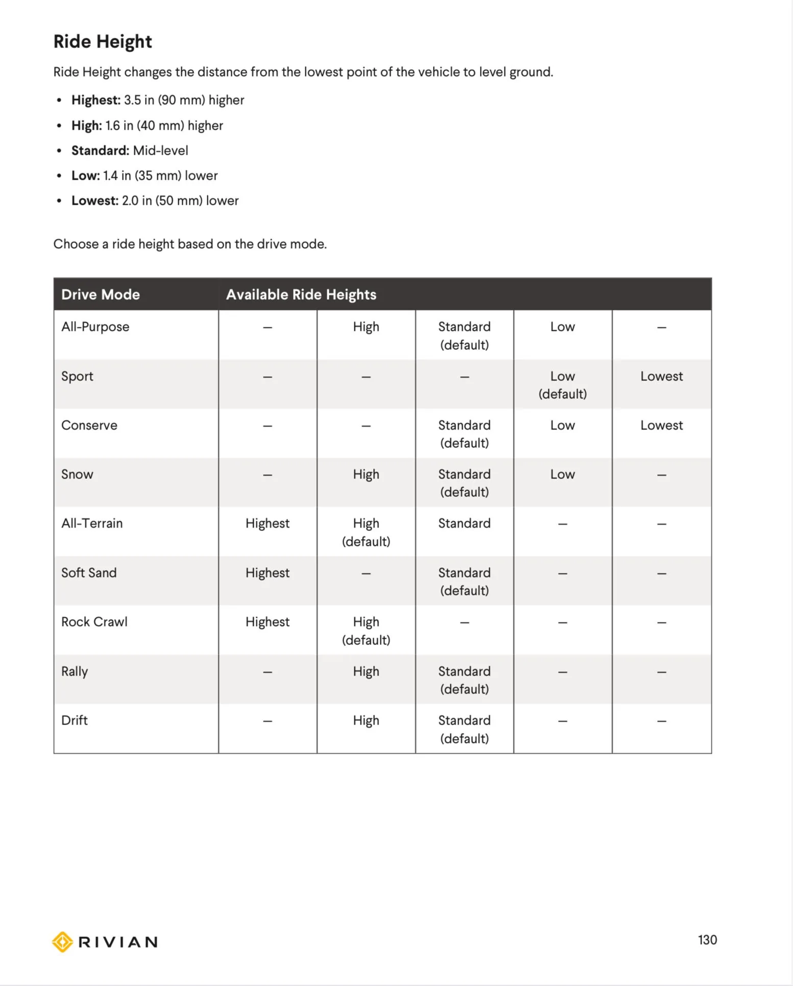

So “sport mode” is just the lowest setting under standard (press the down button all the way)? or does it actually make the suspension and handling stiffer/different?
Anyone know what the height in inches is for sport, normal or high and kneel?
Kneel is equal to low ride height, lowest is .6 inches below that, I verified on my R1S with a tape measure as a lot of the time I will put it in sport lowest for the pups to jump in and out.

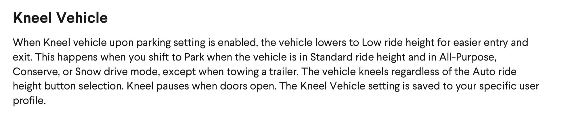

I wont keep the Rivian past the warranty, so I use kneel.
It may be totally fine. I am sure Rivian tested the air suspension to longevity. Its just my personal preference to avoid constant adjustments.
I had been driving around in low rather than auto for months because it made entry and egress easier (this was before kneel mode). Then I red somewhere (here or reddit) that low and lowest cause a slight toe in on the front wheels and could be responsible for some of the tire wear issues people have reported. Now I drive on standard and sometimes use kneel.

I stopped using the kneel mode worrying about shortening the life of suspension.
A 2nd thought nowadays, maybe I should keep using it because if it's going to fail, I want it to fail before the warranty ends (hopefully all 4) and ensure I have a long way to go after the the warranty.
kinda silly thinking .. but not too bad thinking ..?
That has been exactly my thought process as well lol.

Maybe this was already factored in, but the air suspension is adjusted quite frequently without kneel mode (with normal use and driving). In colder weather, many experience an increase in the adjustments. Extrapolate any additional adjustments with kneel mode for concerns. However, some have stated that the the number of adjustments may be similar with kneel mode on or off, but the volume of air and pump usage is most likely larger depending on ride height and other factors with kneel mode enabled.

If you use the auto ride height feature, having the kneel mode enable won’t stress the suspension more in any noticeable degree.

Been using it for 8 days since I got the R1T. It’s fantastic for short wife and little kids. Don’t be afraid to use the features, there is a warranty for a reason.
This is actually a great point…no reason to go extra easy on it so it outlasts the warranty and then (potentially) fails…

I've used kneel mode and auto ride height since day one, if it's going to break or have issues I want them to appear while it's under warranty.
