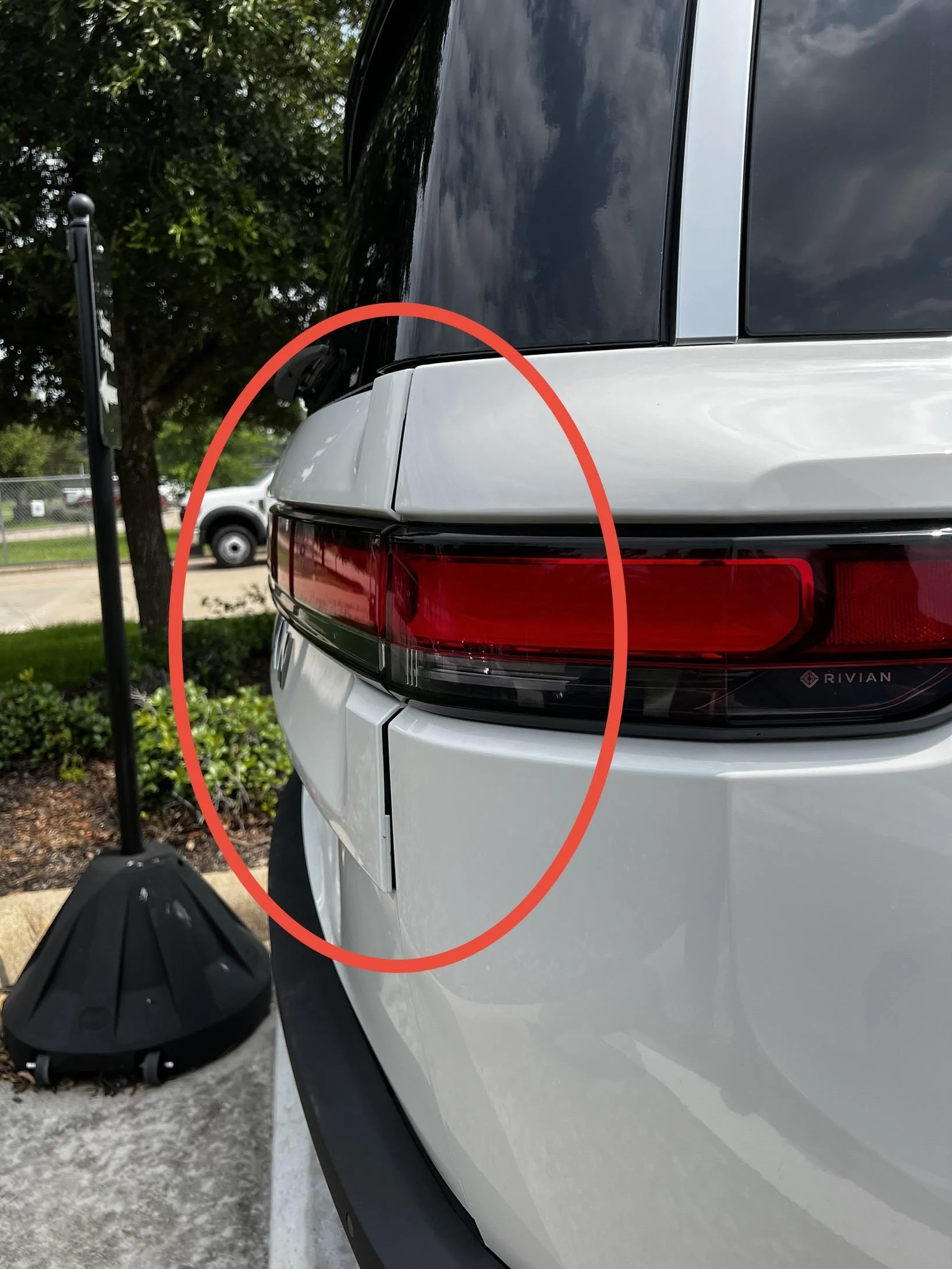

  • Rear tailgate does not close far enough and the top half sticks out way too far from the body panels. Delivery agent agreed.

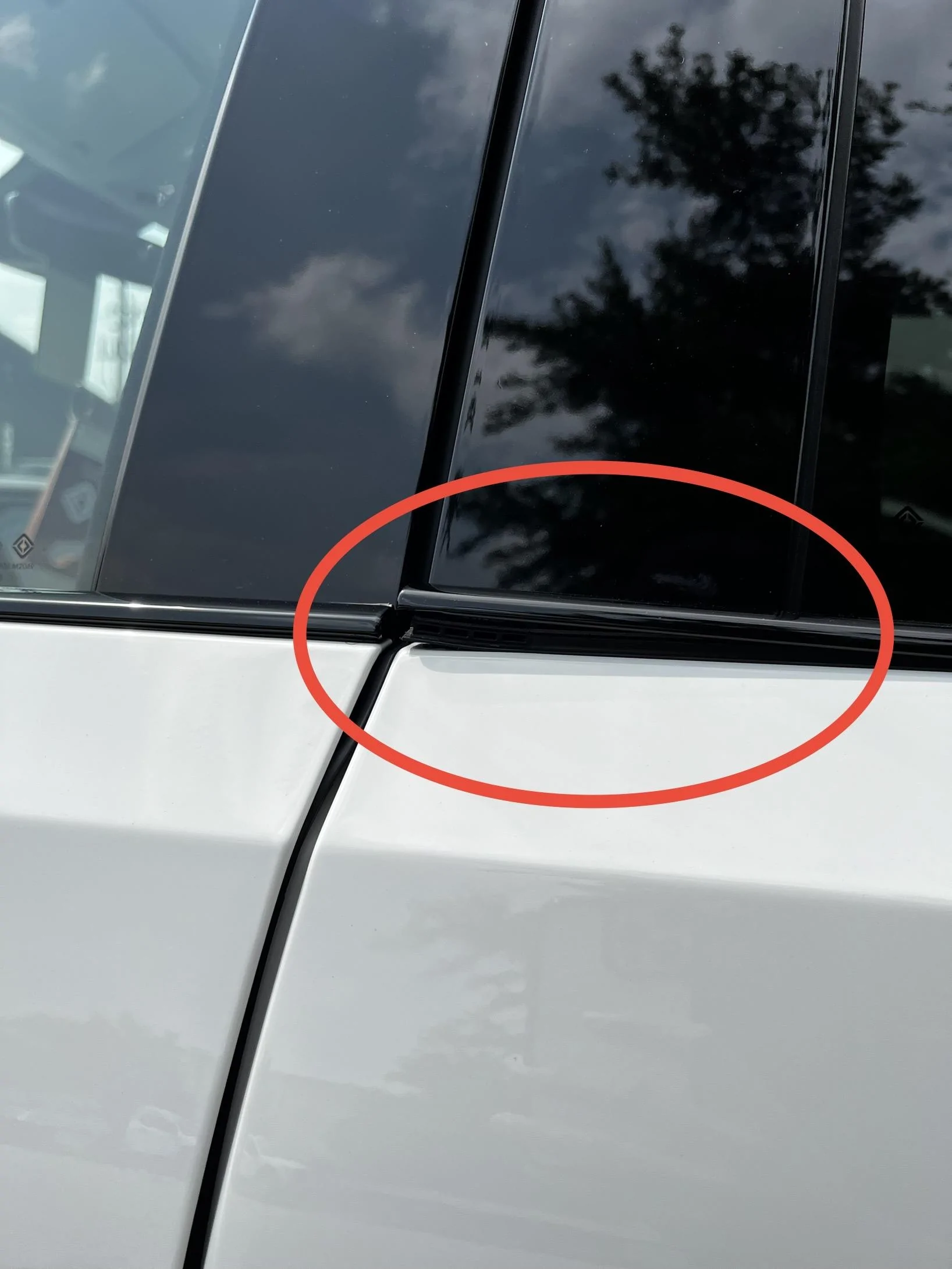

  • Drivers side rear door had the black trim lifting near the front. Deliver Agent said they would take care of it
Like this? The SC basically told me that's normal and they can't do anything about it (Im VIN 82xx). Currently at the SC to get paint corrected, but the '22 loaner I have now looks like it was built by a 10 year old (complete with mismatched wheels) so comparatively it appears they're slowly improving!

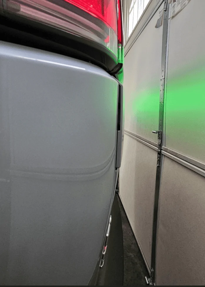

LIke this. Seems like the latch catch needs to be moved back a bit.

I have the same lift gate sticking out thing. Along with several other panel items, interior rattling, etc. Its at service center now, been there a wk.

I didn't have that trim problem with my 38xx R1S build but I did have the liftgate issue (seems more do than don't). The trim issue should be an easy fix and, in my case, the liftgate/tailgate were also easily adjusted to my satisfaction within a matter of hours.
