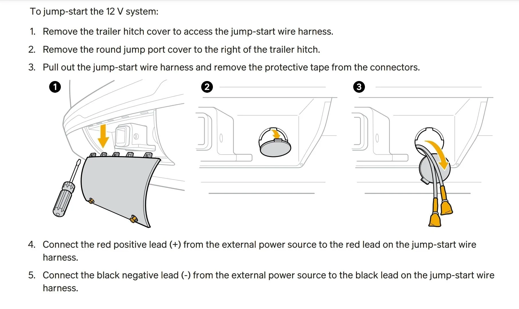

mkhuffman
Nov 9, 2020
3,047
3,474
Virginia
We don't have to guess. We have an owner's manual:
A 12 V system jump start provides power to:
l Open the doors and front trunk to remove your belongings.​
l Open the charge port door if you need to charge the high-voltage battery.​
l Release the electronic park brake from the center display if you need to transport the vehicle.​
On model year 2025 vehicles, a 12 V system jump start also provides power to:
l Adjust the front seats.​
l Open or close the front windows.​
l Access all storage areas.​
Rivian R1T R1S Learned more Rivian Gen 2 tech updates / differences to Gen 1 1000011483
Looks really easy, in fact. Much easier than my Mach-e. This is a huge plus.
The manual does not appear to include the process for replacing the 12V battery. Taking the seat out to do it will be a PIA. The 12V battery is under the passenger seat in my Jeep GC as well, but videos show it can be removed by moving the seat all the way forward. Rivian should have done it that way also.

Doesn't a dead 12v often prevent access to the vehicle? At least in Gen 1 you can still attempt to "jump" it to unlock and get your stuff out.
I'm guessing there are jump leads in the frunk somewhere and a manual way to open the frunk if the 12v is dead.
mpshizzle
Jun 16, 2024
76
1,307
2,184
Utah
2025 R1S Dual Max (Baymax)
They confirmed that there are jump points both in the back bumper, where they were in gen 1, as well as another set of jump points in the frunk where the battery used to be
