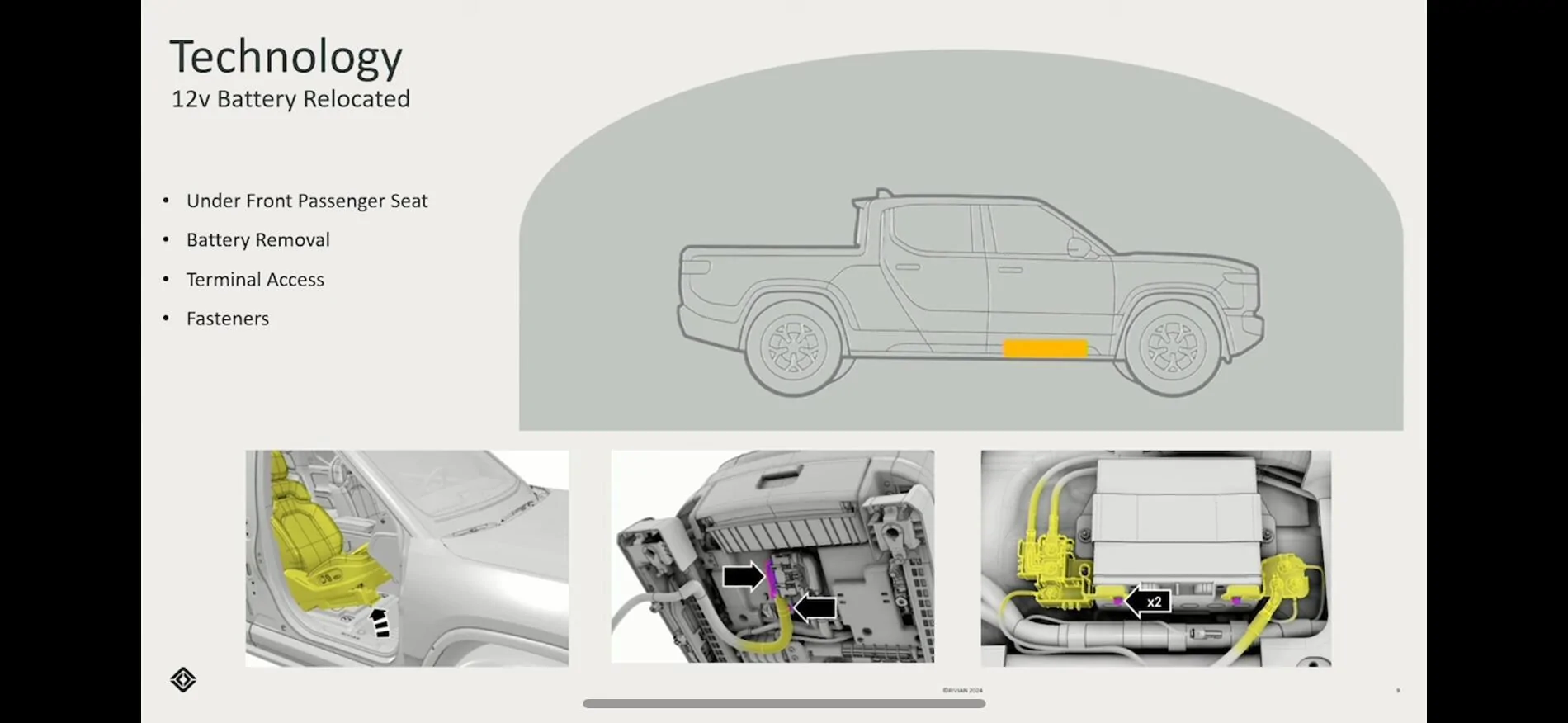

How common is a catastrophic short? Personally I am concerned about the battery wearing out and then needing to get into the truck to take care of it.

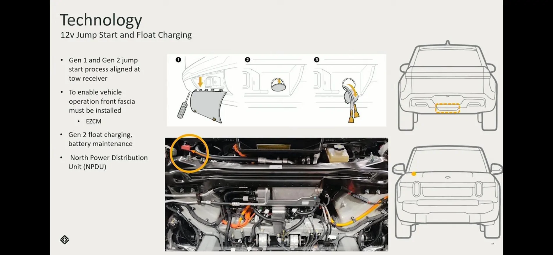

When my 8 month old R1S 12V failed, jumping it only resulted in the driver side door handles popping out, so it must have been a short which at least wasn't a huge problem for the SC since the frunk release was accessible via the driver-side wheel well panel removal.
Having to remove the passenger seat for a 12V swap would be asinine, so I'll give the Rivian engineers the benefit of doubt and assume they've got a simpler solution in mind.

If the jump process doesn't work then you've got much bigger issues to worry about than a broken window.
How is that the case with a proper design, though?
On a gen 1 if the jump process doesn’t work you can use the manual release in the fender area to open the frunk and then replace the battery (or batteries on the early ones).
If there really is no work around short of breaking a window on a gen 2 when the jump process doesn’t work then you have a battery to replace, a bunch of glass to clean up, and a window to replace. The cleanup and window replacement would probably more than double the work involved.

On model year 2025 vehicles, a 12 V system jump start also provides power to:
l Adjust the front seats.​
l Open or close the front windows.​
l Access all storage areas.​
Waiting for someone to test this by disconnecting the battery and see if you can open the windows with 12V hooked to the jump points.

seat goes all the way forward and battery goes right in
That would have been the right way to design it.
But if you watch the video, they said you need to *remove the seat*...

I agree. If replacement is planned should be no big deal. But it would really be nice now if Rivian would explain how to get into a bricked G2 with a shorted 12v battery located in the interior under the driver's eat.
What's all this talk of a shorted battery? If the battery drops below a certain voltage it can be jumped. Shorted batteries are usually sitting around for months or years with no charge. Even if a Gen2 battery somehow shorted wouldn't putting 12v on the jump start terminals allow the doors to be opened.
Shorted batteries do happen. I don't know frequency but I personally have had one short in a pretty new vehicle.
I believe if the battery has shorted you would not be able to jump start the terminals. The short would cause a short on the 12v system so attempting to jump start it would be impossible.
Rivian should have done two things better....one...locate 12v battery where it can be more easily accessed...and two....put a physical key into the fobs....I know with PAAK most don't carry the physical key....but at least having the option means the owner can get in the truck with a 12v short type failure.

Great video. Can someone explain a couple things on the screen shots below from the 12v portion of the video.
what is meant by “ front facia must be installed”? What is EZCM? What is “North power distribution unit”?
