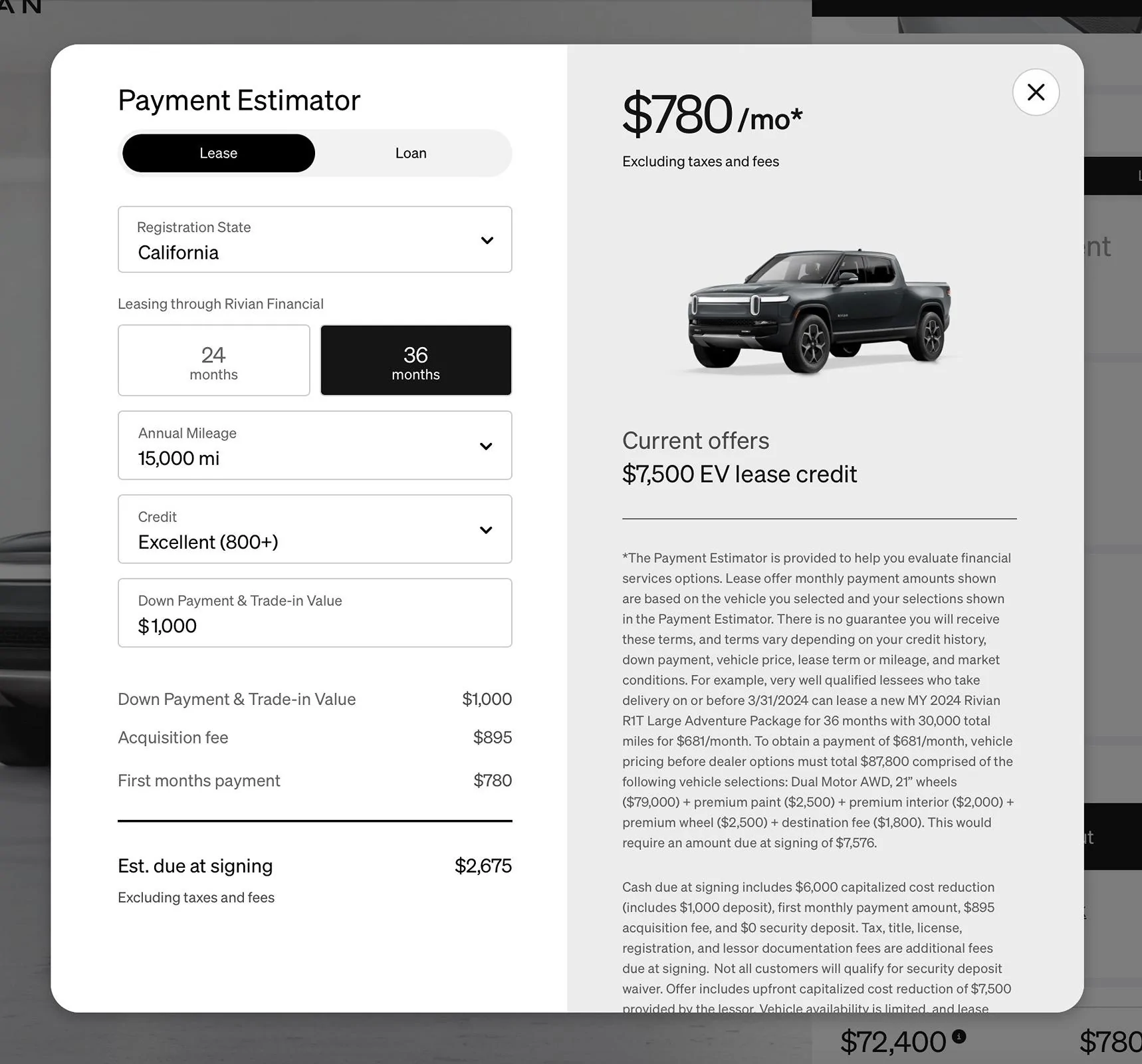

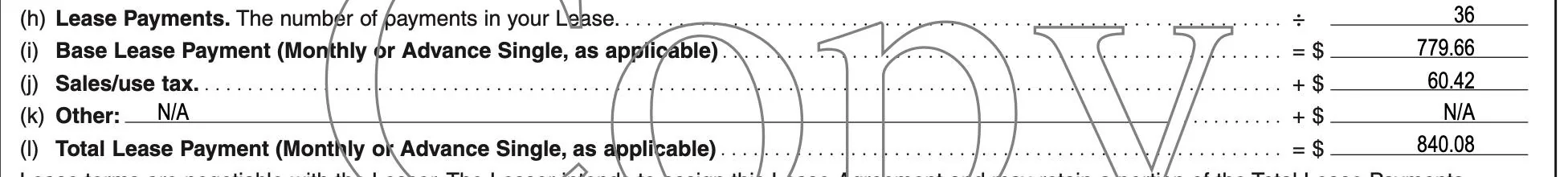

For anyone wondering, the calculator is acutally accurate.
As long as you put the "$1000" as down payment that is required to make a rivian reservation. See attached.
Rivian R1T R1S Lease Details Screenshot 2024-03-15 at 9.21.19 PM
Rivian R1T R1S Lease Details Screenshot 2024-03-20 at 2.23.57 PM
