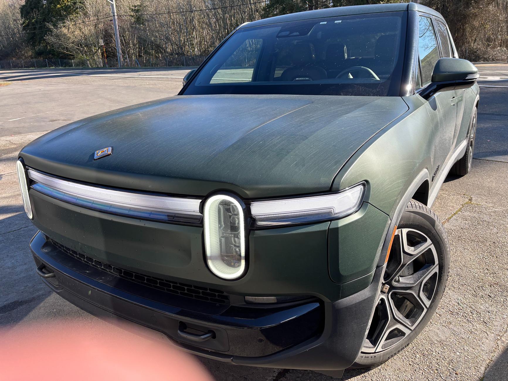

Awesome report and appreciate ya sharing. Gorgeous truck! I am a big fan of stealth PPF. Looks awesome on any of Rivian's exterior colors.
