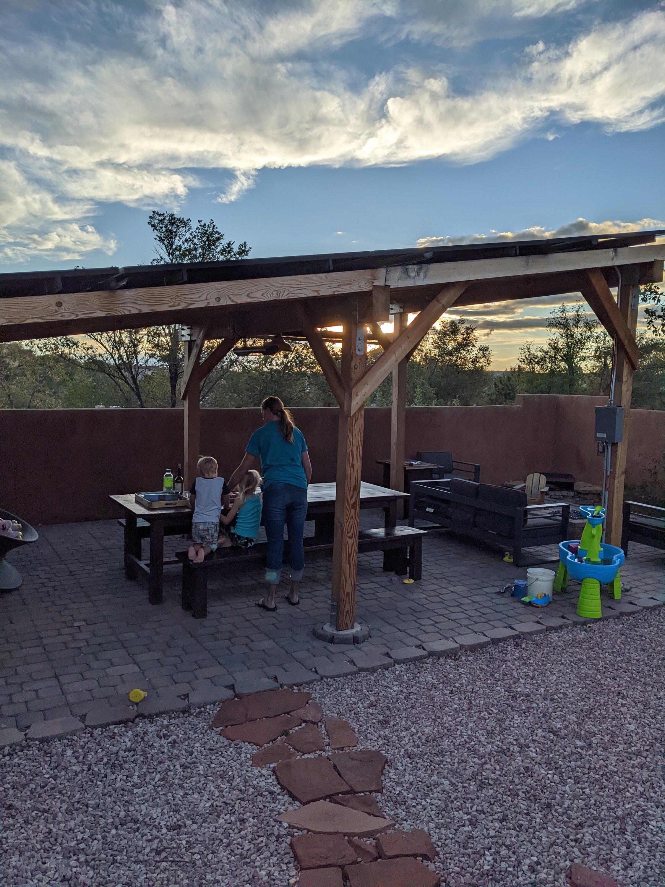

Another nice thing about this is that the wiring and inverters are very easy to access. The 'roof' is the panels.
