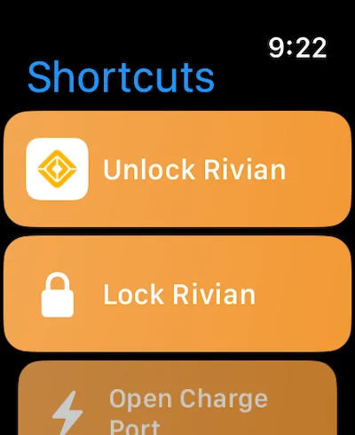

My experience is hit-or miss. Most times the phone works great, but sometimes I have to press and hold the driver's side door handle for about 5 seconds. That usually works. When that fails, I open it with a shortcut on my Apple Watch (hat tip to this video).
Rivian R1T R1S Looking Stupid Waiting for the Unlock !!!!! incoming-7867EA51-88FA-483F-AB1C-A3D6027BA4A9
Still not as robust as my prior Tesla experiences. Hope this gets improved with further software updates.
