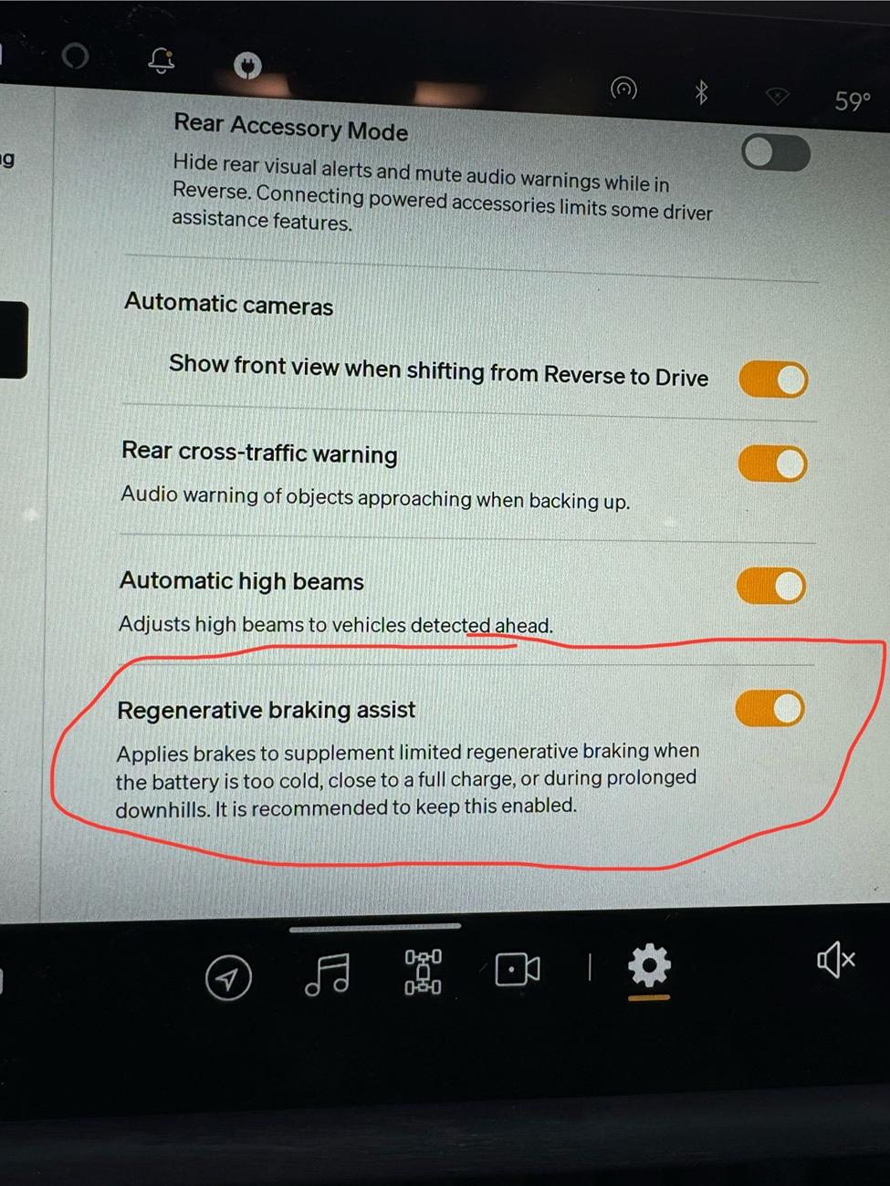

if you use Driver+ it'll use the friction brake to slow the vehicle to maintain its distance to the car in front of you. if you have dynamic brake assist turned on, it will apply the friction brake if the system thinks you might potentially hit the car in front of you. and there's the regenerative brake assist feature that will use the fiction brake if regen is limited.
Where did you get this information? The truck definitely uses regen in all braking conditions and because of brake blending, your brake pedal will always move a little on its own any time brake lights are needed. It then supplements with more friction brake if faster deceleration is necessary. Not being a jerk, I genuinely want to know if my truck is braking differently in various [non emergency] situations.

As others have stated Rivian uses blended braking at low speeds all the time. You will notice this if you watch the brake pedal from the back seat.
If the regenerative braking assist is off (my setting) then it should not blend in brakes when Regen is limited.
My observations of driver plus is that it does use Regen however it uses friction brakes more in some situations because it doesn't slow down far enough ahead of time ...resulting in significant braking force being needed to slow the vehicle.
Something I suspected as the culprit is traction/stability control. Would explain why not everyone is seeing the accelerated wear on the pads.

I would turn off the blended braking function, so you know when the brakes are being applied. At the 7,500 inspection I had limited to no brake use. By the measurements given I should get 110k miles before brakes are needed.
53,500 miles 60% of original pads remain. I'm thinking 90K+ miles for me.

All vehicles of the last 20 years use brakes for traction and stability control. I had a buddy burn through his rear brake pads in 2k miles on his Porsche.

Here is an interesting update. I was out running errands for a couple of hours. When I got home I measure the brake rotor temperature with my IR temp gun. The brake rotors were around 20F, same as the outside air temperature. I was driving manually without Driver+.
