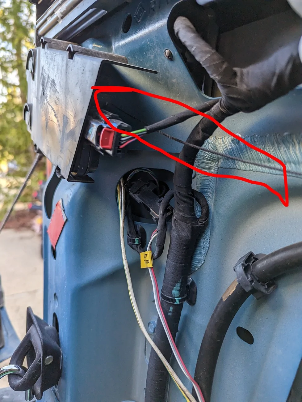

Gen1 latches have manual pull releases, but it's a really long reach from under the truck after pulling underbody panels. Not sure about Gen2 at all.
