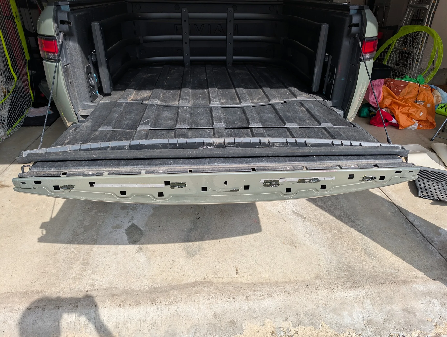

Man I love this truck but it would be real nice to go more than a month or so without something new coming up.
Getting ready to clean out the bed and dropped the tailgate and the plastic trim on top just fell off. Seems some brittle glue underneath just gave up... Add it to the list for my next SC visit in a few weeks...

Were you still on the original piece? Iirc, they redesigned this a few years ago to stay on better.

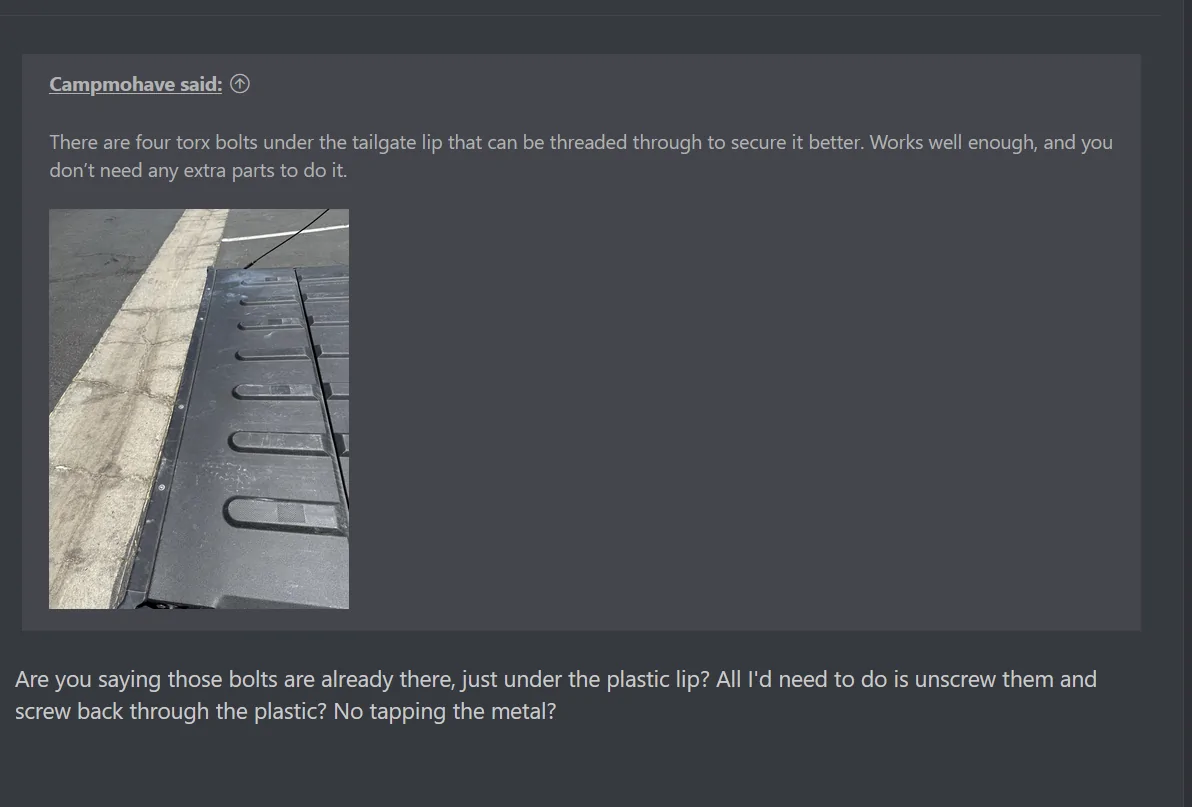

Also if you have problems with it frequently coming loose, you can do this:
No clue. Bought it with 40k miles.

Under warranty- service ticket
Out of warranty - 2 strips of heavy duty 2 sided tape
Comes off again - screws

Yeah the guy who had it before you probably broke it and glued it back on. It's supposed to be held on by clips not glue, but the clips break when you remove the trim.
Yep, still under warranty. Have an appt for the likely HVAC condensate leak and a suspension check ina few weeks

My Rivian isn't my work truck so it hasn't had the trim come loose.........yet. If it does I'll use some of the double sided 3M trim tape like this:
https://pbedirect.com/products/3m™-...term=2329177944990373&utm_content=Ad+group+#1

A lot of people have had this happen, there's a new design for the piece. I chose to just reglue the lock pieces back in, plus use a bunch of VHB tape to re-attach it. Particularly, one strip all along the edge that gets caught and pulled. It's holding nearly a year later and I have used it for hauling several times.

This morning while unloading something I decided to give the cap a yank, after my repair a few months ago. Won't come off. I think the most important part of that is that I put a piece of the thinnest possible VHB tape along the entire edge that is inside the bed when closed, and facing up when open. VHB is super strong, but especially in sheer versus pull.
