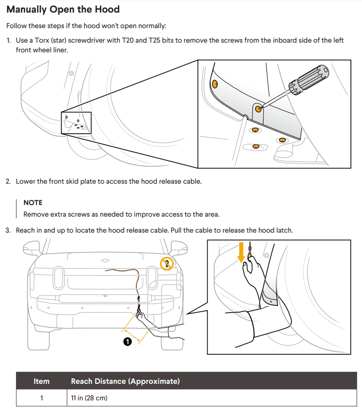

There is another way to open front trunk if battery is dead:
Rivian R1T R1S YET ANOTHER 12V battery fail thread 1712877486292-b5
I am pretty sure this will sound the alarm if someone tries this maliciously, but I don't keeps anything valuable in there because of this anyways.

While I have had no issues with the battery in my four months of ownership. I’ve been monitoring these threads and trying to come up with a back up plan just in case.
At present, I keep a small tool kit in the trailer hitch. A torx 20 and 25. That could get me into the frunk If I could not charge the battery or open the door/frunk from the rear emergency connectors.
I have an inexpensive ratchet set in the frunk So that I could either jump or Replace my single 12 V as described on the Ohmmu website If needed. I haven’t pulled the trigger yet to purchase two of those batteries, they’re expensive, one to keep in the frunk and one in my garage. If the OEM battery fails, I would then swap in in the Ommhu. This battery does not need venting and is sealed and I’ve spoken with the company. It could stay on its side so it would fit under the floor of the lower frunk.
