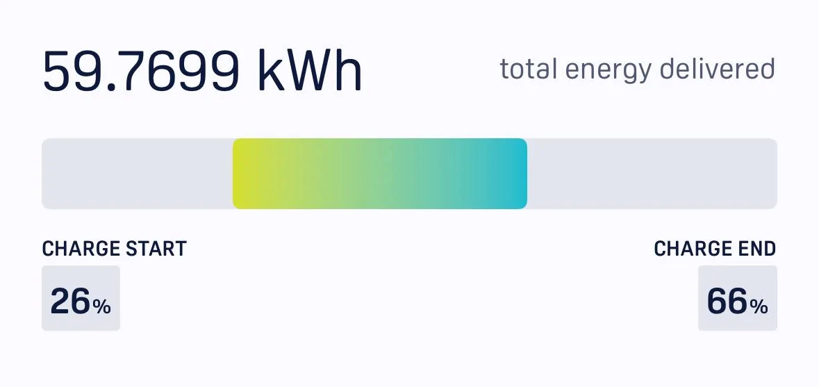

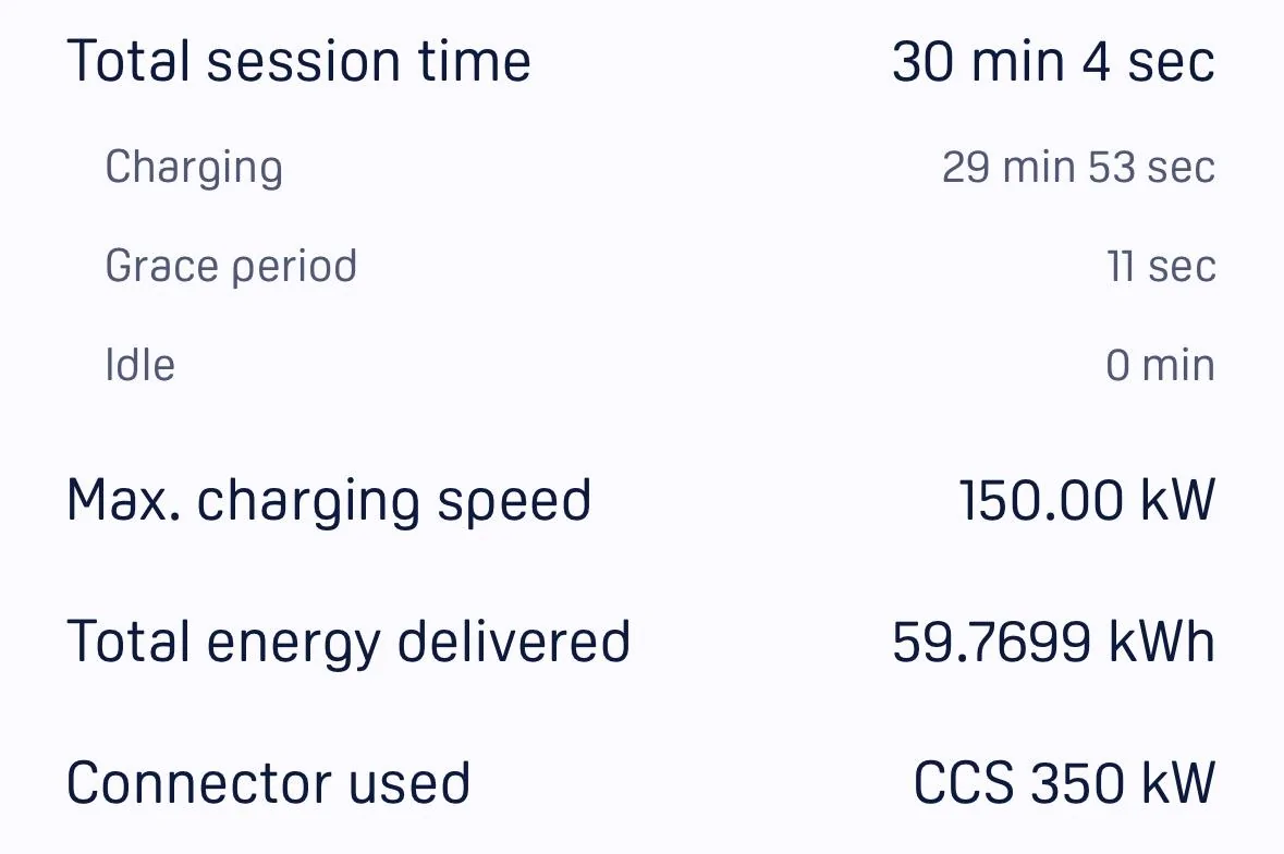

Curious what others are seeing in terms of charging speed. Seems like my max pack is not charging as fast or as consistently as my lightning. Only got 150kw max even starting at 26% SOC even though I set the charger as my destination so I would think it would have precondition the battery if it needed it. Tapered to about 100kw by the time I unplugged it at 66% SOC. FYI this was at an EA 350kw charger.
According to the internet the Max Pack yields 149kWh capacity and has a max charging speed of 220kW. I’m leasing a 2025 Long-Range RWD Model 3 with a battery that’s about 80kWh and has a max charging speed of 250kW. I only ever hit that 250kW speed if I drive my state of charge down below 20%. Most of the time it sits around 150kW and then drops as the battery gets fuller.
My suggestion is to drive the state of charge down as low as you’re comfortable with (I recommend between 10-20%). Then you’ll see faster charging times. I supposed some charging stations could have charging speed issues, but Rivian’s Adventure Network and Tesla’s Superchargers are very reliable.

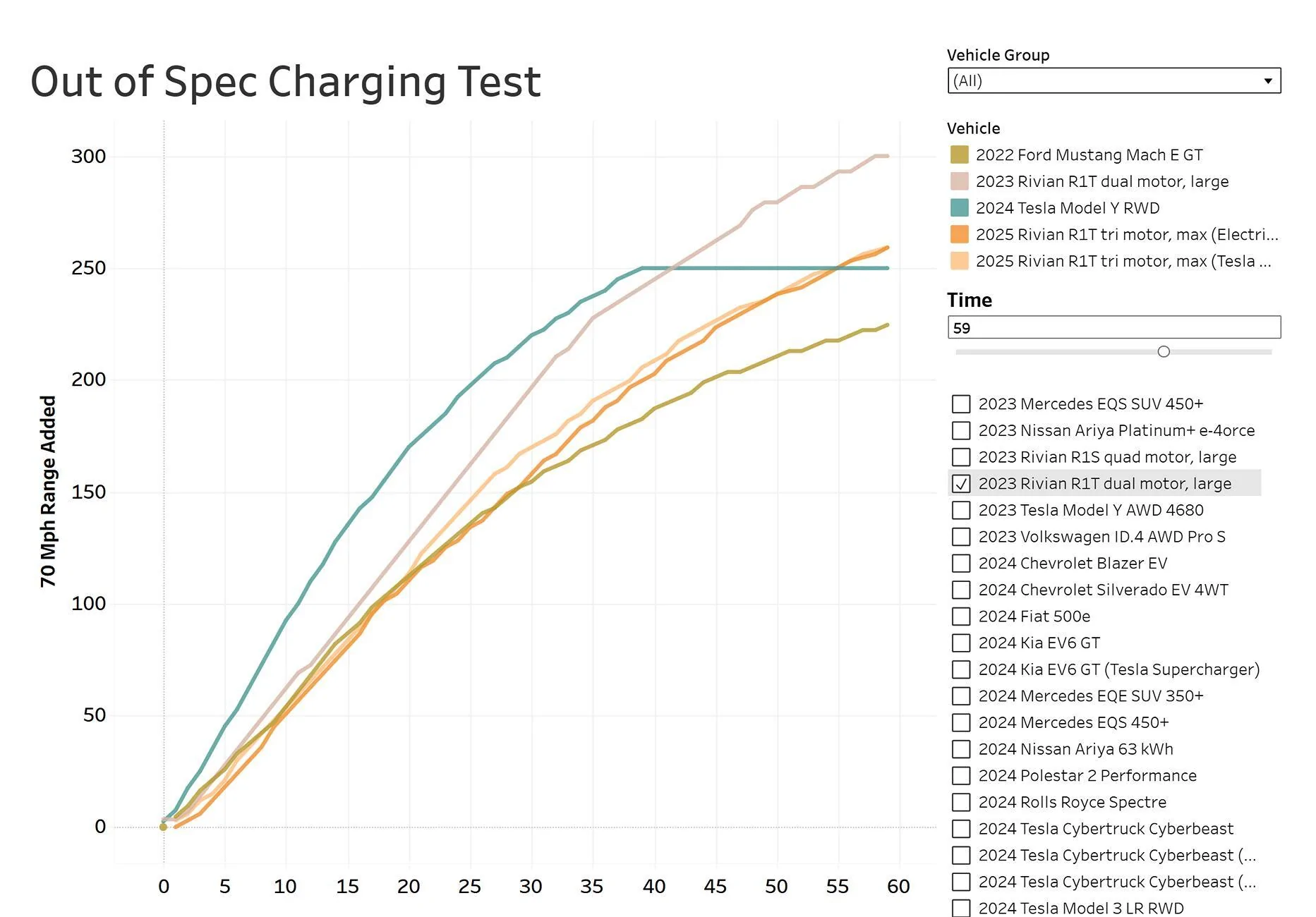

At the end of the day, range added is what really matters, not charging time to 80%. My T charges a crap load faster than my Mach-e did, if to you convert it to miles added per minute. I can charge my T to 80% almost as fast as I could in my Mach-e, and then drive 60% farther.
You're right ultimately we care about miles added per time duration but there are so many versions of the vehicles (performance, dual, quad, tri, wheel/tires) and 10-80% is a direct comparison of just battery performance without looking at configuration etc. OOS chart below shows that in a 40 minute session a Tesla Model Y adds about 50 more miles (250 vs 200) for a max pack. Even comparing a Rivian large pack to a max pack it's also close to 50 miles more miles in a 40 minute session. I'm hoping the Max at least performs as well as a large with the update. In most cases a larger battery should be able to add more miles than a smaller sized battery.
