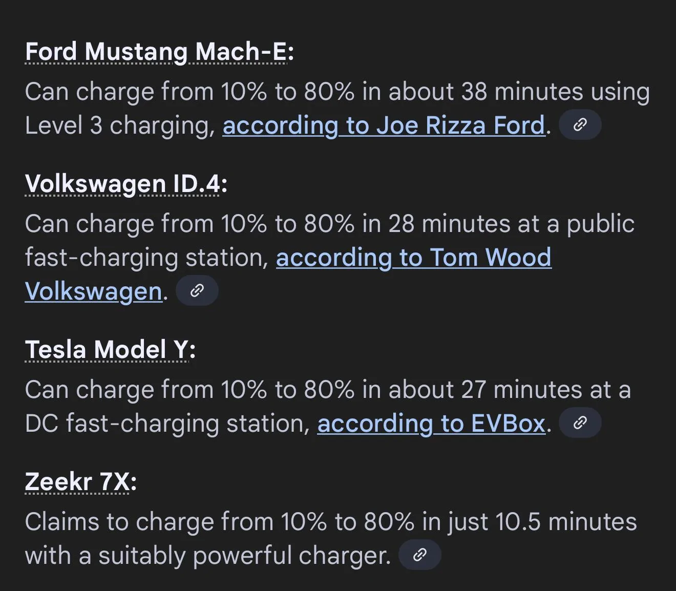

Interesting video comparing Tesla supercharger to EA. Looks like about 45 minutes roughly for 10-80%. Hoping the software update can cut 10 minutes off the 10-80% down to 35 minutes. 45 minutes is slower than the cars listed below according to Google AI.
Looks like they got within three minutes of what I was hoping for. Roughly seven minute improvement for 10-80% is not bad. Still not understanding why smaller packs have faster 10-80 though.

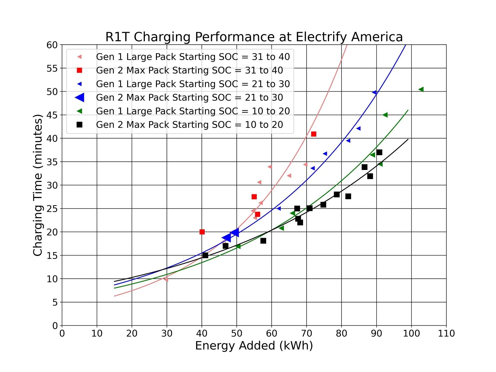

Here is my experience at EA stations for adding a certain amount of energy for a given amount of charging time. I've had both a Gen 1 and now a Gen 2 Max Pack. I'll update this chart with the latest software update just rolling out. The different lines on the chart are for different levels of state of charge at the start of the charging session.
Summary: Gen 1 and Gen 2 Max pack have very similar charging performance over many sessions in real world circumstancees.
IMO: energy adder for x amount of time is a worthy metric. 10% to 80% or similar metric is almost useless across different vehicle models with different batteries.
