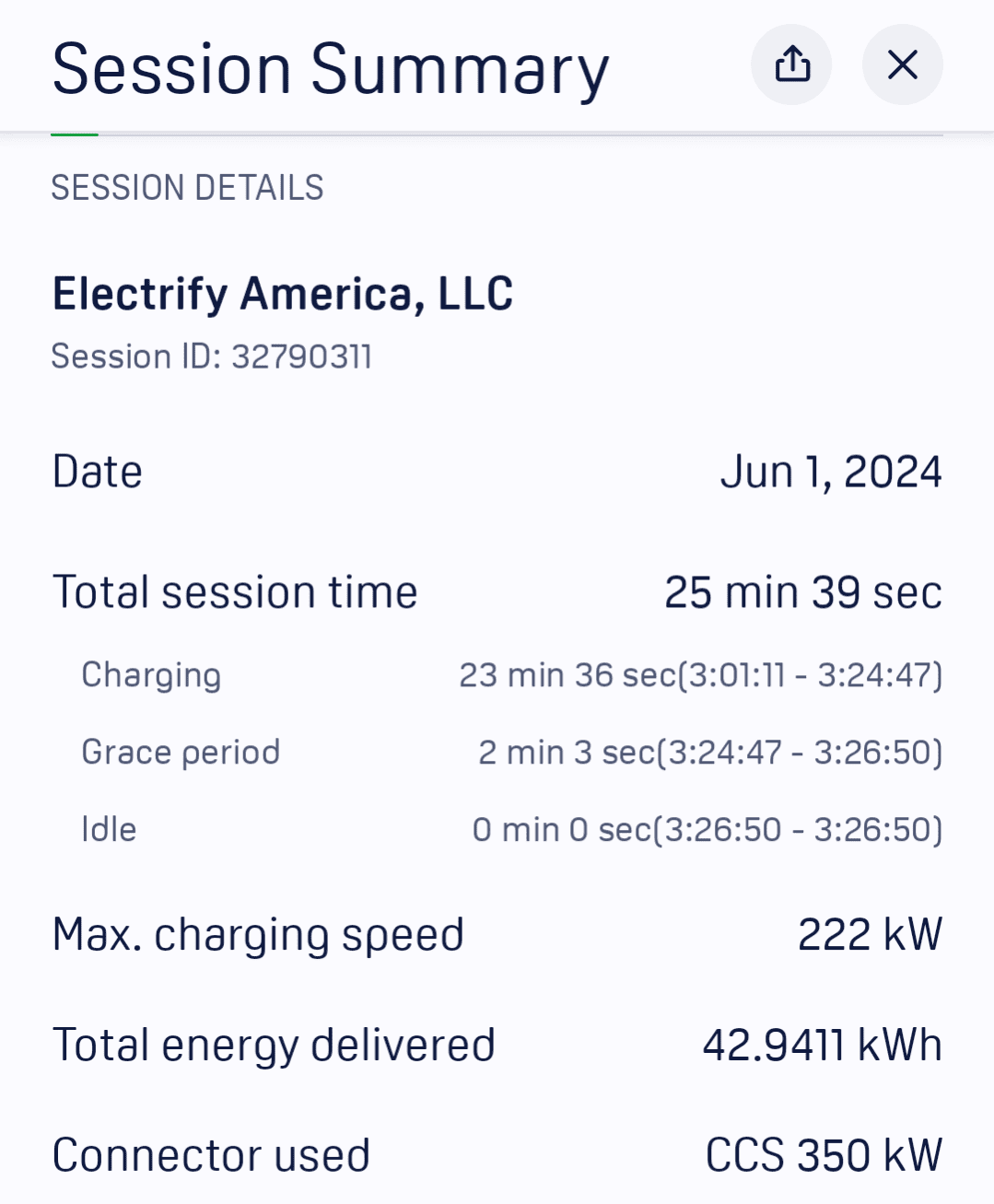

I hit 222kW recently, I was both surprised and concerned when I saw that. It quickly tapered down though.

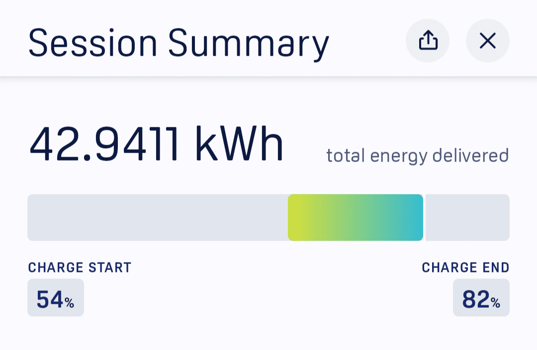

I plugged in at 52% and got 222kW...

I started at 26% and 31% for the two occasions referenced in this thread.

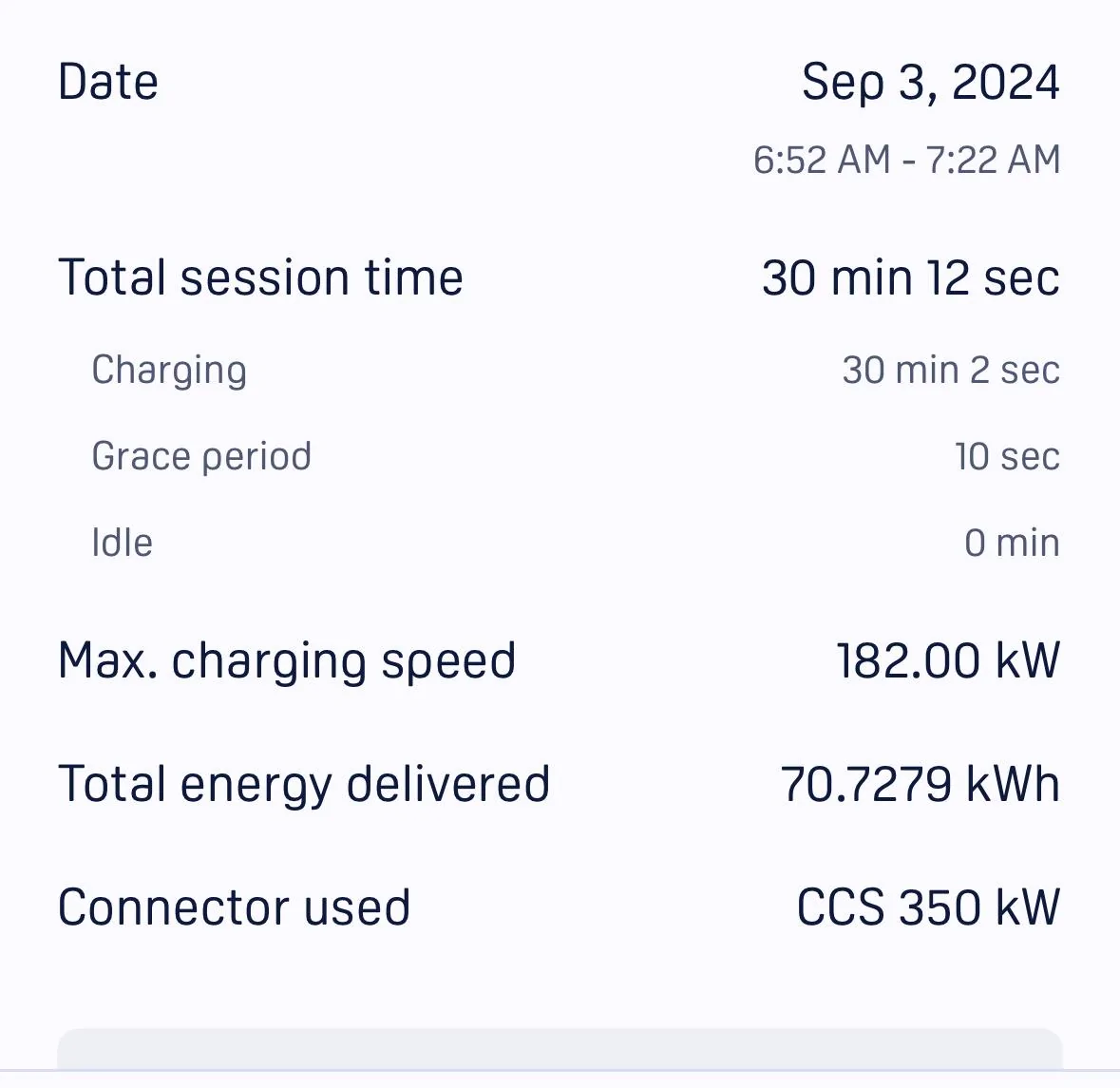

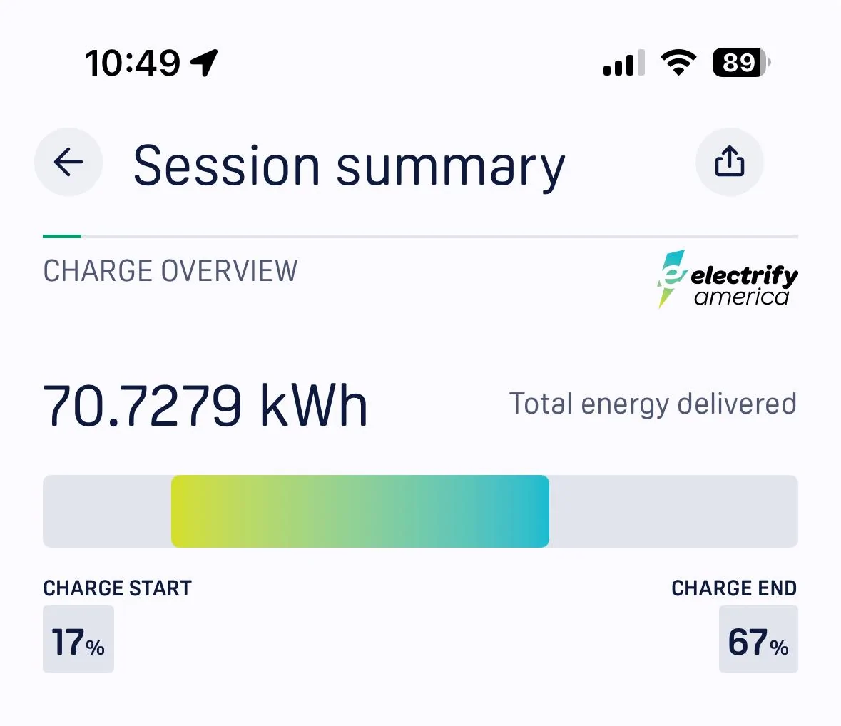

Just wanted to provide an update on my experience max pack charging speeds. It still has not improved. It’s a bit frustrating that Rivian still has not improved the charging considering max pack has been out for a while now. It’s disappointing to pay more money for the max pack and yet it performs worse than lower cost large pack. I really hope rivian puts more priority on improving the charge speeds of the max pack. With its current state, it’s terrible road tripper if you have to fast charge. Photos attached to show I only hit 180kw even with battery preconditioning and starting from 17% SoC. When my truck was in the shop for a month I was able to drive a loaner large pack and it consistently performed better than my max pack at the same chargers.
