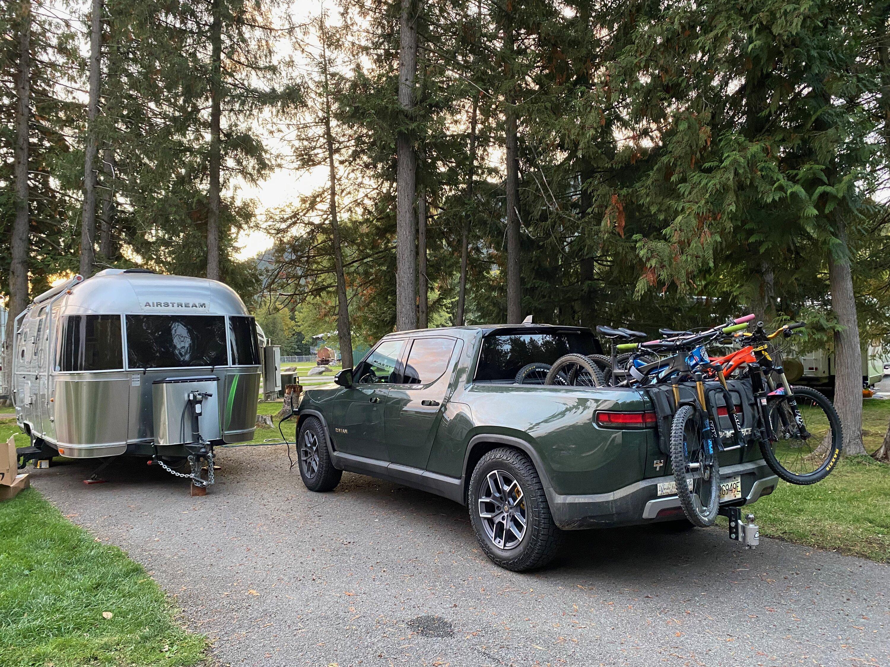

I've put my thoughts in a blog post previously (scroll to the bottom) - since I wrote it, the difference in pack size has become smaller until it was actually confirmed by Rivian themselves a few days ago to be only 10kWh (as referenced further up thread). The remaining interesting bit is the speculation around the silicon-carbide inverter in the rear as well on the Max pack, but for my situation it still wouldn't have changed it materially, as towing is my primary range constraint. I do wish they had managed the original 180 kWh pack!
I have only towed my 2015 Airstream 20FB Flying Cloud twice, both back in September '23:
Both trips worked out to exactly 2.04 km/kWh (1.28 miles/kWh) and each was around 550km round trip. Both had some fairly large mountain passes - total elevation round trip gain/loss about 3500m on trip 1 and 3000m on trip 2 (9900 - 11550ft).
First trip was warmer at around 20C during driving conditions, but a wicked headwind for about half-way home of 30-40km/h; driving speed 100km/h (speed limit) for the most part, with some sections at 90km/h, dry roads. Longest leg was pretty short actually, only about 160km - didn't track exact energy usage.
Second trip was cooler at around 10C; driving speed had more 90 sections, but still a fair amount at 100. Longest leg was 244km, using 106 kWh at 2.29 km/kWh - however, it had some slower legs and a net elevation loss of 400m. Least efficient leg was 138km, using 72.5 kWh at 1.91 km/kWh - no net change in elevation, but 1100m mountain pass - light headwind.
Both trips we had 4 bikes in the box hanging over the tailgate.
I expected lower efficiency based on blog posts I had seen here, but I think people drive faster in the US on the boring interstates. (I guess we did too the one time we drove to Ontario in our Model 3 - 120-135km/h most of the trip!) I don't really expect to tow much faster than that though.
I've got a few ideas on how to make my Airstream more "streamy" - we'll see if I get time to do those this year or not. We have a few road trips planned this year which I'll document well to continue gathering data before we do a big trip to Utah/Nevada next spring break and into April - really looking forward to that one! (We were originally planning this spring, but decided to wait for SuperCharger access and a few more chargers to be built to provide more access to areas we want to visit over the 4-5 weeks.)
