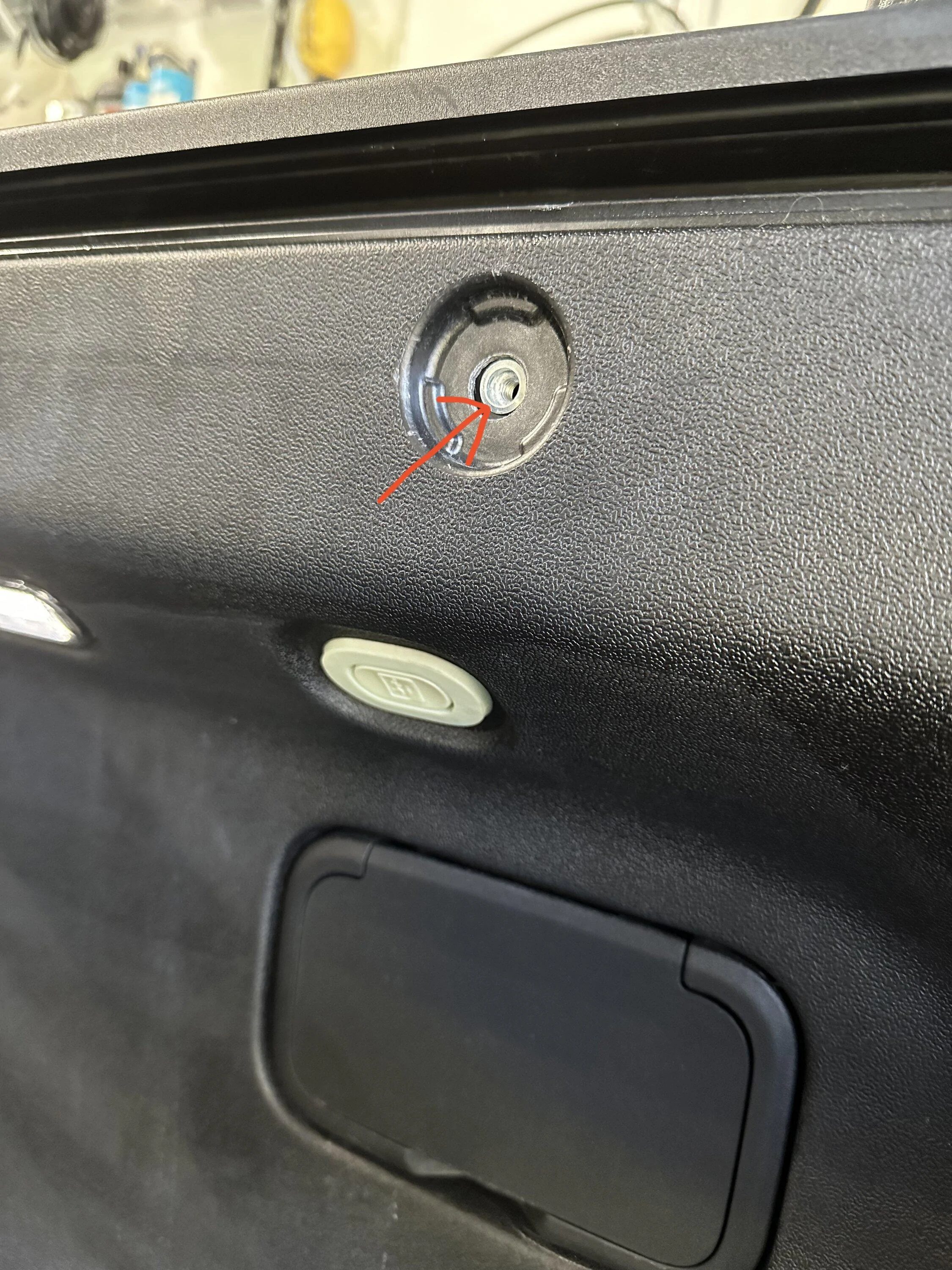

Hi guys,

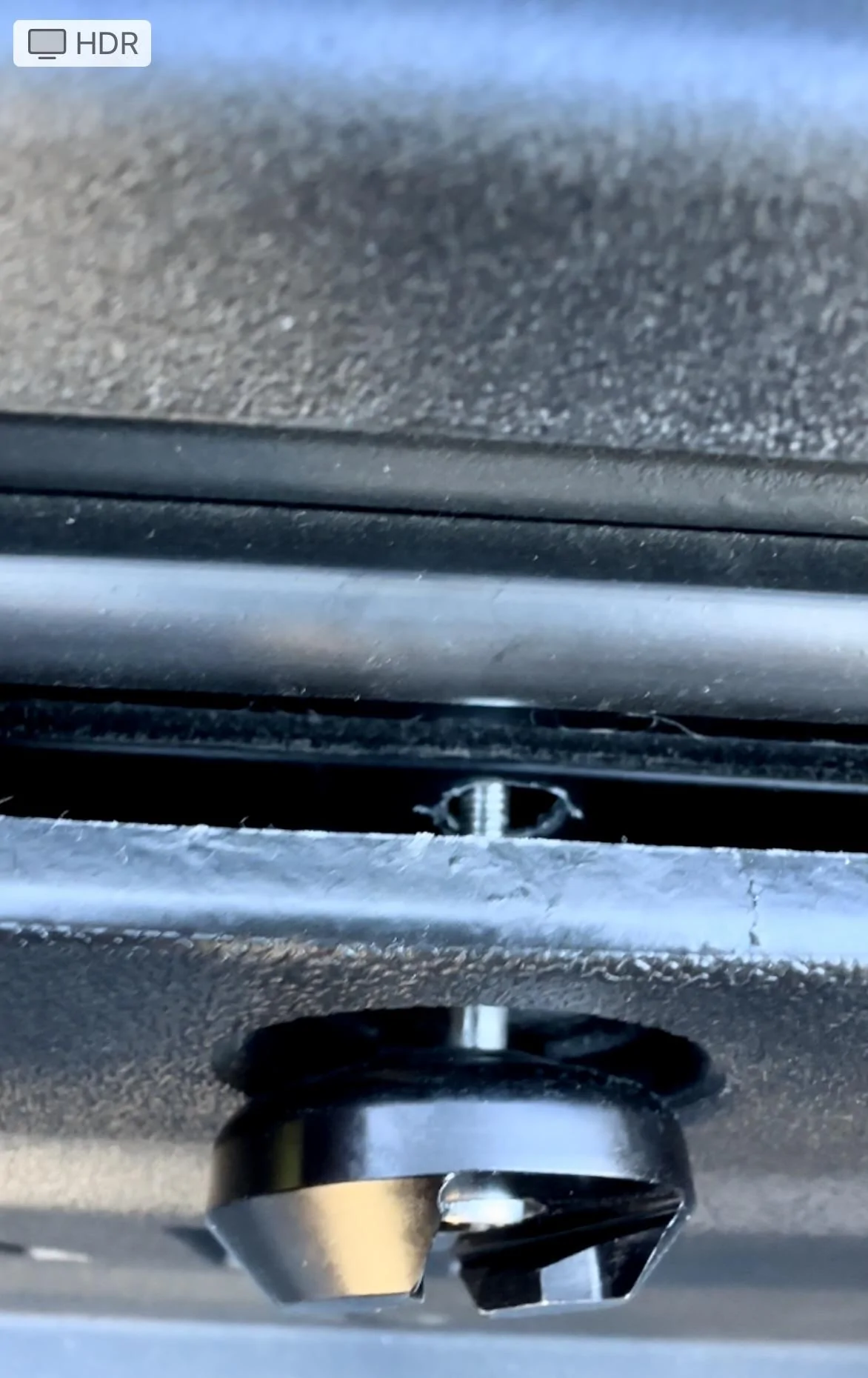

So, I literally received my truck the other day, and I had already purchased the @EV Sportline EV1 tie-down ring kit. I started installing it, and two of the bolts kind of stopped halfway in and got stuck there (in the picture and video). I applied a little more pressure, and the entire screw receiver (red arrow in the pic) came out of the bed :oops:.

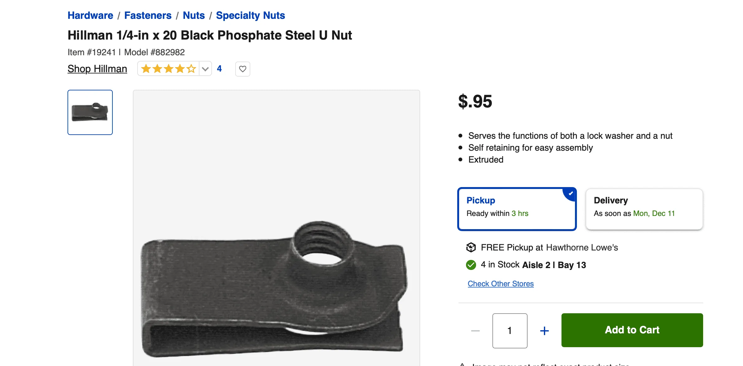

I think I got a bad batch of screws from EV1, but I will reach out to them. I need to fix the screw receivers in the bed. One of the options I found is from Lowe's (3rd pic). Has that happened to anyone, or maybe you can guide me on where I can buy those screw receivers? I am not sure if it's even called that way.

Depends on how much work you want to do. If you drill them out you could buy a Nutsert kit from amazon and just replace them.

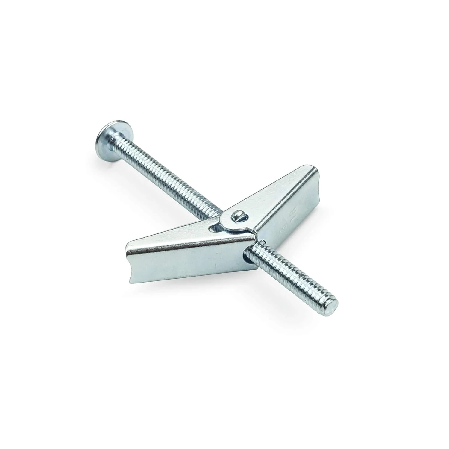

I fixed it for now with those wing toggle bolts temporary.
