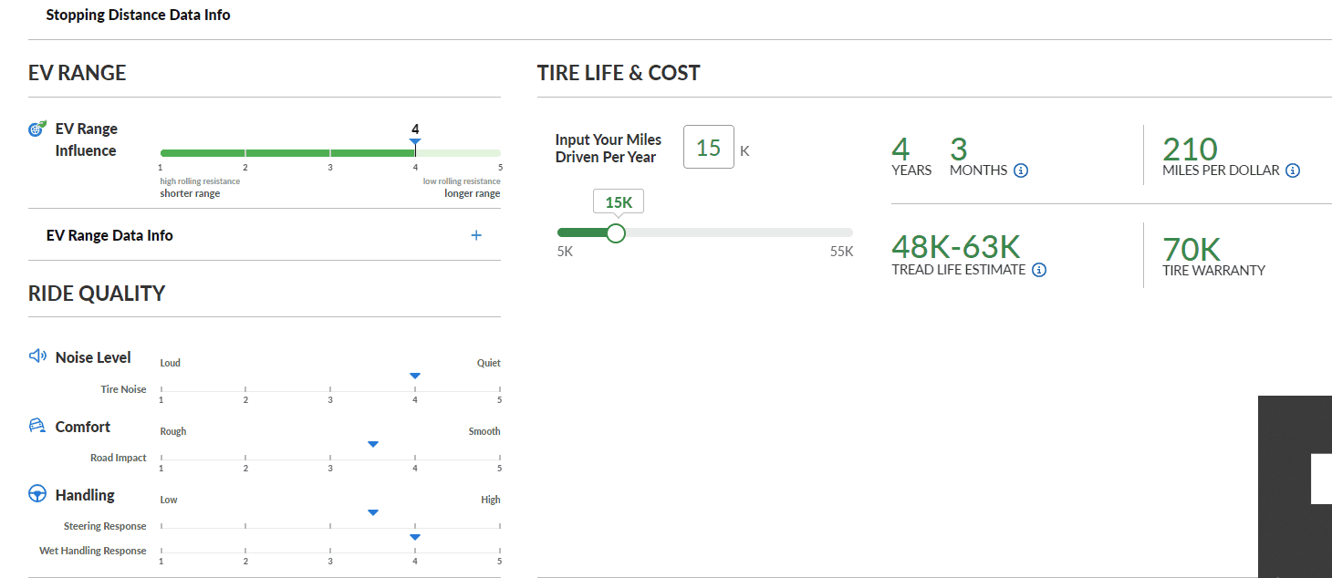

I'm in Colorado on the Discount Tire site and do not see the details link you mention - to see ev range influence
Same for me for the linked tire. I even went through their Treadwell wizard. I can, however, see it for a very small number of OEM size tires.

I know this has been asked a hundred times, but here goes: do we know which is "the most efficient 20" tire"? The more I read about this, the more confused I get.
I am not interested in cost -- just the tire that will produce the longest range. The Grabber and Recon Grappler seem great, but are they more efficient than the Defender LTX? Or the Pirelli Scorpion A/S?
