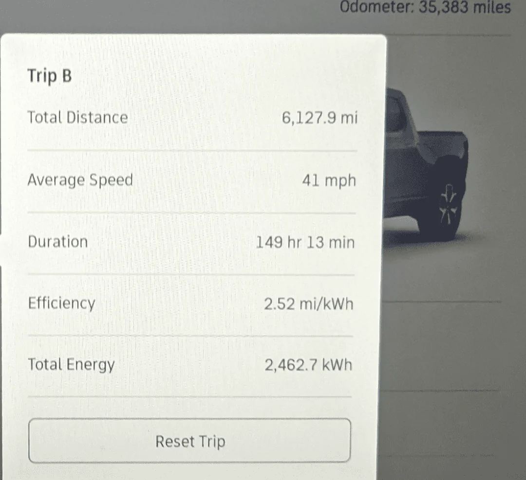

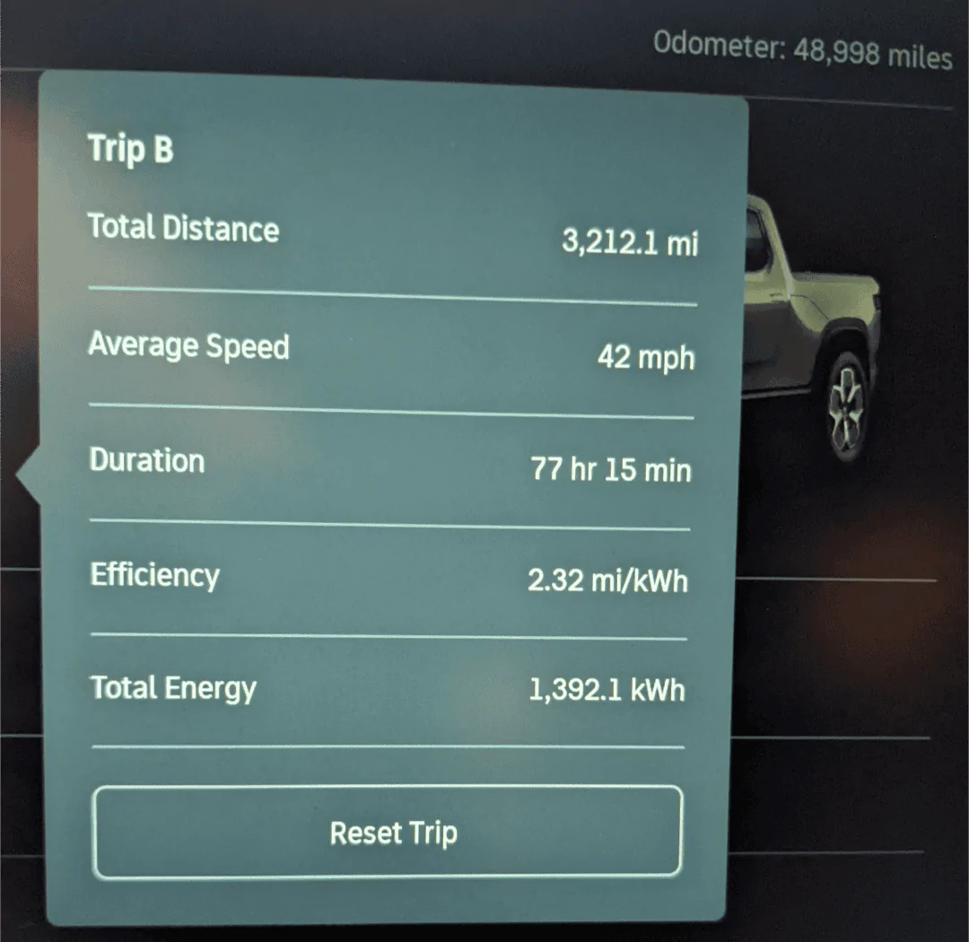

2.44 MPK (including 3% correction) last summer on OEM 20" staples. 2.32 MPK most recently, including a road trip with RTT then towing a utility trailer 200 miles.
Rivian R1T R1S Most efficient 20" tire? 1000011556
Rivian R1T R1S Most efficient 20" tire? 1000011557
