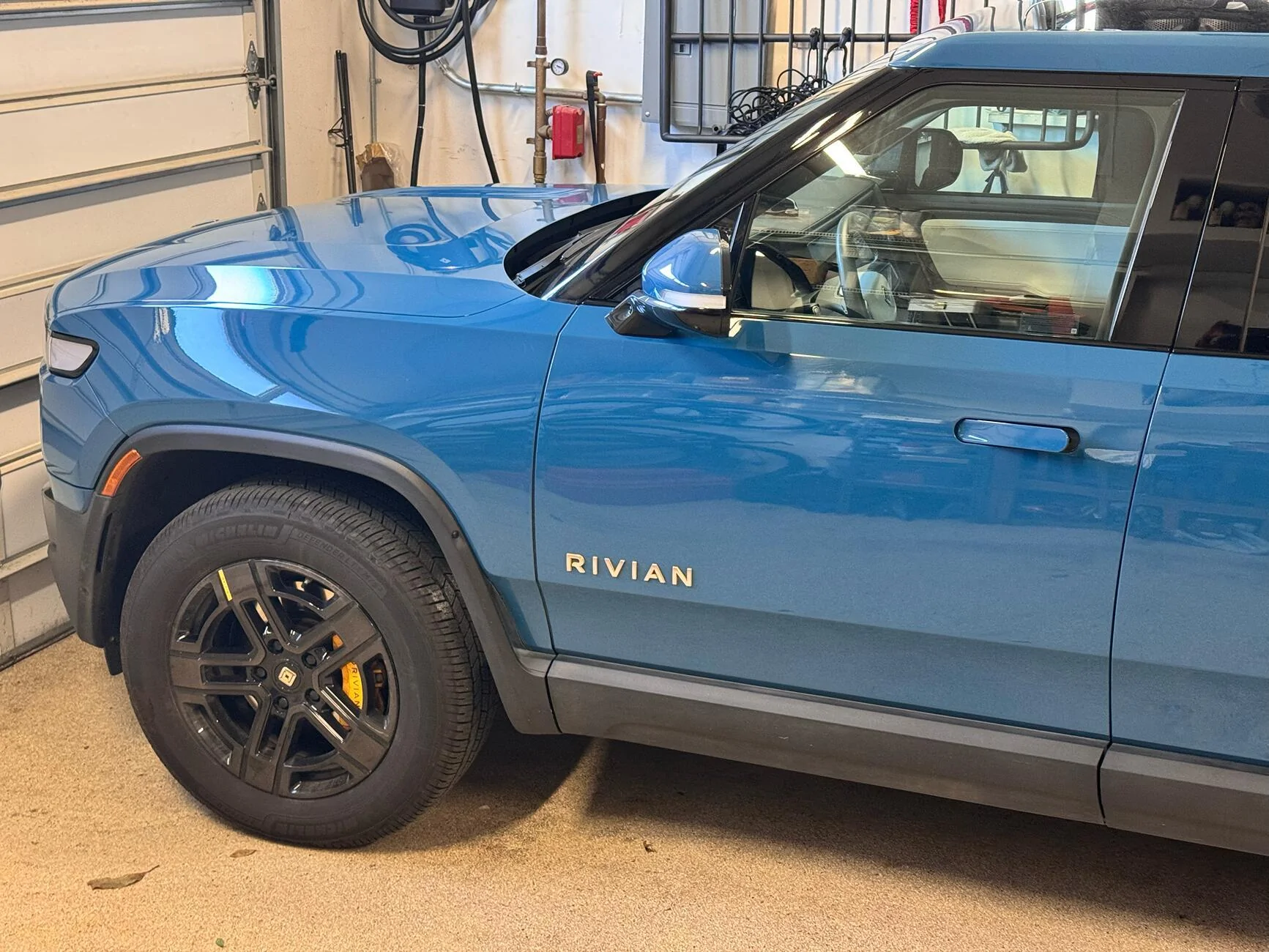

^ Do you have pics of what your truck looks like with the 275/60 tires on AT wheels? More of a wider view, not a pic of just the wheels.
Not the greatest shot, will take another when it's outside later. Height is set at Standard (not auto) so you get a sense of how it fills the wheel well:

That's not bad, not as good as an all terrain but not horrible. It does look better in this size vs a 34" tire though.

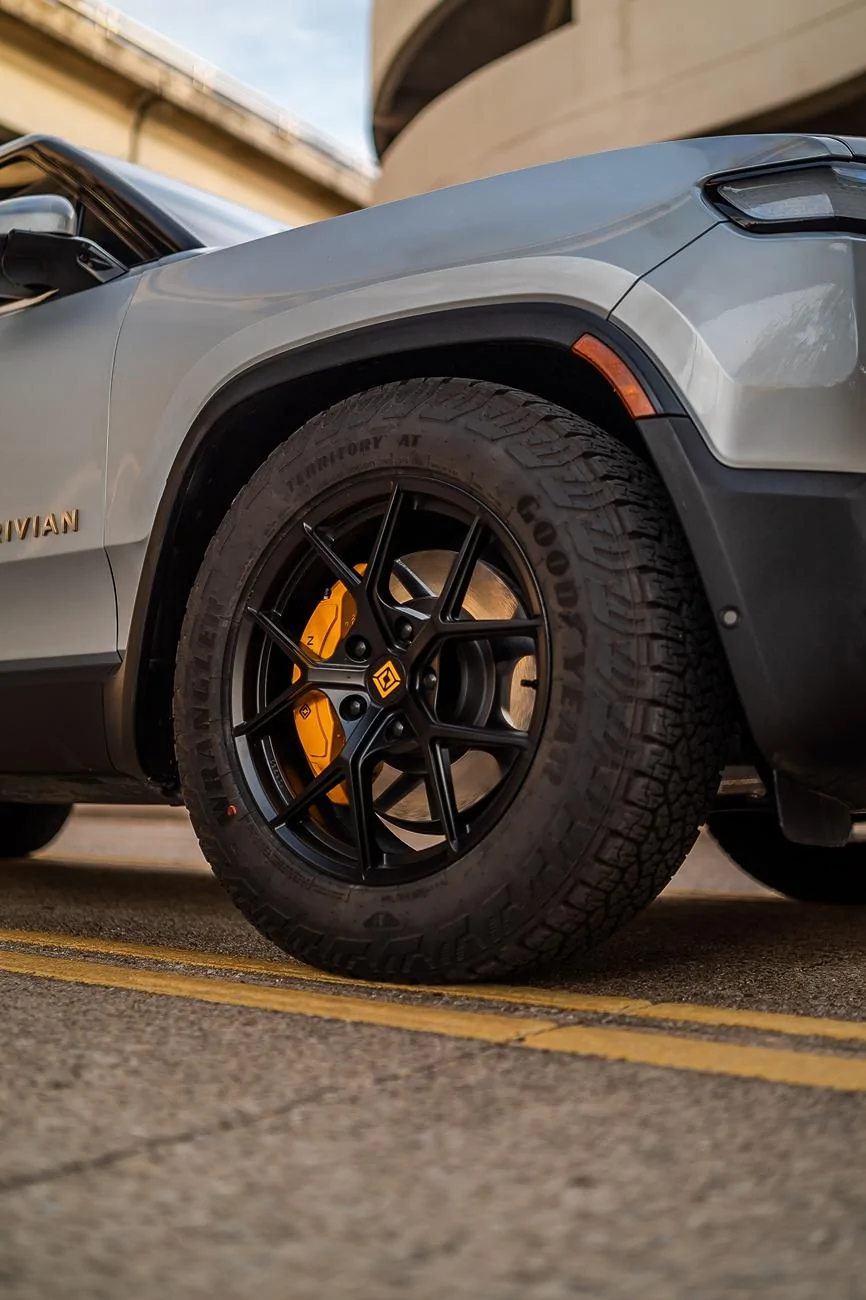

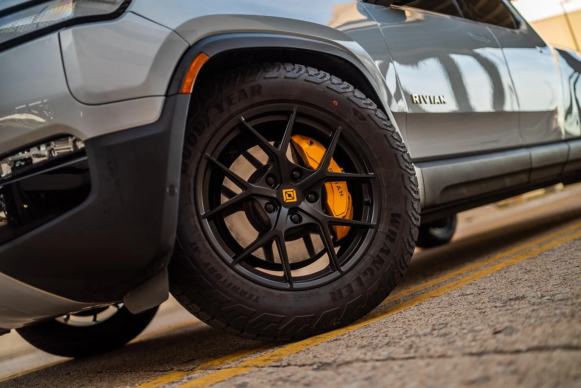

Here is an alternative. Goodyear Territory AT's on Atomic Wheels AW01 rims. Less minivan, more truck. Great combination of efficiency and curb appeal. This combo also saved a lot of weight over my factory 21's and even more over the factory 20 AT's.

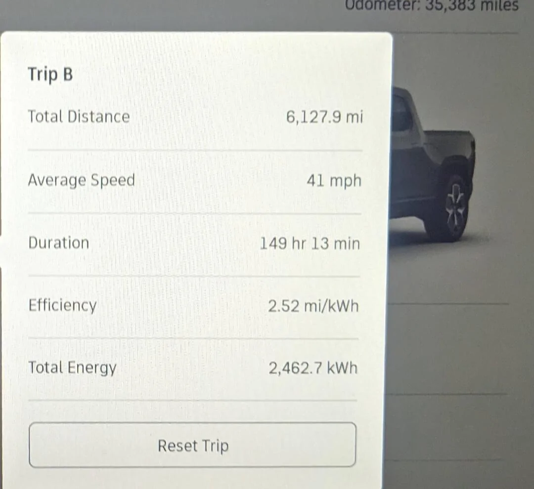

I've posted a lot of my data in one of those threads and another I started when I bought the Goodyear Territory ATs. The problem for most is apples to apples comparison. I live in Texas and traffic is definitely going faster than most states so my mpk will be lower due to the higher speeds.
I put on my tires just as winter hit here so most of my running until recently has been in the cold. About 75% of my driving with them has been below freezing. I am currently at 2.24 mpk on my G1 quad. When I filter out the cold, I am at 2.52 currently. That does include a lot of rain and a lot of my drives are very short.
Amazing pictures! Thank you for sharing!
Do the Rivian emblems fit with the AW wheels easily or did you have to do some modifications or use some alternative?
Alternative option.
