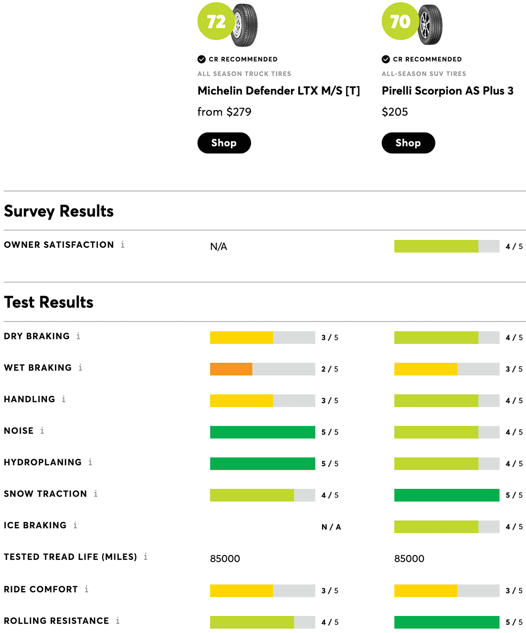

Given the challenges/barriers to achieving a true objective comparison of efficiency, I examined Consumer Reports' metrics, especially pertaining to rolling resistance, and they (through a contractor) objectively measure rolling resistance on a dyno as follows:
"Tire rolling resistance is a measure of the rolling drag force of a free rolling tire, which is a factor in vehicle fuel economy. Testing is done by a contractor on a dynamometer, measuring rolling resistance through force, power, or torgue methods following the guidelines of SAE J1269 procedure and SAE J1270 information report. SAE is an industry body in the transportation field. This is a steady state test acquiring rolling resistance from a test matrix of four load and inflation pressure combinations at 50 mph. Tire rolling resistance can then be described in a linear regression as a function of load and pressure. Data can be reported as a calculated value to a specific load and pressure called the standard reference condition as outlined in SAE J1269."
They also appear to have a very robust way to test expected treadwear.
For what it's worth, in comparing Michelin Defender LTX M/S (they haven't yet reviewed M/S2) and Pirelli Scorpion AS Plus, I note that the Pirelli gets highest rating on Snow traction, rolling resistance, and braking (which, along with tread life, are my top priorities). Not sure why the Michelin gets the overall higher rating when Pirelli scores higher on most metrics. Couple of caveats: They place these tires in different categories (AS Truck, AS SUV), and I'm not sure if there's a different curve based on category. Also, the actual tires tested were different sizes; I presume they make corrections for size in considering rolling resistance. Hopefully they review M/S2 before I have to buy new tires in a couple of months.
For anyone who's interested in how these compare on objective rather than anecdotal testing (again with the above caveats):
Rivian R1T R1S Most efficient 20" tire? 1721055539854-ge
I'm planning to purchase one of these options (except M/S2 not M/S) in 275/60/R20 to mount on my new (pre-ordered) Atomic AWZZ, which will replace my stock 21" wheels.
Let me know if anyone wants other comparisons from CR.
