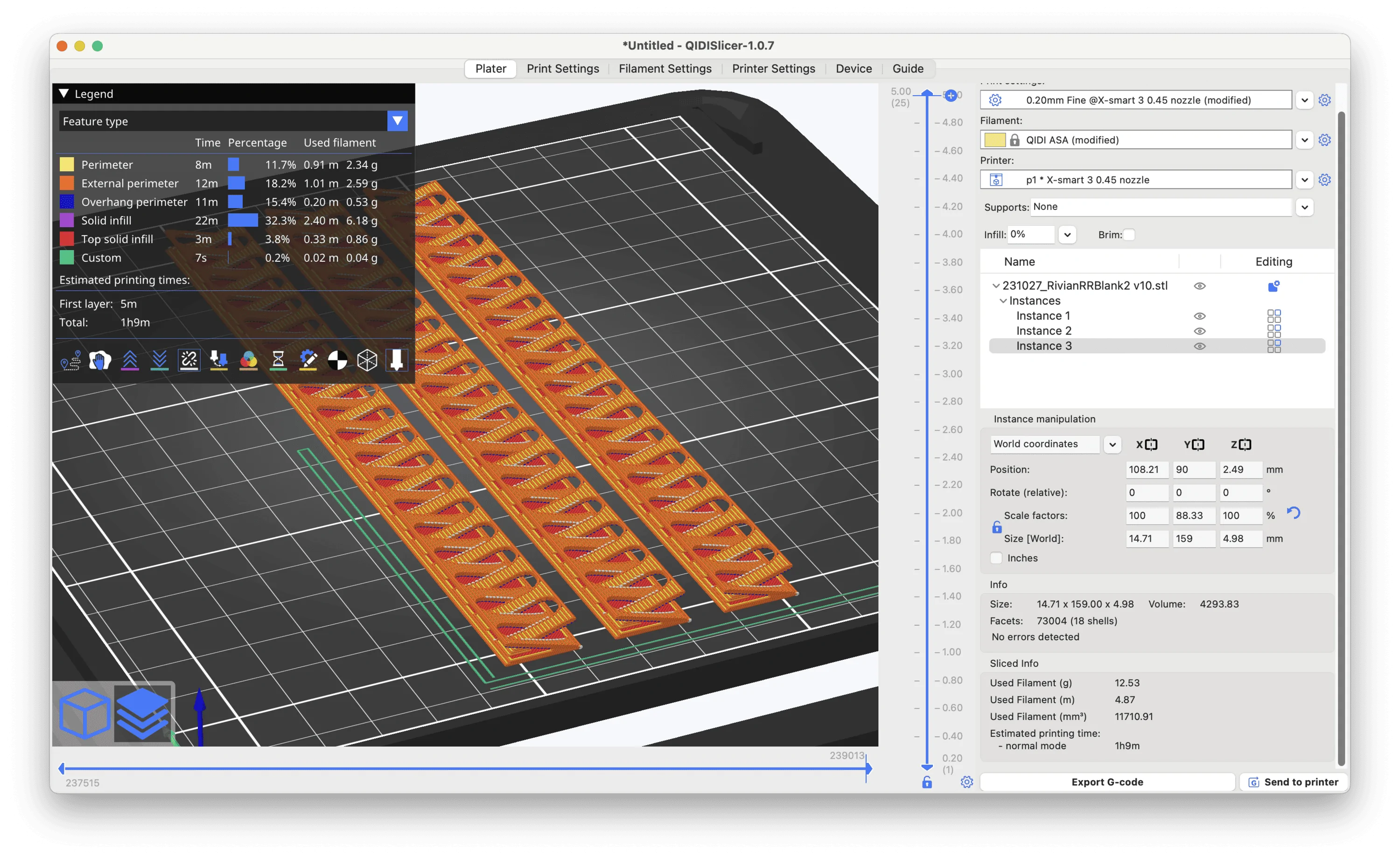

I made this plastic inserts a while ago, figured I might share it as well.
Link to files: https://www.printables.com/model/791507-rivian-crossbar-inserts-set-of-180mm-270mm-540mm-l
Printed in 3 peaces from ASA, PETG should work too but I think ASA is better for UV resistance.
I think you could also print this in color to match paint of the truck.
The set for a pair of crossbars would cost about $1.50 in filament, and 4.5 hours on modern printers.
In slicer it can be cut or shrink/extended to fit your specific application, in picture below I scaled it to fit with my crossbar mounted KC lights.

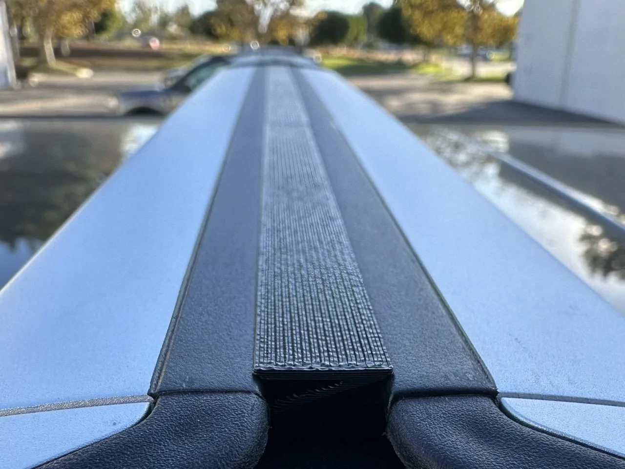

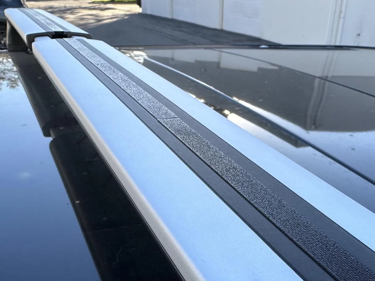

This is picture from test pieces I made (PLA), it actually removed the whistling noise. Tested on highway.
Rivian R1T R1S My solution for crossbar wind noise (requires 3D printer) IMG_7996 Larg
Rivian R1T R1S My solution for crossbar wind noise (requires 3D printer) IMG_7997 Larg
